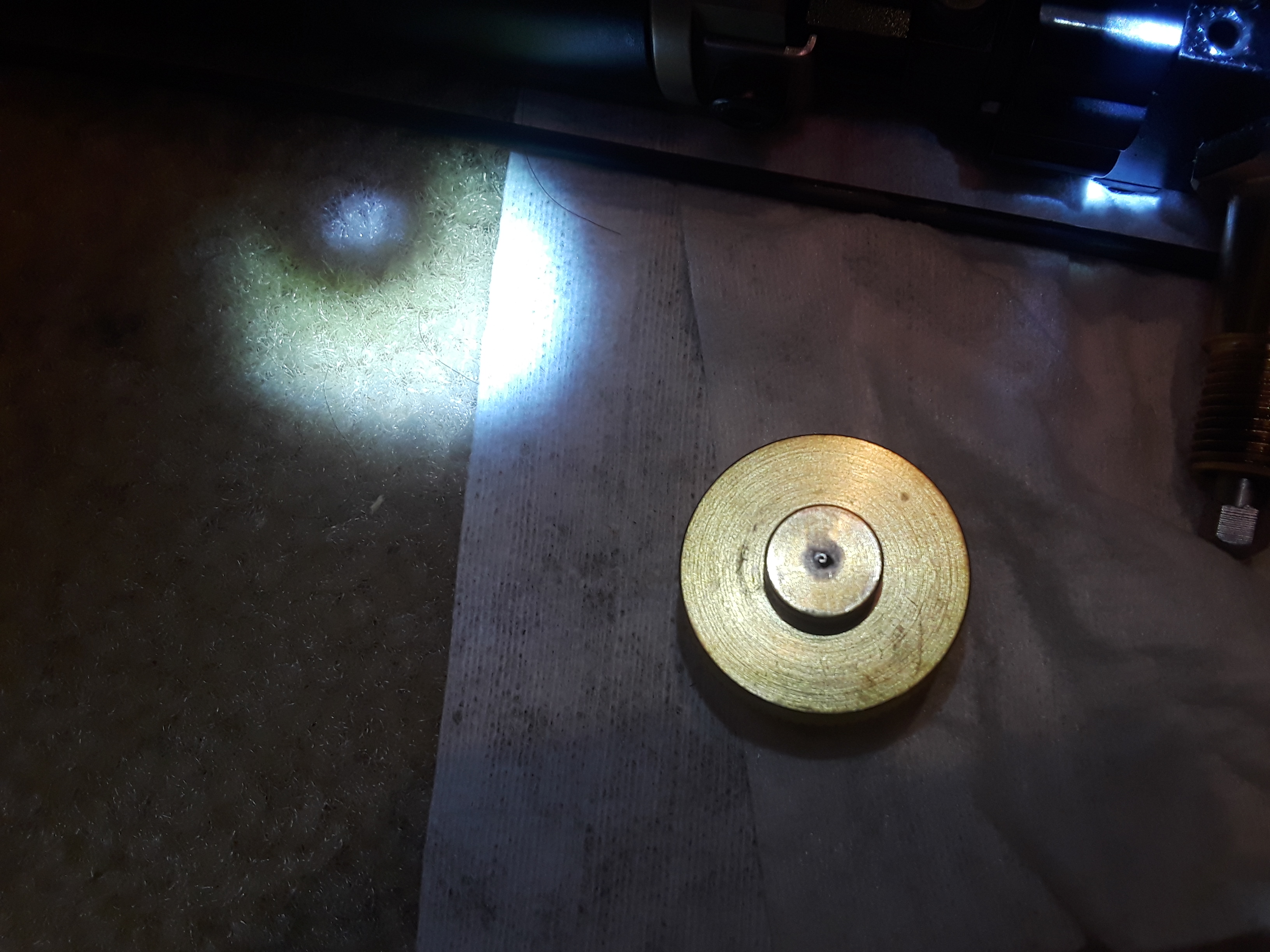

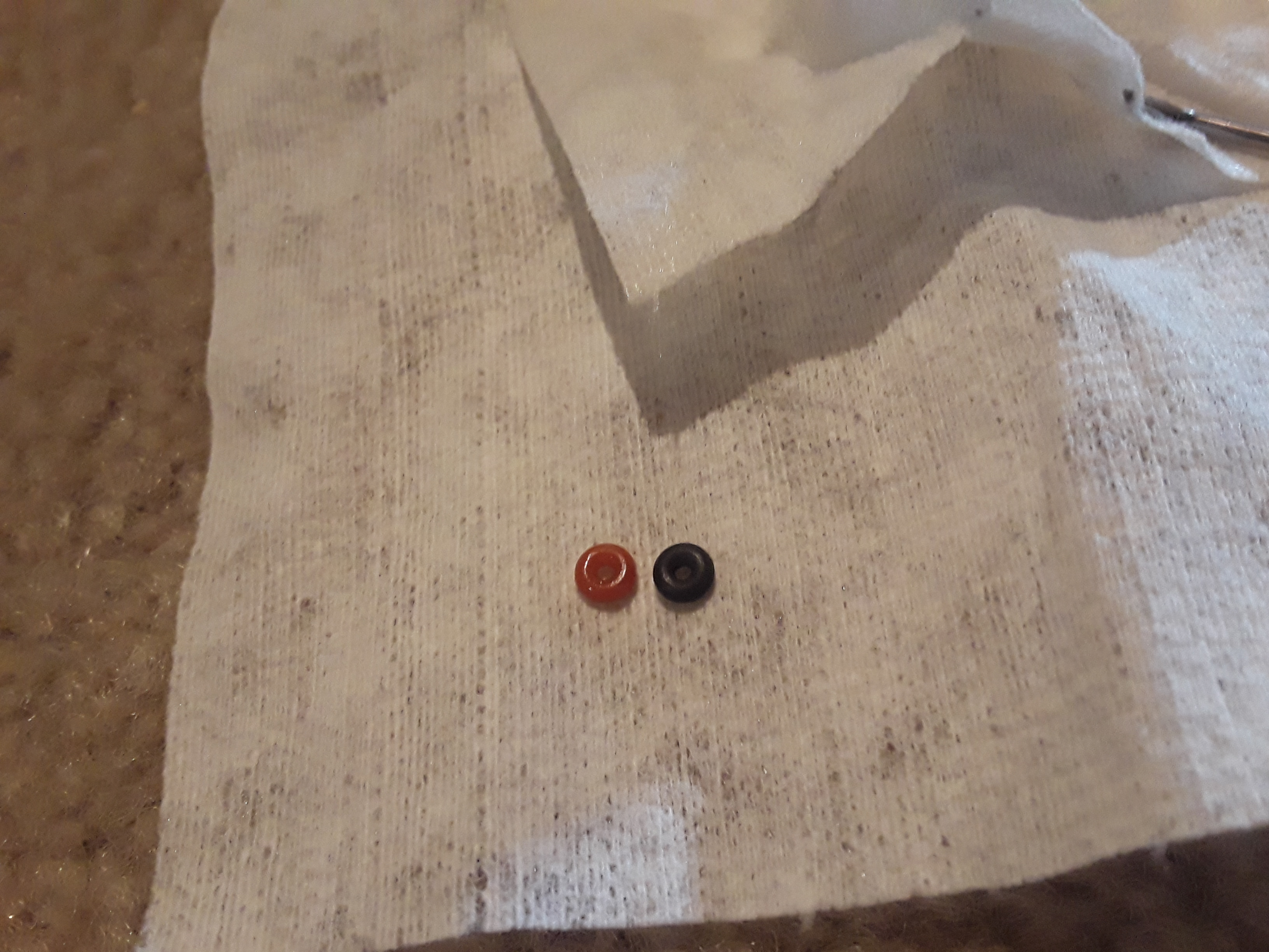

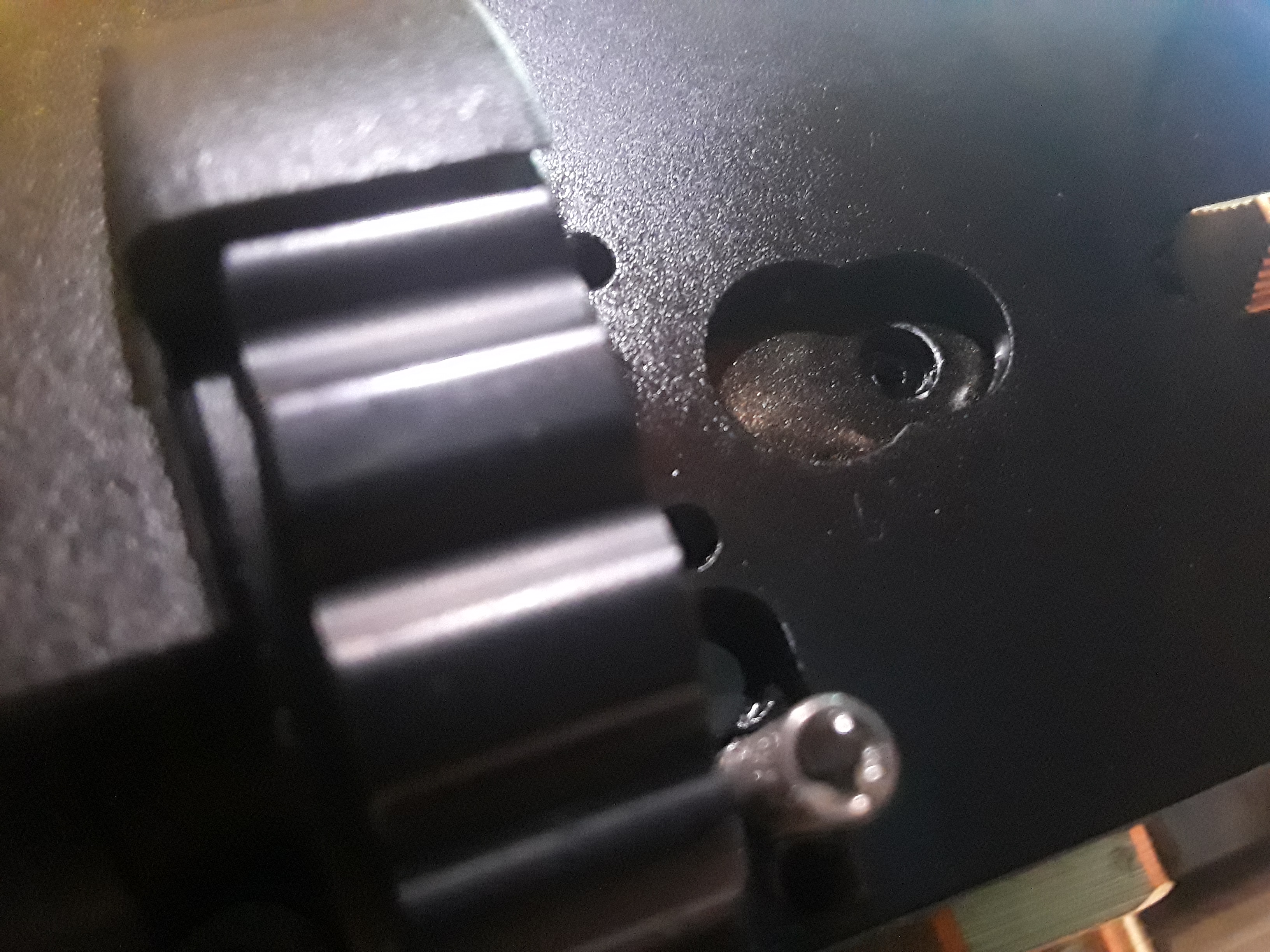

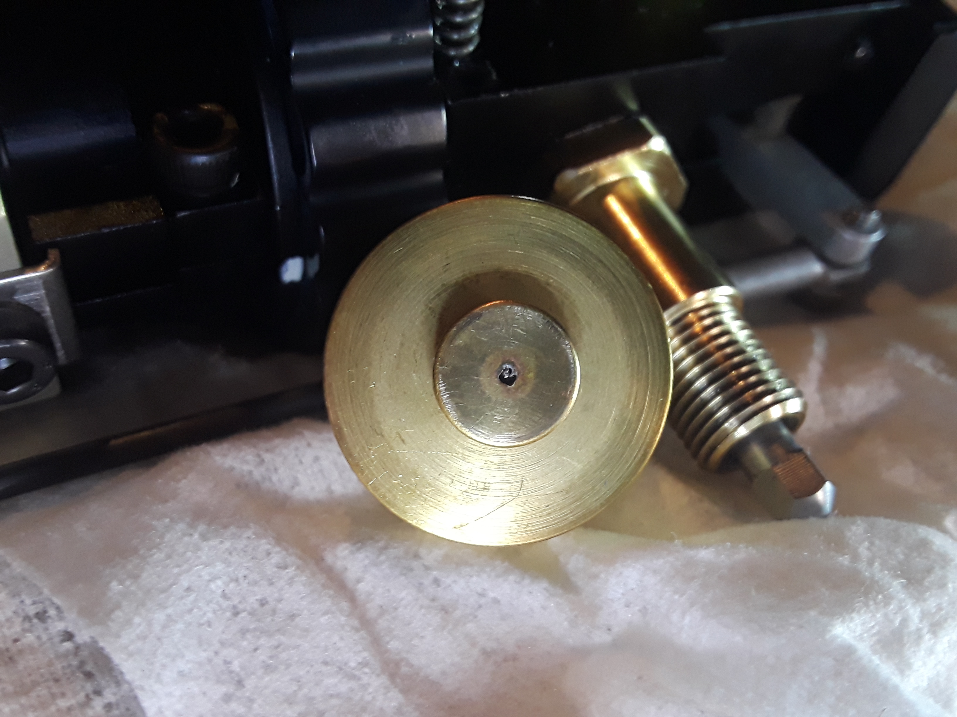

On mine I got one time a short burt to my cheek after firing. It turned out to be a damaged oring under the regulator gage. After replacement no issue.
@Camaro454 This only occurred once? Did the gun lose any pressure until you changed the o-ring? How’d your determine that particular o-ring was the problem?
It was strange due to the design of the gage installation. I attach pic for review. It would not happen every shot and very little loss of pressure. When I felt it the first time I did the tissue test but did not hold my cheek on the gun..fired from gun vise. No problem but put my cheek on it and there goes the puff. I then grabbed the gage and heard a hiss sound. Soapy water confirmed it was coming from behind the gage. Replaced gage and oring..Zero problem. Kelly at KrazyKool Sent a new gage after I showed him photos of old one. Inlet port looked funky.
