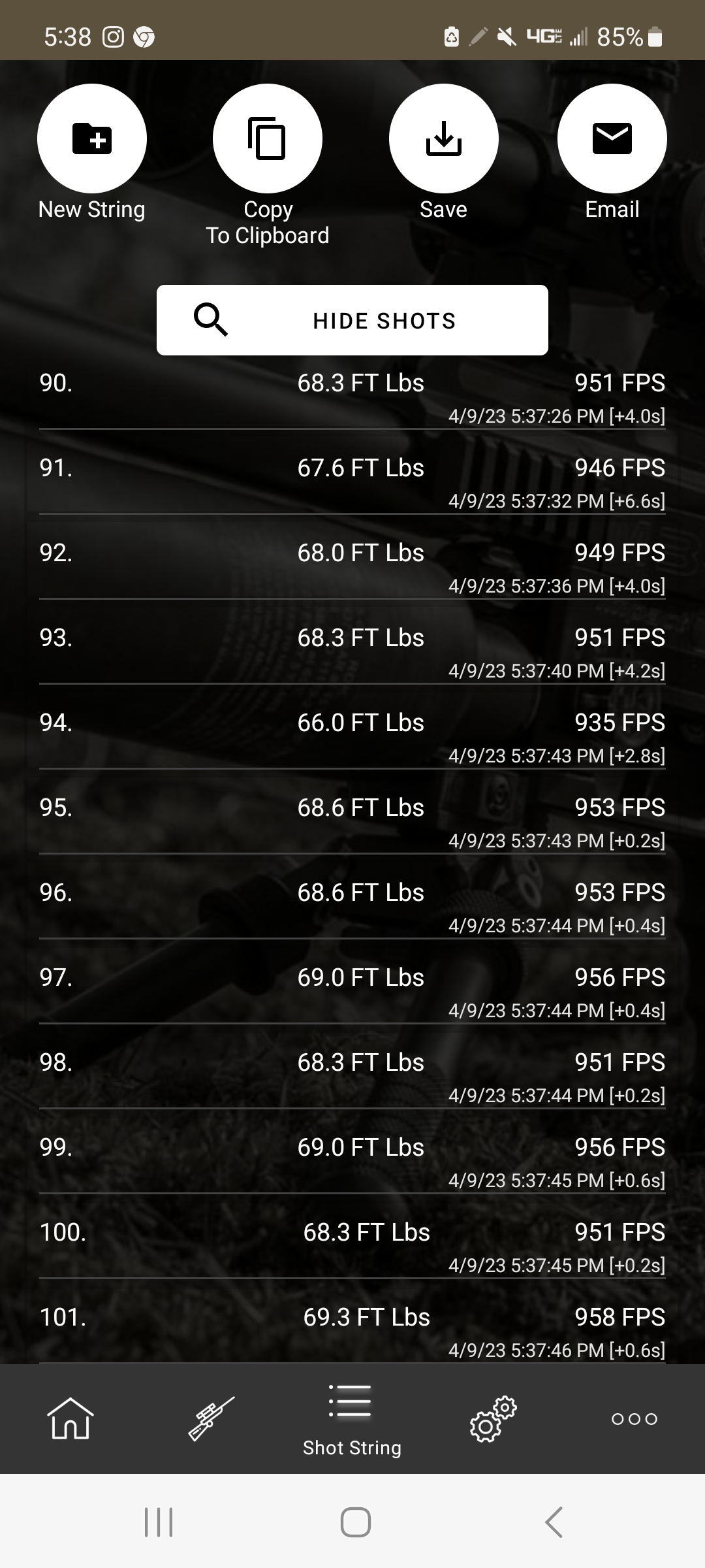

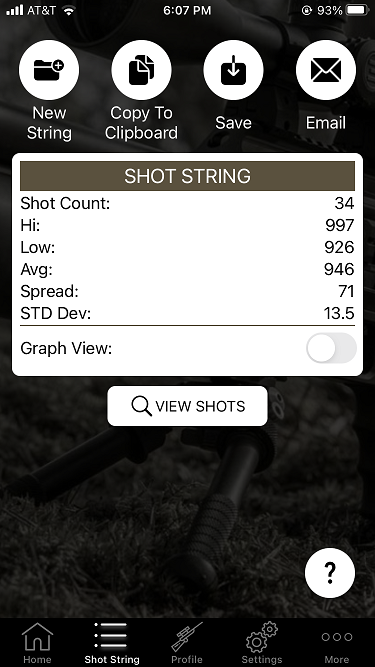

I was able to chronograph a few mags of my 2020 Huben K1 shooting 18.1 grain Diabolo pellets. I made one adjustment to slow them down a bit. Both settings shot with decent accuracy, but the ES and SD are wider than I’d like.

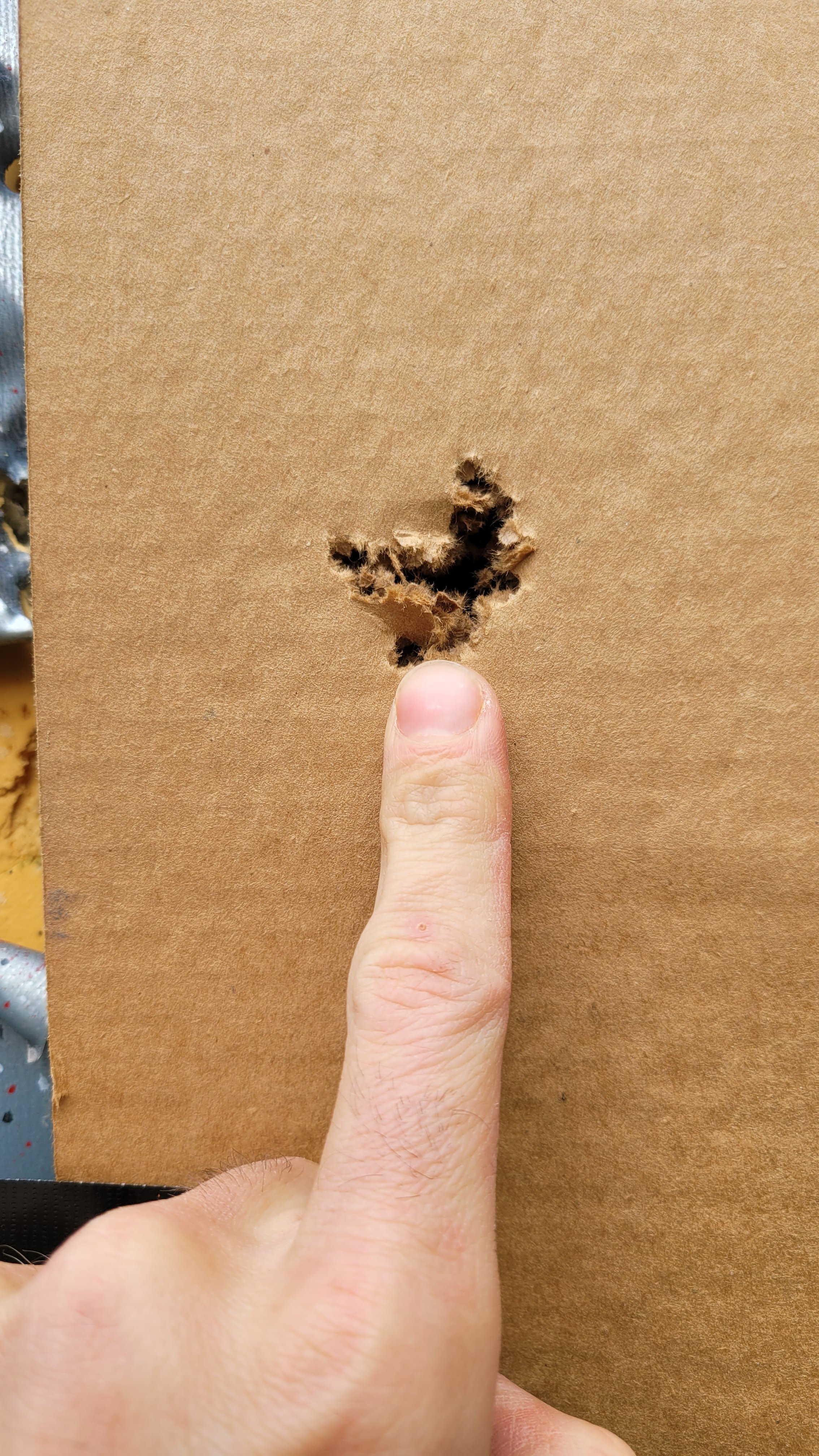

The better groups weren’t too bad. Shot these off my trigger stick bipod at 20 yards.

@Camaro454 I was kinda in a rush. I didn’t know how much time I had with decent light for the chrono to read my shots. I was surprised it read shot strings from 4 mags with it being overcast. I only had errors on one shot string. I only waited for the plenum to fill on a few shots. When I have more time I’ll try them on other settings. What o don’t like is that on a fresh fill from 30 mpa, my first five or so shots seemed hot and I needed to use a tad more holdover. I think my reg may need a rebuild.
Reactions: Bowhunter73
I had similar results in my 2021 .22 Huben. I did not try to rebuild the factory regulator, as it pretty much always exhibited the same behavior even when new. I simply could not "tune it out" and did not expect a rebuild to help - but who knows; polishing the bellevilles might help.
I eventually decided to give the Huma K1 regulator a try and that solved the issue. It has been in it for several months now, and my ES over a very large number of shots is under 15 fps always - sitting for days, shooting fast, shooting slow - it always shoots in the same tight range (18.1s at ~900).
I gave up the easy external adjustment, and of course I can no longer simply degas the plenum to go into the gun safely with the main reservoir still pressurized (I loved that feature), but I ended up with a better shooting gun . . .

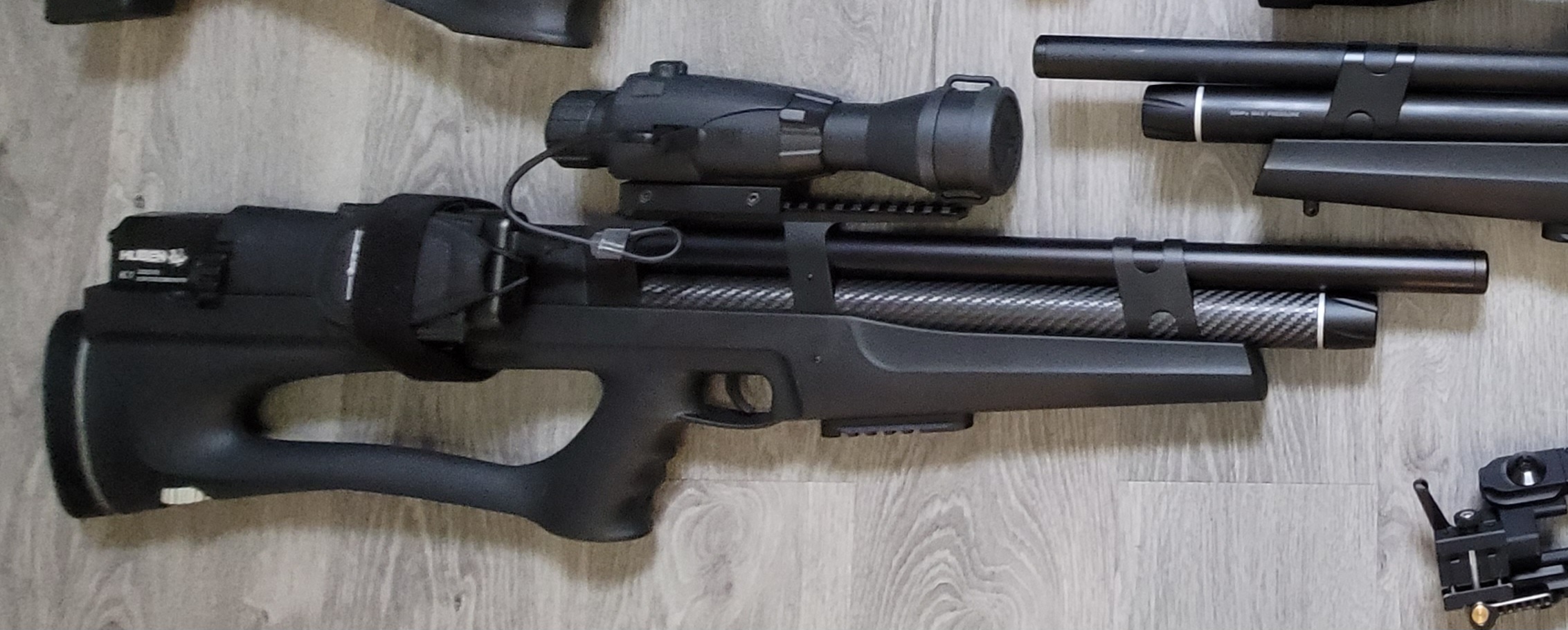

Currently right now I am shooting 15.89 around 850ish fps with my .22 huben which is brand new. I think maybe 2 mags through it thats it. I just topped it with my sightmark 4k max to prep it for ratting, will post some results this week. I do not think my spread is that big at that speed if I remember correctly.
