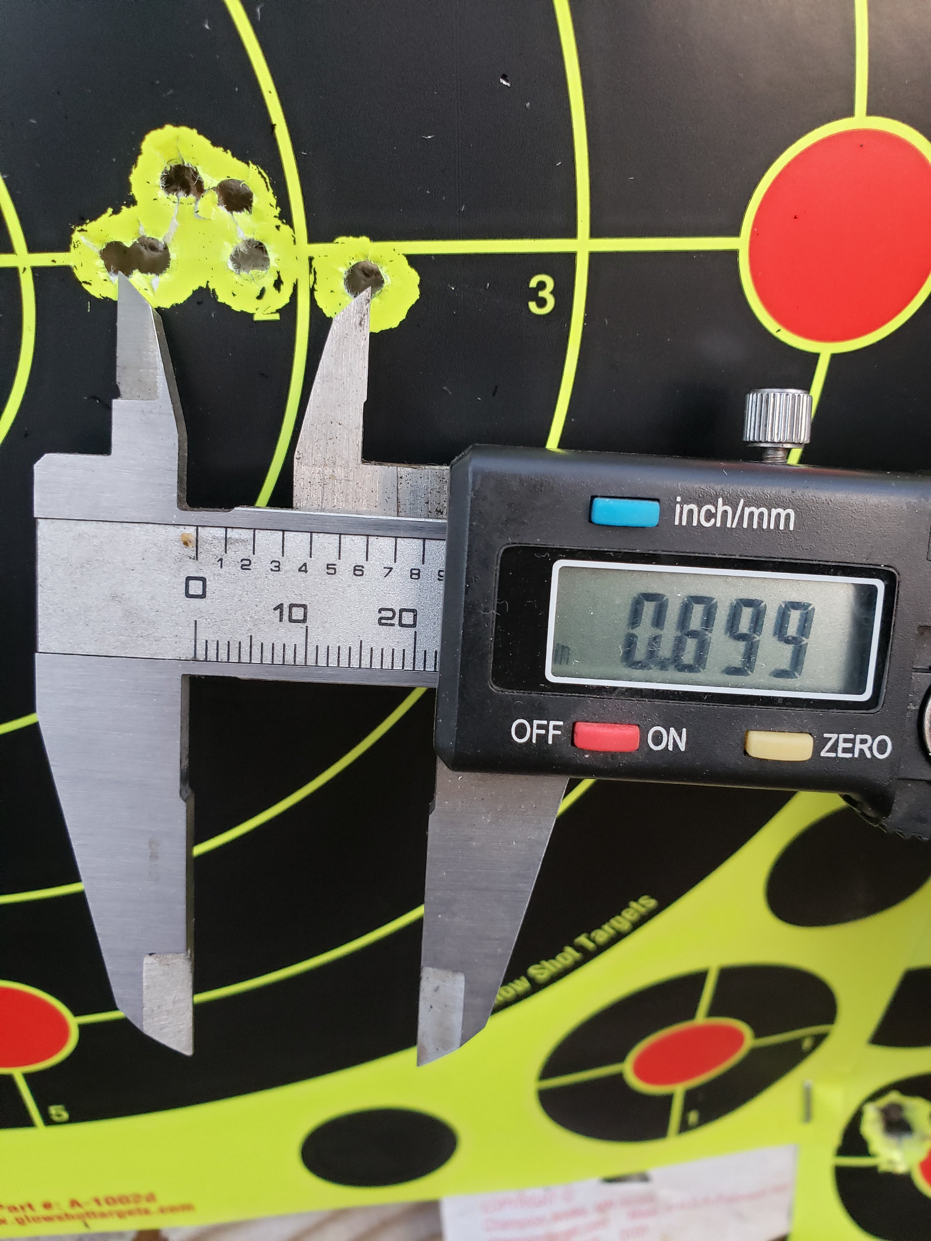

I am running a TJ barrel setup in one of my Hubens with great accuracy with 27.5gr Nelson slugs at 960fps. 6 shots at 100yds.
Are you running a custom mag with your TJ barrel? Also is it a TJ airgun barrel or liner? I’m running the .25 auto 1:14 TJ liner(.243 bore /.250 groove) with custom mag that has .250 diameter chambers and am getting about 1 1/2” groups at 100
No custom mag. TJ barrel only. Its a barrel not liner. It will produce these groups consistently.
No custom mag. TJ barrel only. It’s a barrel not liner. It will produce these groups consistently.
