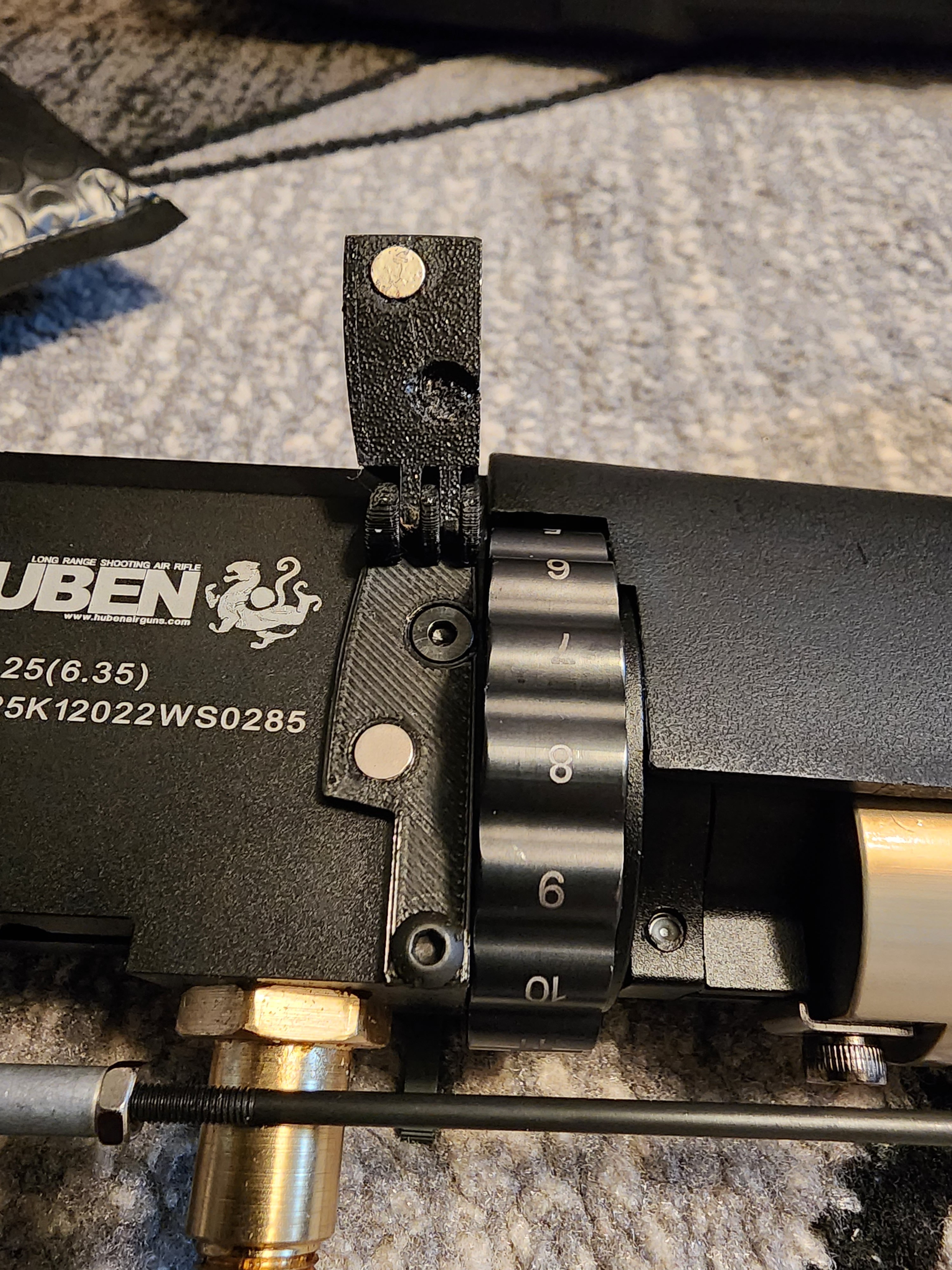

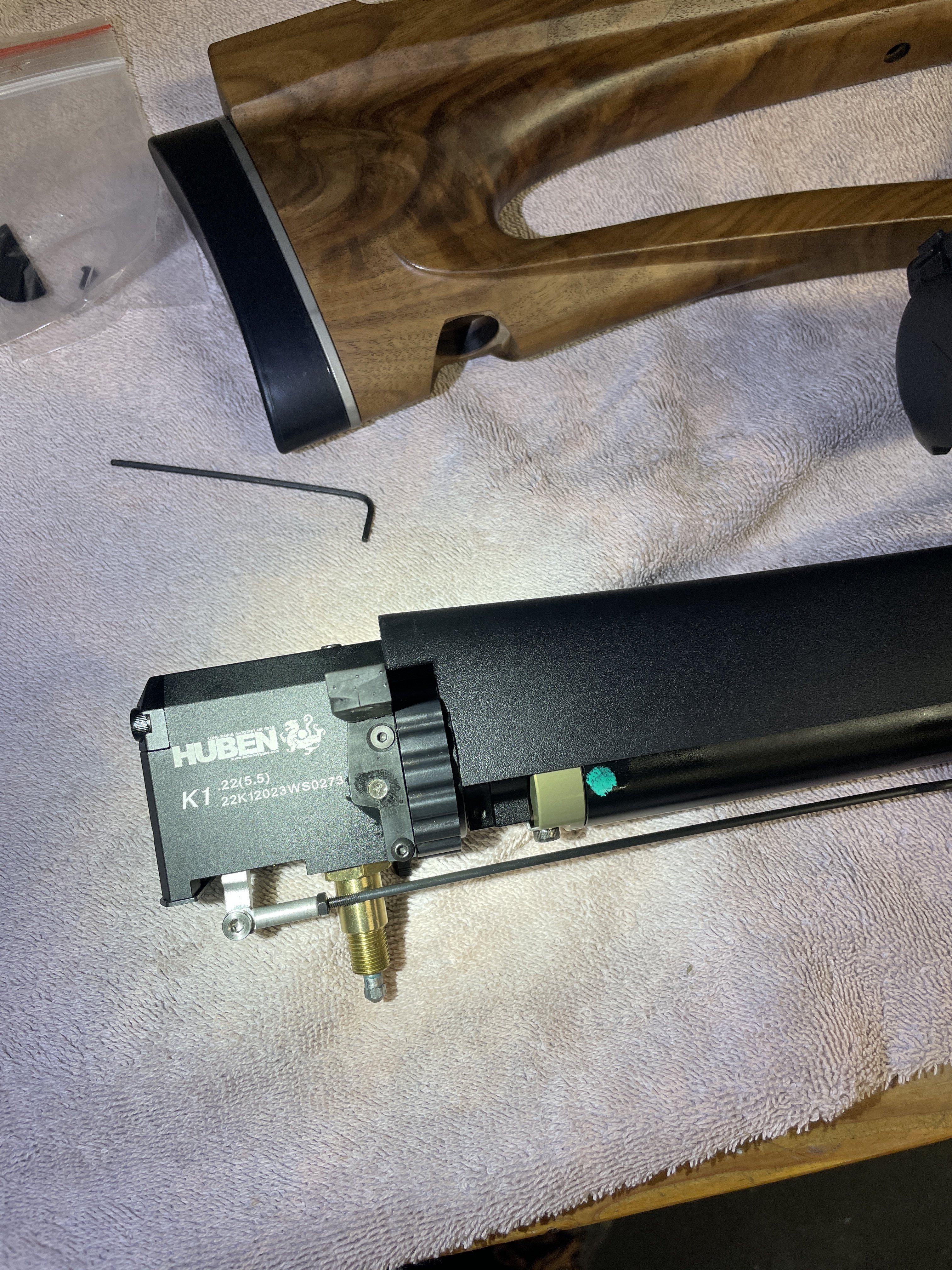

Yes, but when I put it back together the lid snapped off because there is not enough recess in the walnut stock. I also wasn’t forcing anything either. In the pictures you can clearly see the magnet sitting below the wood. Disappointing to say the least. It‘s a good design, it just doesn’t work with 2023 Hubens. Hopefully, he’s a good person and makes it right.
View attachment 366592View attachment 366591
Mine is not a wood stock but it broke in the same spot next to the hinge, never got to use it even once.

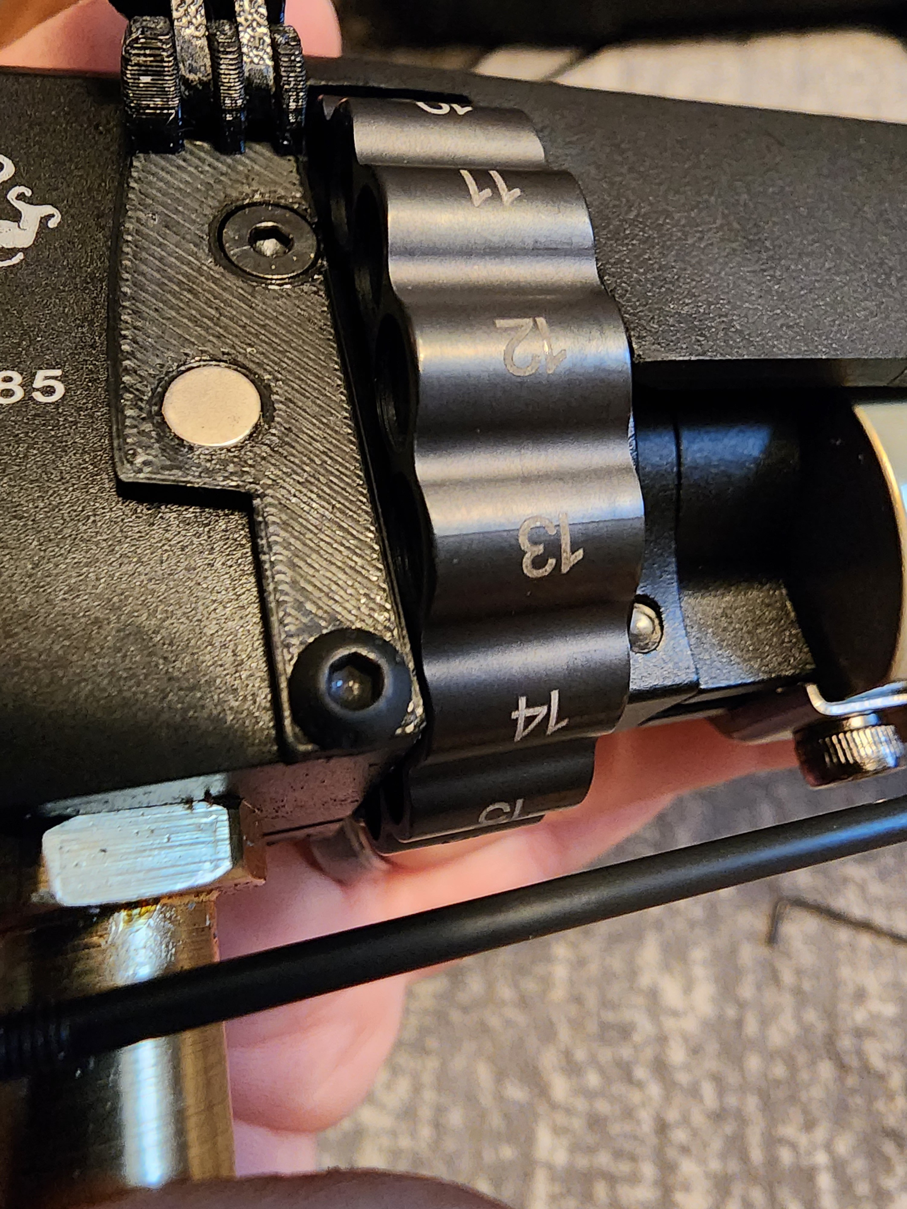

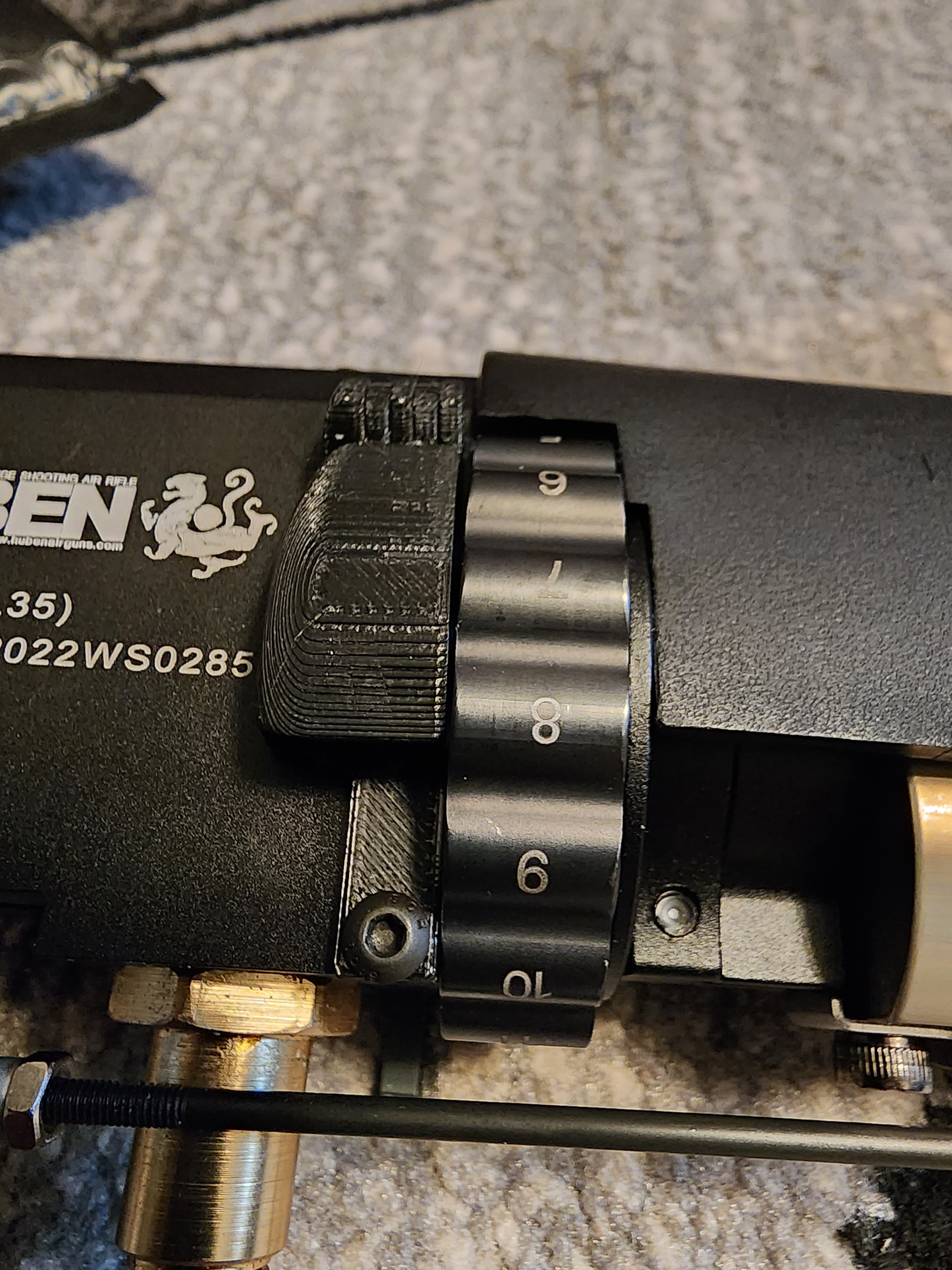

Thanks to Brawler here are some pics of my gate on a .25 so now I know it fits 22 and 25 and works.
Here are a few pics. I have about 8 finished that I will be selling for $35.00 shipped USPS First Class in the continental US
They use magnets to keep the door closed and allow for easy loading, I have tried mine on both the synthetic and wood stocks and they fit and work.
These are 3d printed out of PETG, the pictures make them look a lot rougher than they actually are in person.

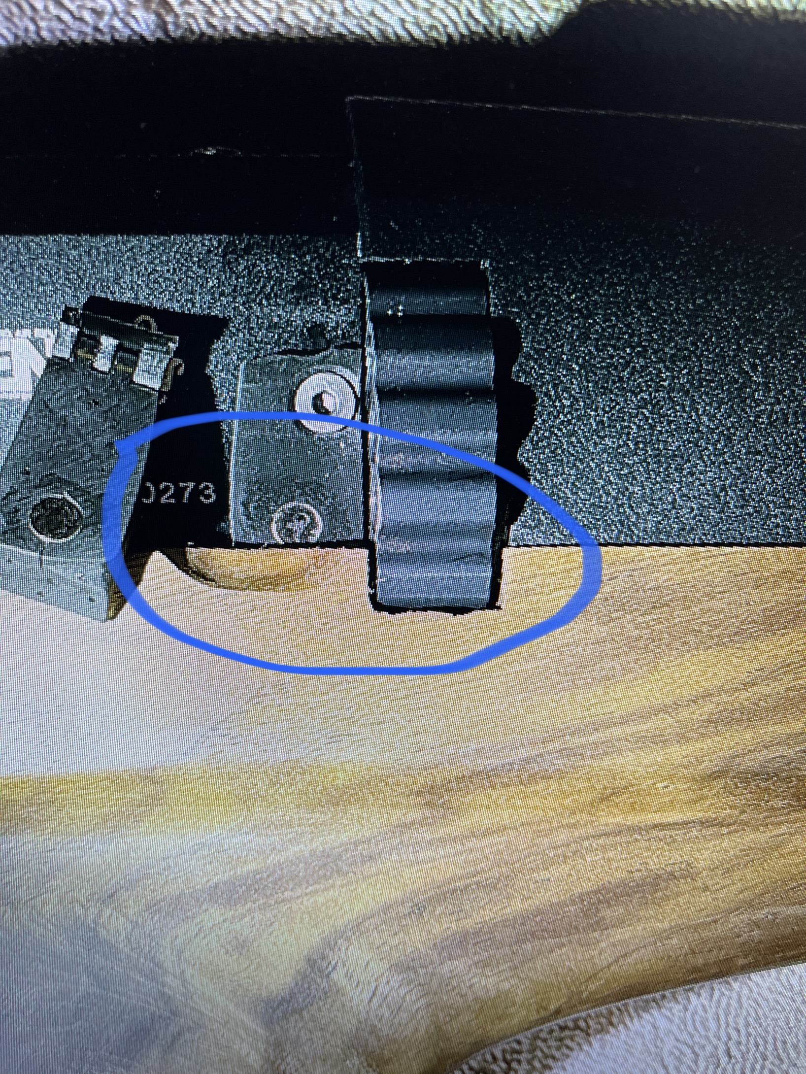

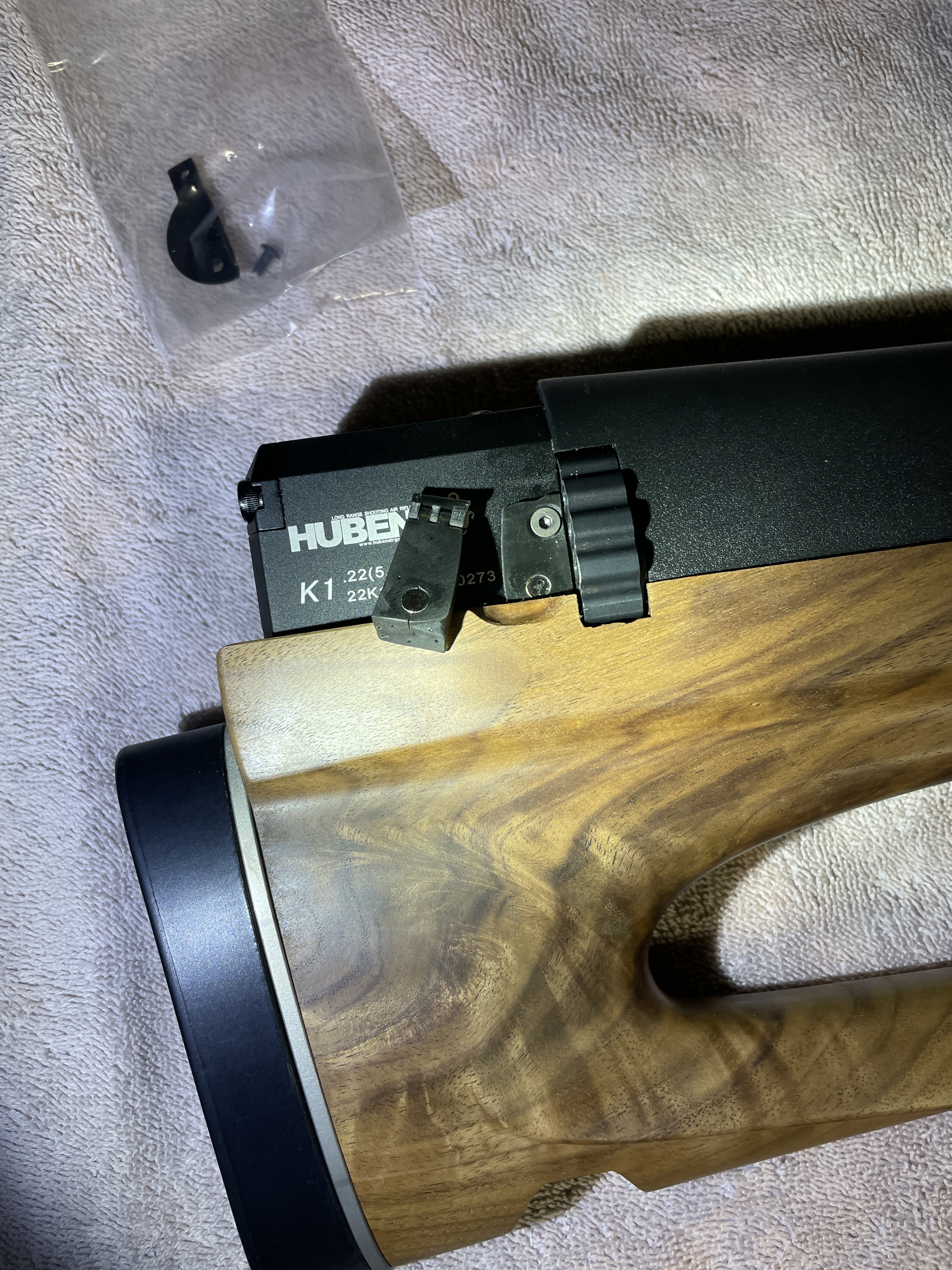

First, I really appreciate people taking the time to do things like this. It really makes the community better off. But I don’t think that will fit my 2023 walnut stock. In the picture below you can see the magnet is in the same spot as the one pictured above. This means the “lid” or flip up gate will not close or magnetized to the fixed magnet. I’m I would be happy to be your guinea pig, but if it doesn’t work, I would like my money back, including shipping.
View attachment 366829View attachment 366830
Looking at your pictures, it appears the wood stock on yours, the pocket is not cut down like the synthetic stock on mine. We checked it on a 2022 walnut stocked K1 and it fit and works fine. My local guy has a large order of K1's and the new Pistols coming in, should be here in 6-8 weeks. I will be able to check it against one of his when they get here.
Thanks
Glenn

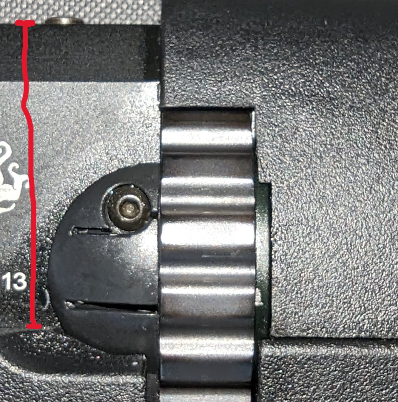

I'm interested, but have a 2023 Synthetic in .22 and wonder if the issue Hampton is seeing is due to a change in the stock this year, the difference between synthetic and wood, or perhaps a one-off issue. I measured 39mm from the top of the rail to the top of the stock near the end of the serial #. See the red line below in the photo. I'm happy to take other measurements or send you other photos.
@Hampton, I think there's a minor difference in your stock vs. mine near the magazine, looks like yours curves back up again, that might be the issue.

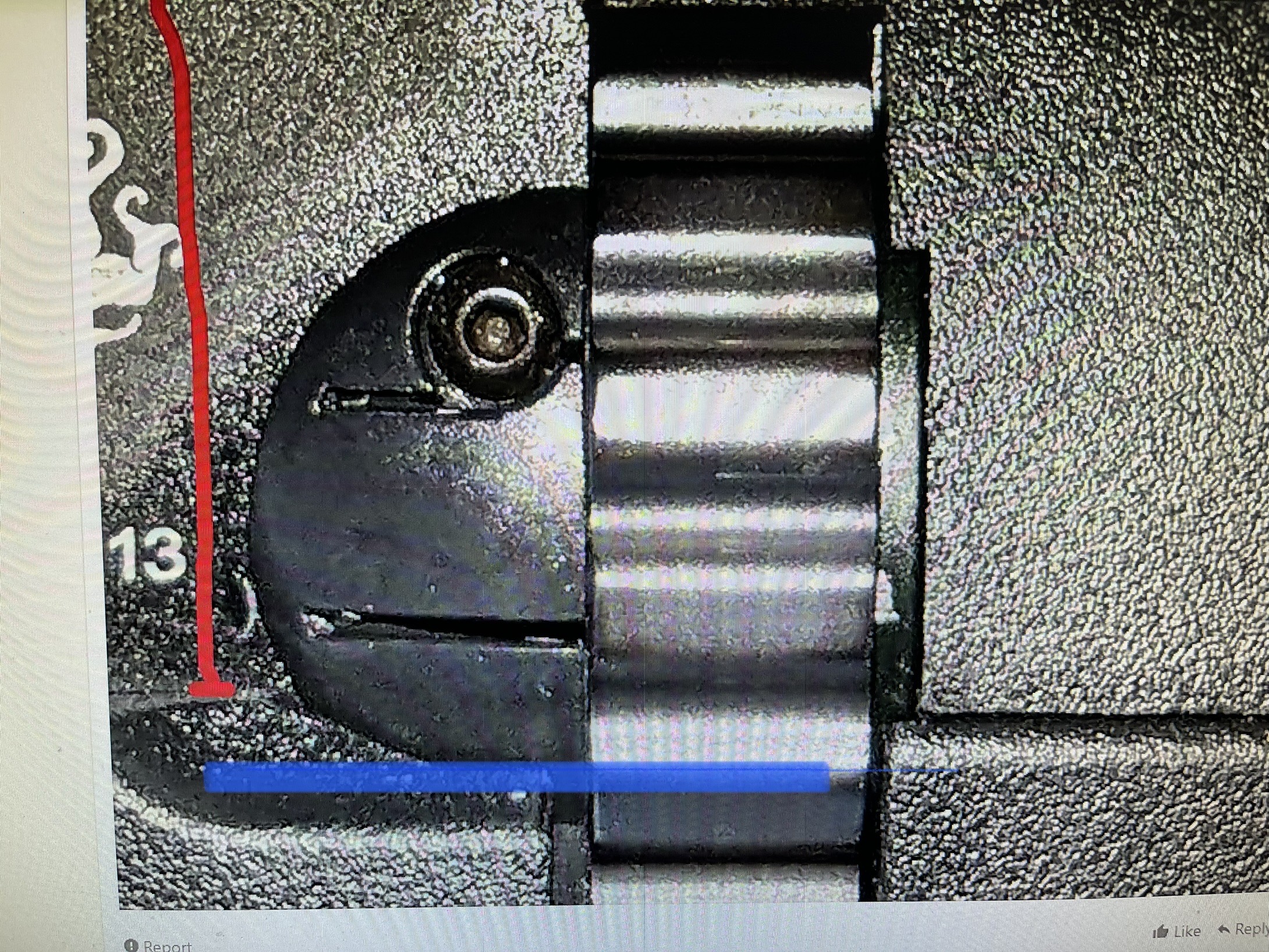

Look at the blue line I have made on your pic and the same area located on his pic. See the difference. The back part of the wood is not cut out like on the synthetic.
You may have to look at your original pic to see it. I hope I’m explaining it so you understand.
If you sanded the part in the red circle so it matched the synthetic in the red circle. The gate would close and work just fine.
Thanks! Think the gate will hold up to a little sanding to smooth out the ridges? I'm still interested in a .22.
I will be interested to hear what you find. Is there any meat I could sand off the gate to make it work with my stock? Or is the magnet too close to the edge? Thanks
