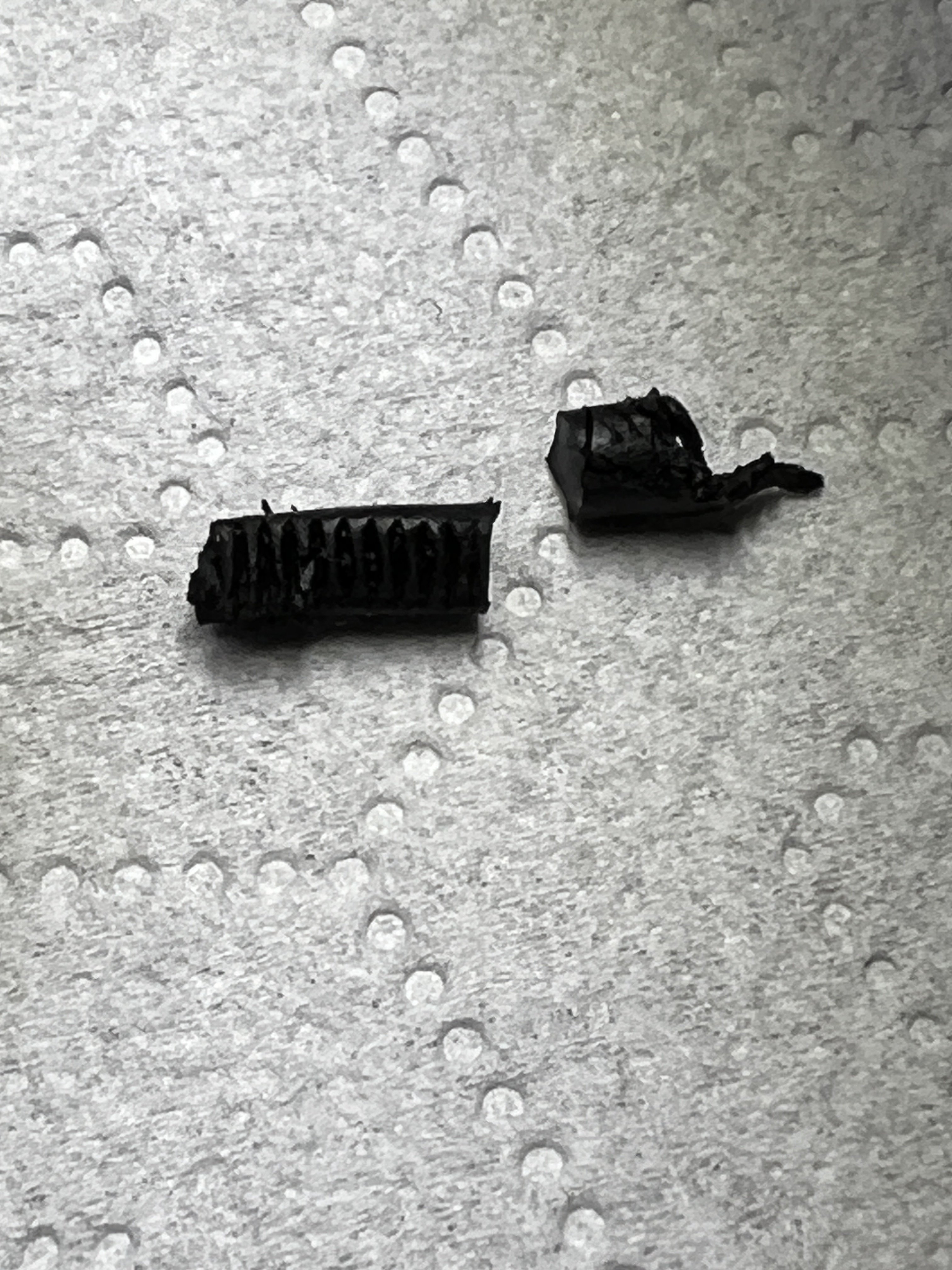

i have stripped and opened up the main receiver body thinking i will strip as far as i can go and replace every thing on starting to strip i came across this damaged rubber part (pic attached) but for the life of me i can not identify the part ?, it is around 3-3.5mm in diameter and about 10mm in length but looks almost like a rubber pin with serrated edge or I suppose it could be a large damaged rubber oring but no idea where from if any one can please help ??..
Looks like a rubber piece (antivibration/loosening) that goes in the trigger adjusting screws in back of gun. Serrations are from screw threads. Could have jammed your trigger mechanism or allowed it to come out of adjustment. Call Kelly.
Thanks guys makes perfect sense as i found it in that area, It’s odd its not shown on parts diagrams now to see if i can get it to shoot as it should, going back to my previous post when it jammed up last no matter how many times i pulled the trigger it would not fire but after 10 min back in the gun rack it fired by itself luckily my rack is pointing my rifles to a solid wall a few feet away I’ve got to get to the bottom of this constant jamming problem…

if its not the rubber piece as stated above then I believe that may be part of the large damper orings around the hammer spring. There is usually two of them back to back and one will roll and get caught in the sear then rip pieces off. Whenever I have one in for service that has the orings in it I replace them with a one piece seal like the older ones had. Never had an issue with the old style. Take the rear cover off and you will see it right away if that's it. Just don't pull the trigger with the cover off as the hammer and valve will fly out. and could be dangerous. You can contact me vis phone at 812-309-0331 if you need help.

i put it away for a few days as was getting frustrated, Anyway i rebuilt it again yesterday double double checked for any broken o rings and took the trigger parts out and cleaned and lubed everything there were small bits of rubber around from the broken rubber pin i found, Anyways woohoo all seems well again put around 50 shots through her and all good i just hope its ok after its been sitting overnight….
