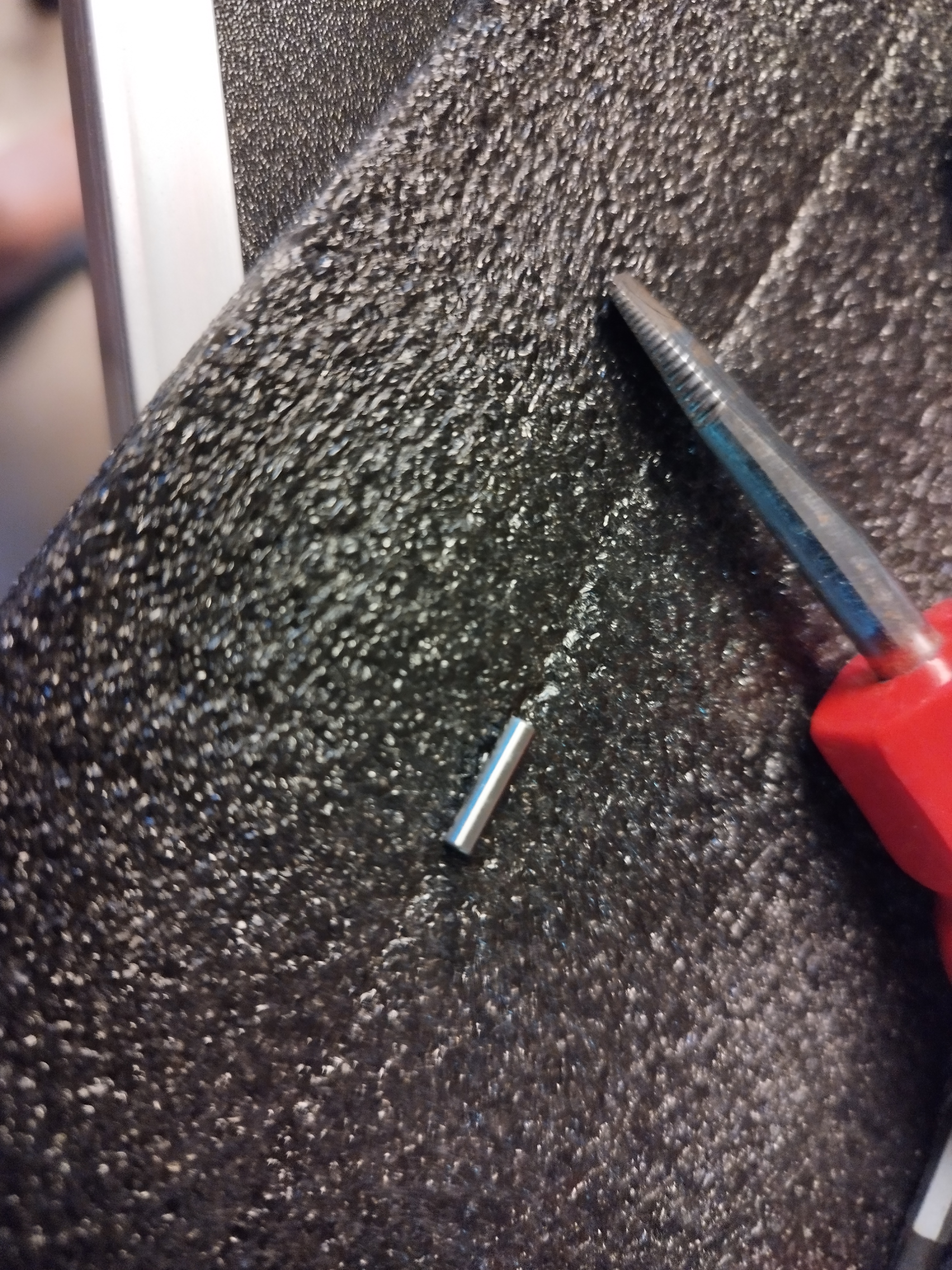

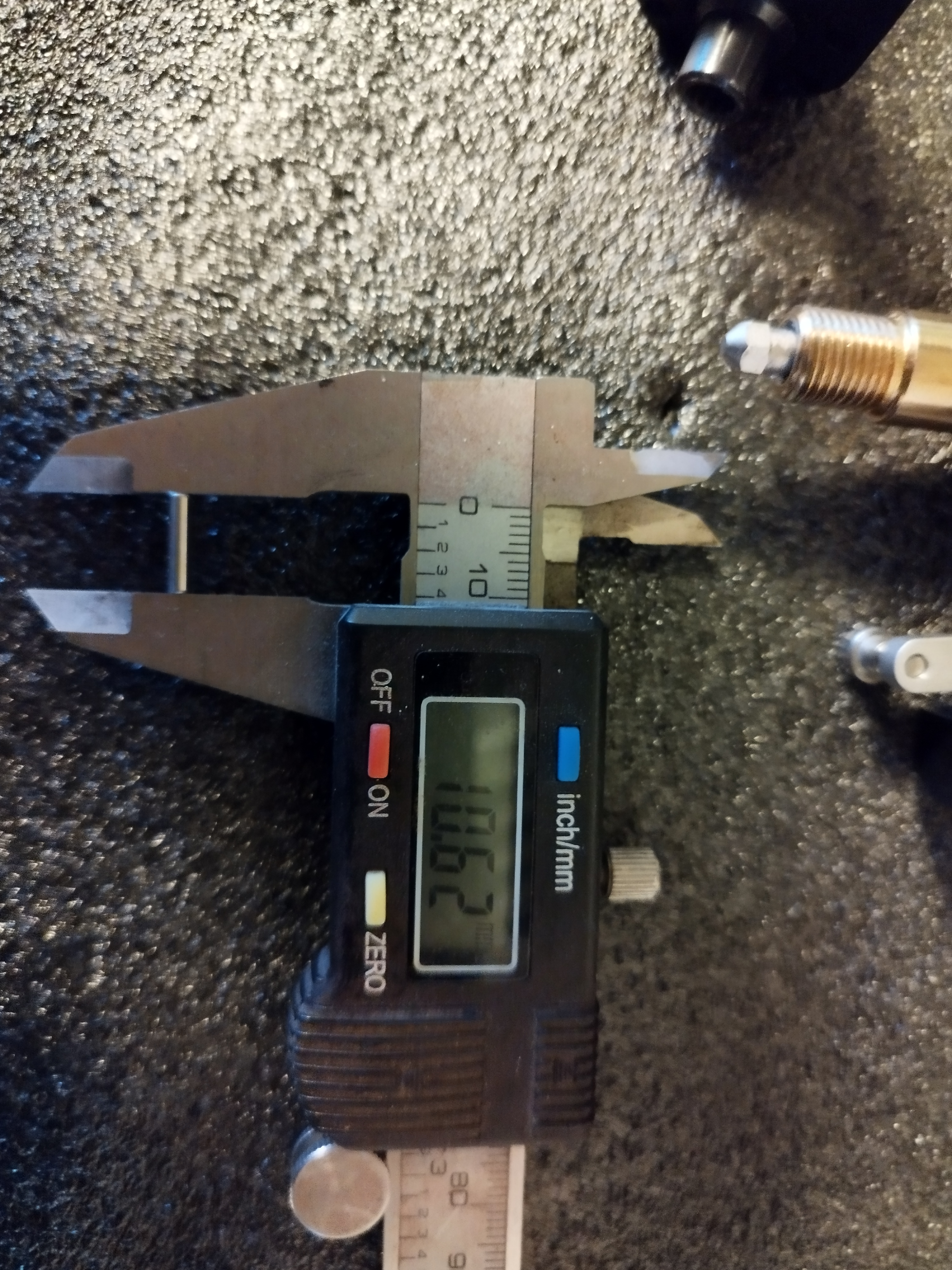

2.45mm thick. I was thinking maybe that part myself(have not yeat dissasembled more) i sold my k1 to a beginner,told best to use beast/redesign that i provided.. he then had some old pointed pellets and wanted to shoot them avay.. =jammed up, then he went on youtube and started the work=did not gett all pressure away and .. then this part leftover,airleak somewhere and magazine lock doesnt work. So now iam studying the thing
figure it out? is the magazine cycling to the next pellet after firing a round? find the leak?
