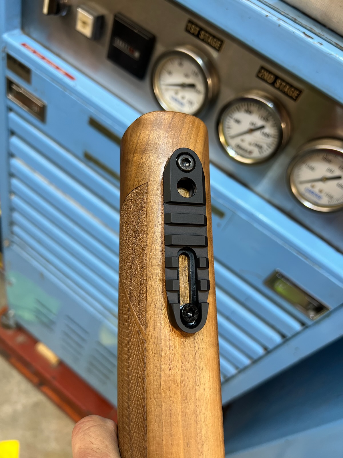

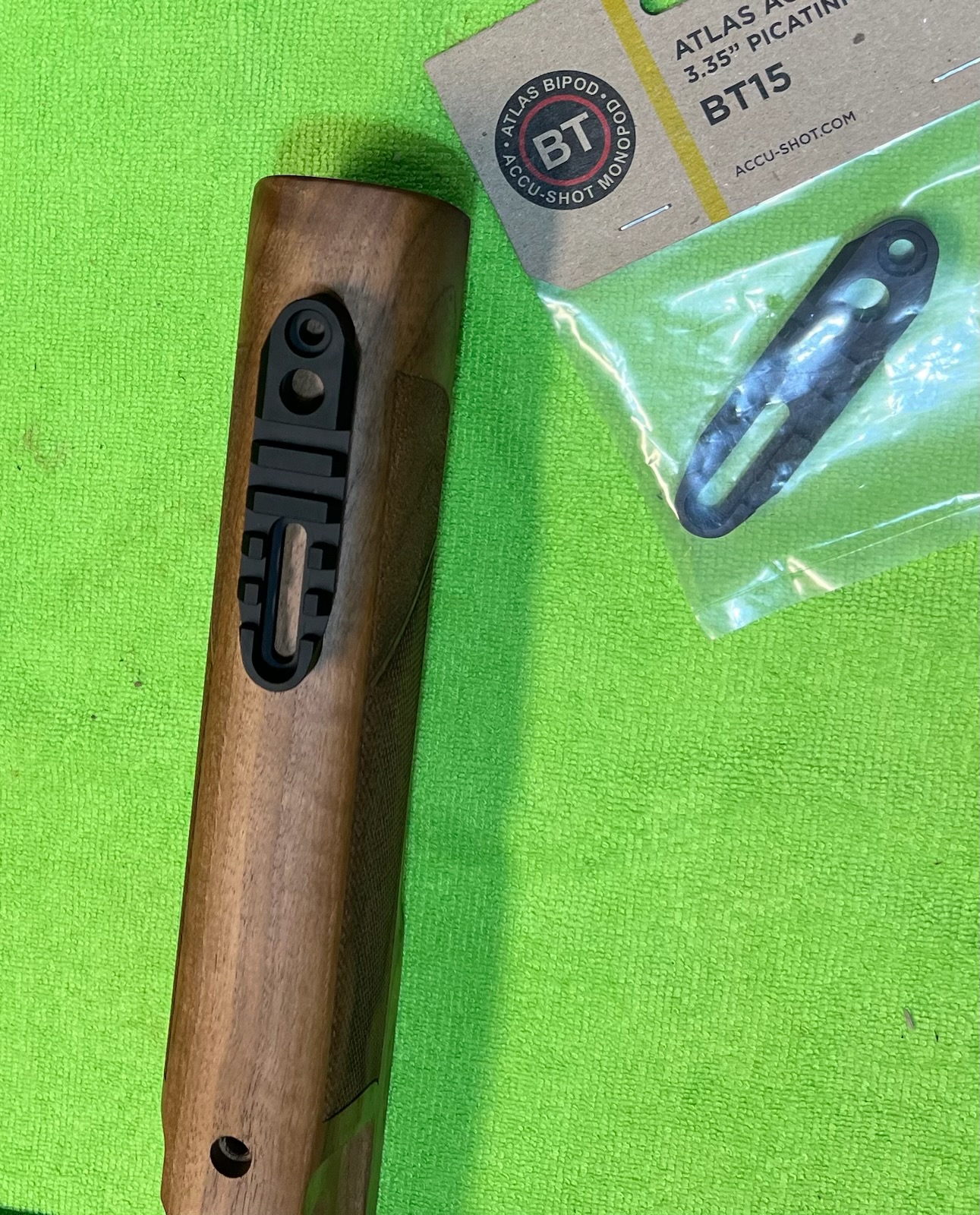

I was thinking about getting a short pic rail for the underside of the fore grip for a bipod or QD swivel stud. I have never installed one.

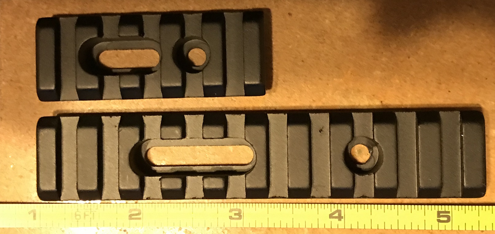

@Ezana4CE Here's a better picture with measurements for you. I'm probably going to add the longer one just so I can add a bipod/tripod and light at the same time. The shorter one would work fine for picatinny to arca rail adapter.

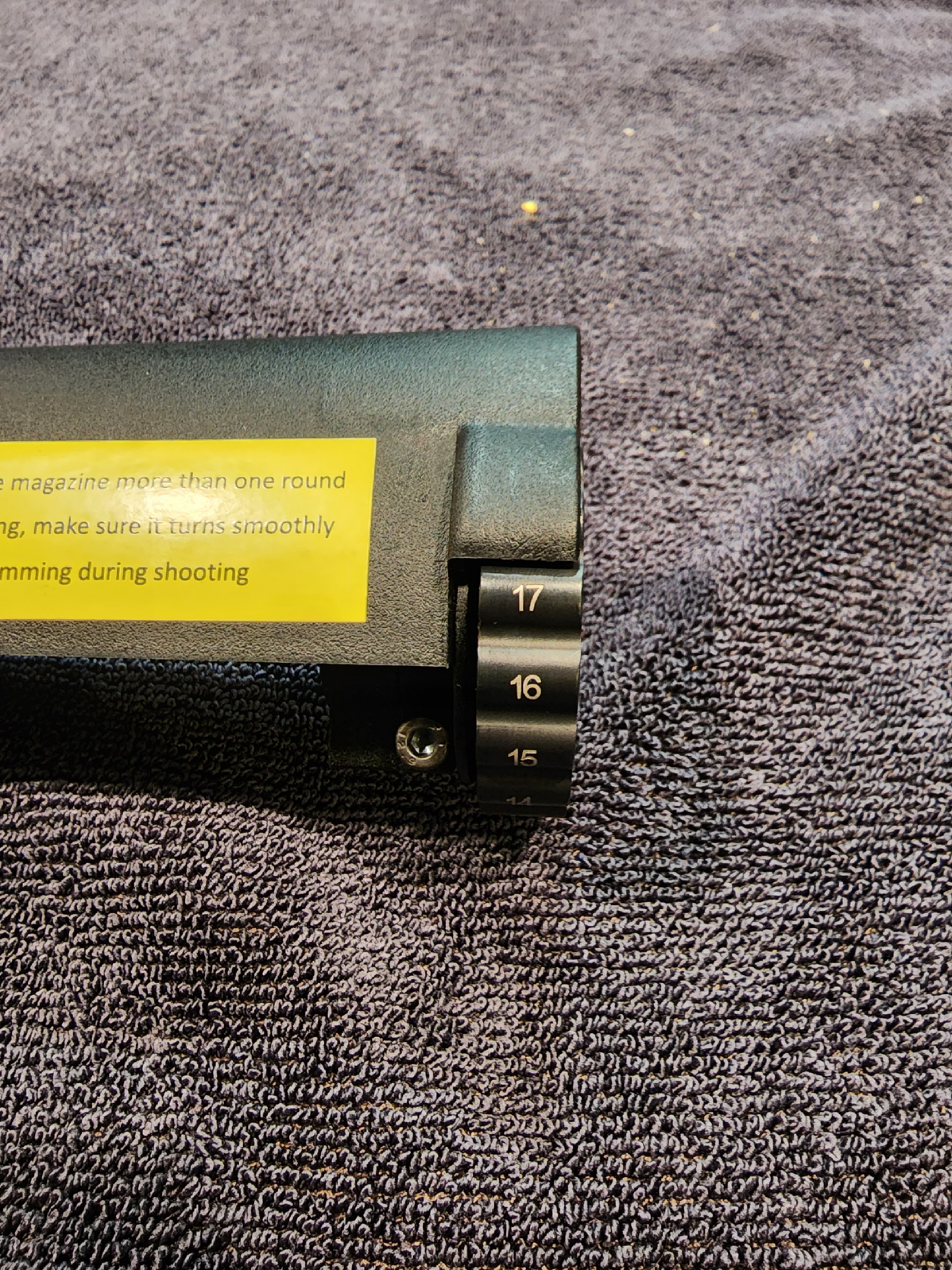

Okay I am new to the huben world but I liked them so much the leshiy 2 can go and I now have one in .22 and .25. I have done a mod that I haven't seen others do yet and it's my favorite and its laser the mag to count down. I also did the wheel but not happy with the way we did our first test run so came up with another design with Kelly and will update when I get that one sorted. The other thing is the picatinny rail it is one of my favorites because it has curved edges and contours to the stock.
I love the Lasor mag count,,

I too love the numbered mag slots - but honestly I wonder if they would be better "upside down" vs. how they are shown - we interface with the slots more on the other side of the gun. I guess it depends if we normally looks at them from the top or side . . .

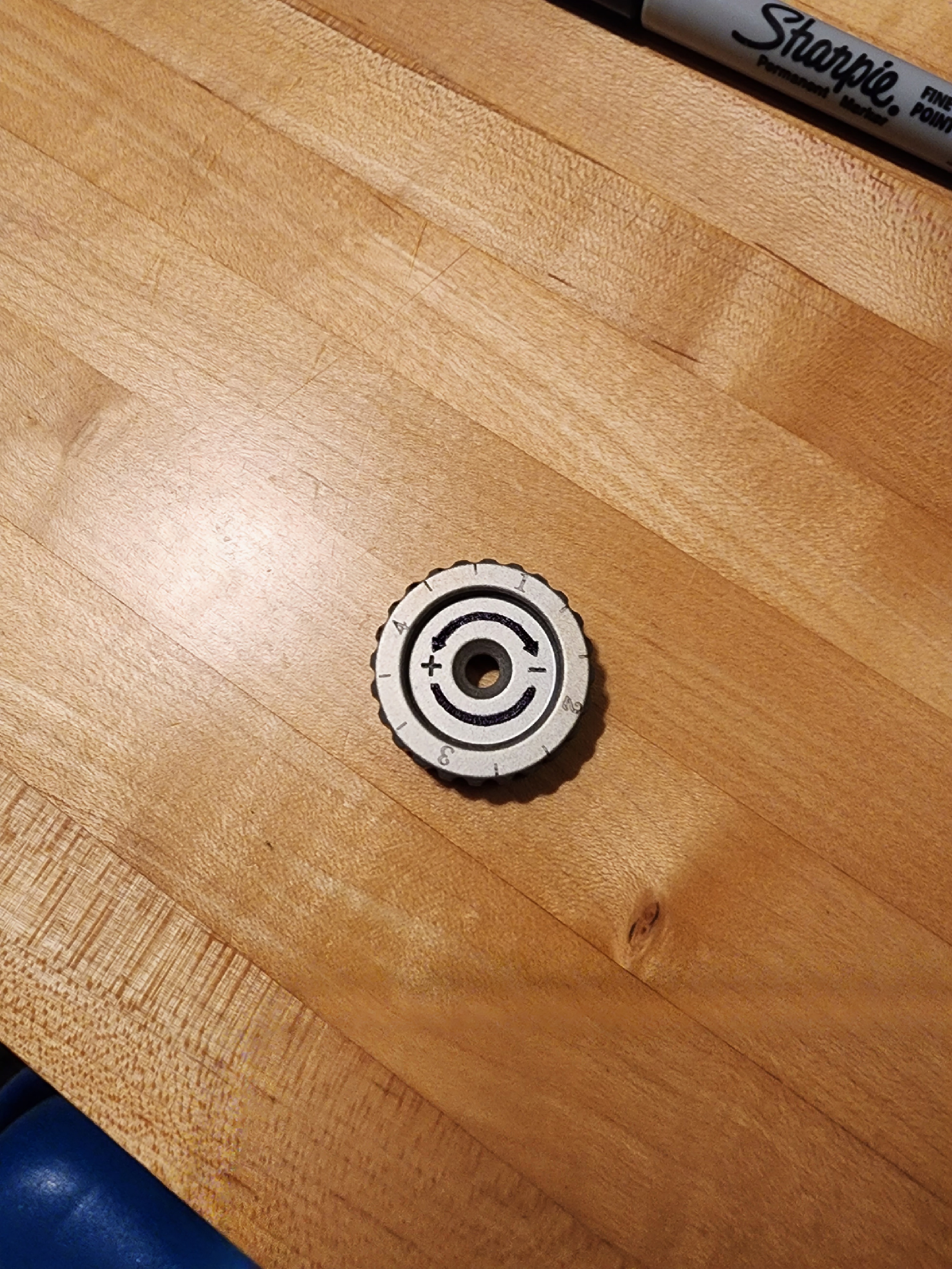

A simple thing I did to the power wheel was to place black sharpie dot over the number one position, and once I have the gun dialed in to my main tune I reposition it so that the dot is centered in the stock. I can count how many clicks open the gun is from full closed and note that for future use, but this dot make a good visual "zero" of my set up, with an easy adjustment CW or CCW on that for power as needed (which is usually only a few clicks anyways).
The loading side is a little busy and being a righty it's easy to pop off and take a look and see how many shots are left. It's personal preference but this is the way it worked best for me.
Face palm . . . I was not even thinking of counting shots until empty! I was thinking more about loading it up. Makes perfect sense now. I would love to get that done on mine. I'll have to look into it at some point.
Today I counted the clicks of travel in my power/velocity wheel. I counted 75 clicks from top to bottom. Does anyone know if they are all useable or if some of the travel is in excess? Meaning will the wheel reach a point where it makes positive clicks with little to no resistance, but yields no change in velocity?
Just like tuning other regulated pcps the clicks will eventually do nothing for said regulator pressure that's when you reach its max for that pressure when the clicks don't do anything.
