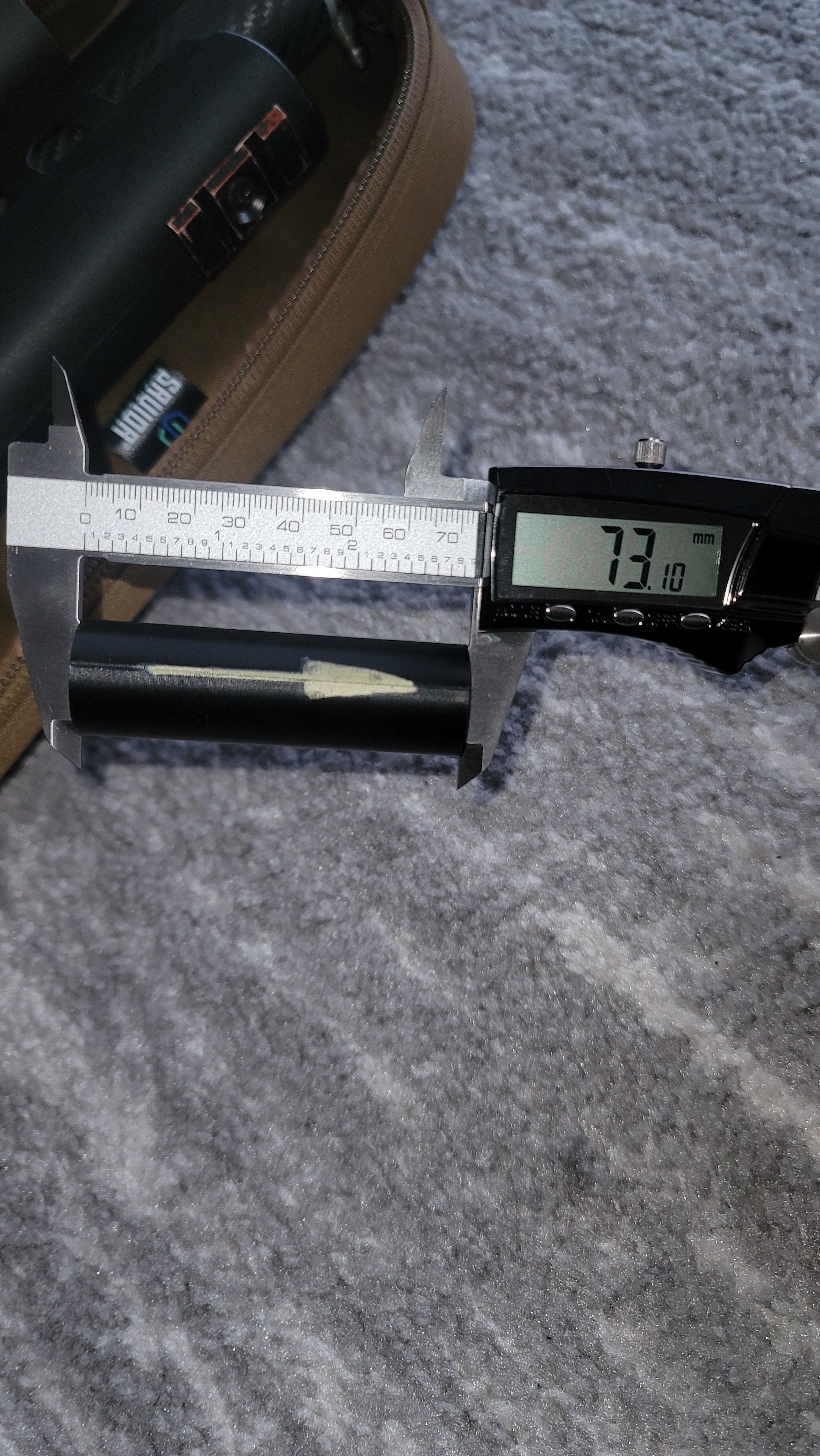

@JaceSpace1369 Have you received your insert yet?, If so, how is it working for you?I should be receiving his shroud insert sometime this week if the post office in CA gets their act together. It's been floating around the facilities since last Tuesday. I am also receiving a .218 sized Huben Magazine from Kelly on Tuesday so I will see how the .218 slug and .217 slugs fit and measure them, then test them throughout the week.
I received it but it doesn't fit in the shroud, I told the member and he mentioned that my unvented shroud is a different length than the vented shrouds. So he said I could this one but he made me a new one to my measurements. It should be here early next week, I think.@JaceSpace1369 Have you received your insert yet?, If so, how is it working for you?
I was too lazy to grab my phone a photograph it. It looks like a 3D printed solid tube that is hollow in the center to allow your caliber of choice’s projectile to pass through unobstructed.can we see a picture of this 3d printed insert?
The insert seriously makes a noticeable reduction in sound when used in conjunction with a moderator. I’m running a Donny FL Tanto. I just tested it shooting five 18.1 grain diabolo pellets in .22 caliber. I was hitting what I was aiming at offhand. No evidence of clipping in that shot string.let us know if the inserts make a noticeable difference. i ended up making a silencer for mine and it makes a world of a difference. if the insert can bring the sound report down as much as the silencer i made, i’ll use that instead. i wanna keep the k1 as short as possible
You're welcome! I am happy to hear it works!I was too lazy to grab my phone a photograph it. It looks like a 3D printed solid tube that is hollow in the center to allow your caliber of choice’s projectile to pass through unobstructed.
The insert seriously makes a noticeable reduction in sound when used in conjunction with a moderator. I’m running a Donny FL Tanto. I just tested it shooting five 18.1 grain Diabolo pellets in .22 caliber. I was hitting what I was aiming at offhand. No evidence of clipping in that shot string.
To install it I removed the factory baffle stack. First I emptied the magazine, then I removed the moderator adaptor, next I took a wire to pull out the first 3 baffles. Then I tilted the gun muzzle down and the remaining baffles fell out into my hand. I dropped in the insert in the direction of the arrow drawn on it. It way situated just below the threads on the end of the shroud. Finally I replaced the moderator adaptor.
