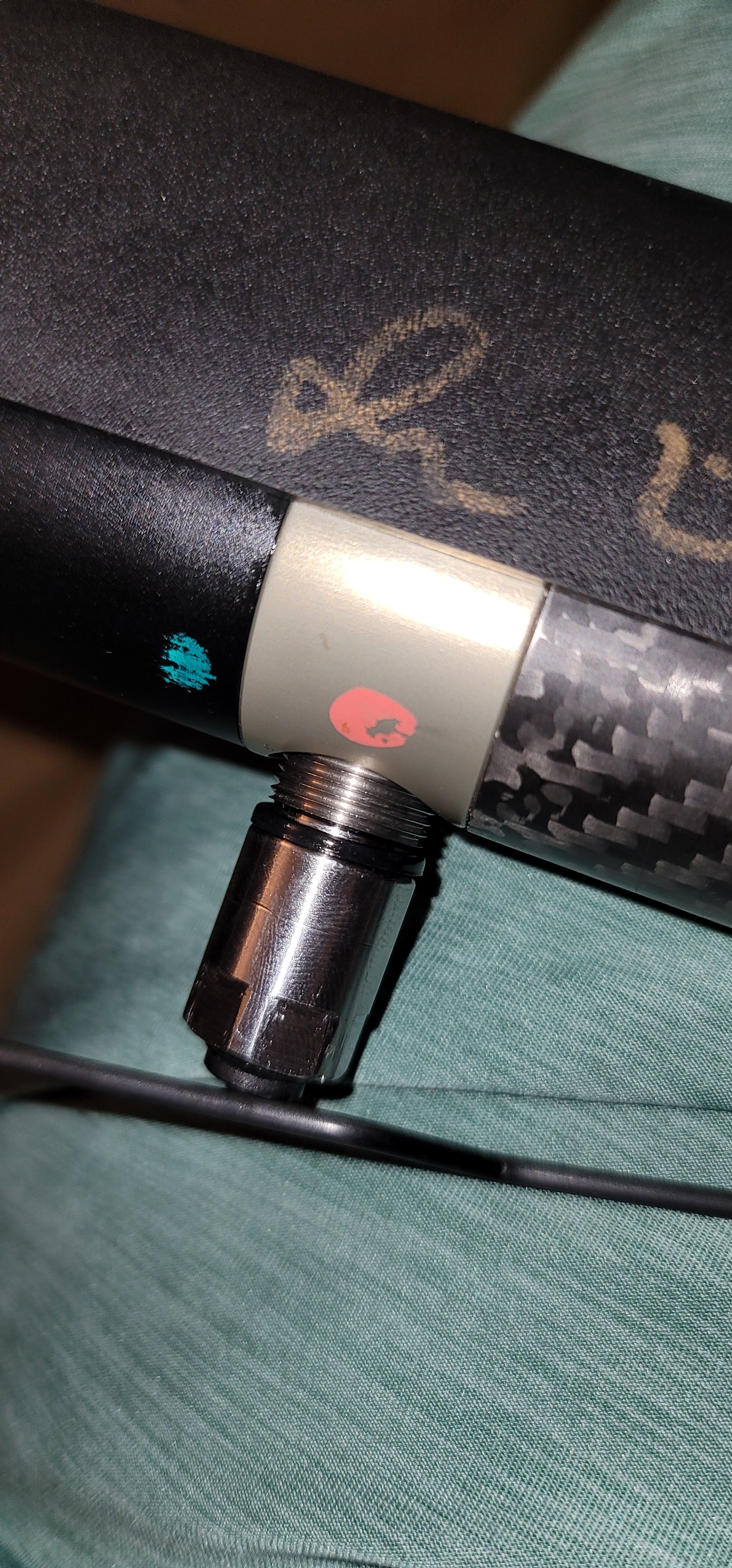

I adjust mine all the time. I have a .22 that is set up for pellets (JTS 18.1s) and my "full power " setting is about 940 fps. I then dial it down as appropriate for the shot at hand - and if it is a chipmunk close to the house that could be as low as ~350 fps. I simply put a sharpie mark on the wheel, positioned so that it is pointing to the muzzle at "full power" and dial it back as appropriate. I know from testing how much each click drops it and the holdover required, and about 3/4 of a full turn clockwise (while looking at it, gun upside down) drops it under 500 fps.
