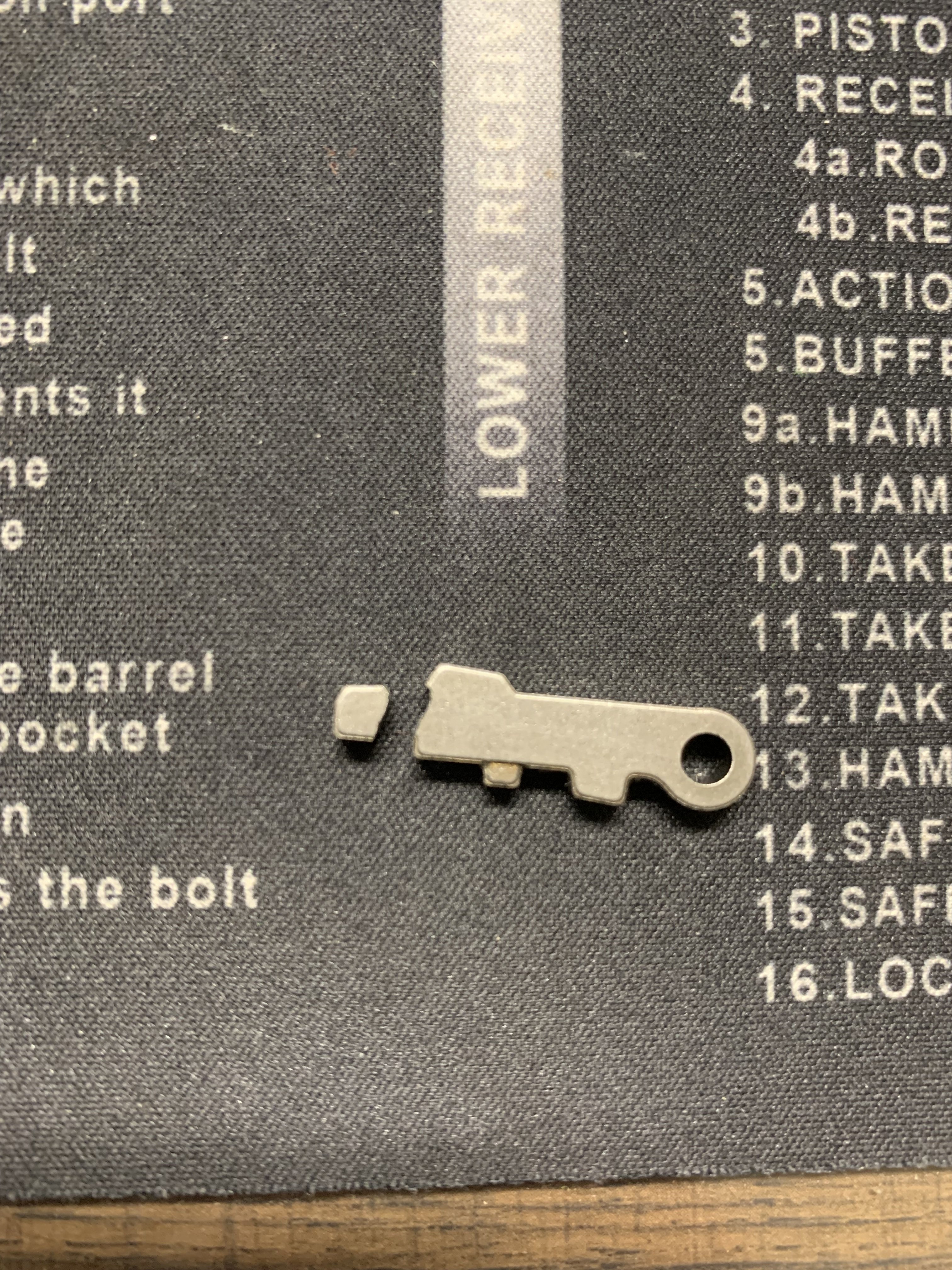

if you have air exhaling out of the muzzle, i would look into the striker sear as the root of your problem. if the gun starts popping air like it’s going full auto and you can speed up or slow down the popping air by adjusting the regulator pressure.. it’s definitely the striker sear.
No air coming out of the muzzle, just the rear. I do remember air coming out from the mag side when I bled the regulator.
the magazine is behind the barrel and the magazine is behind the valve that opens up for each shot fired.

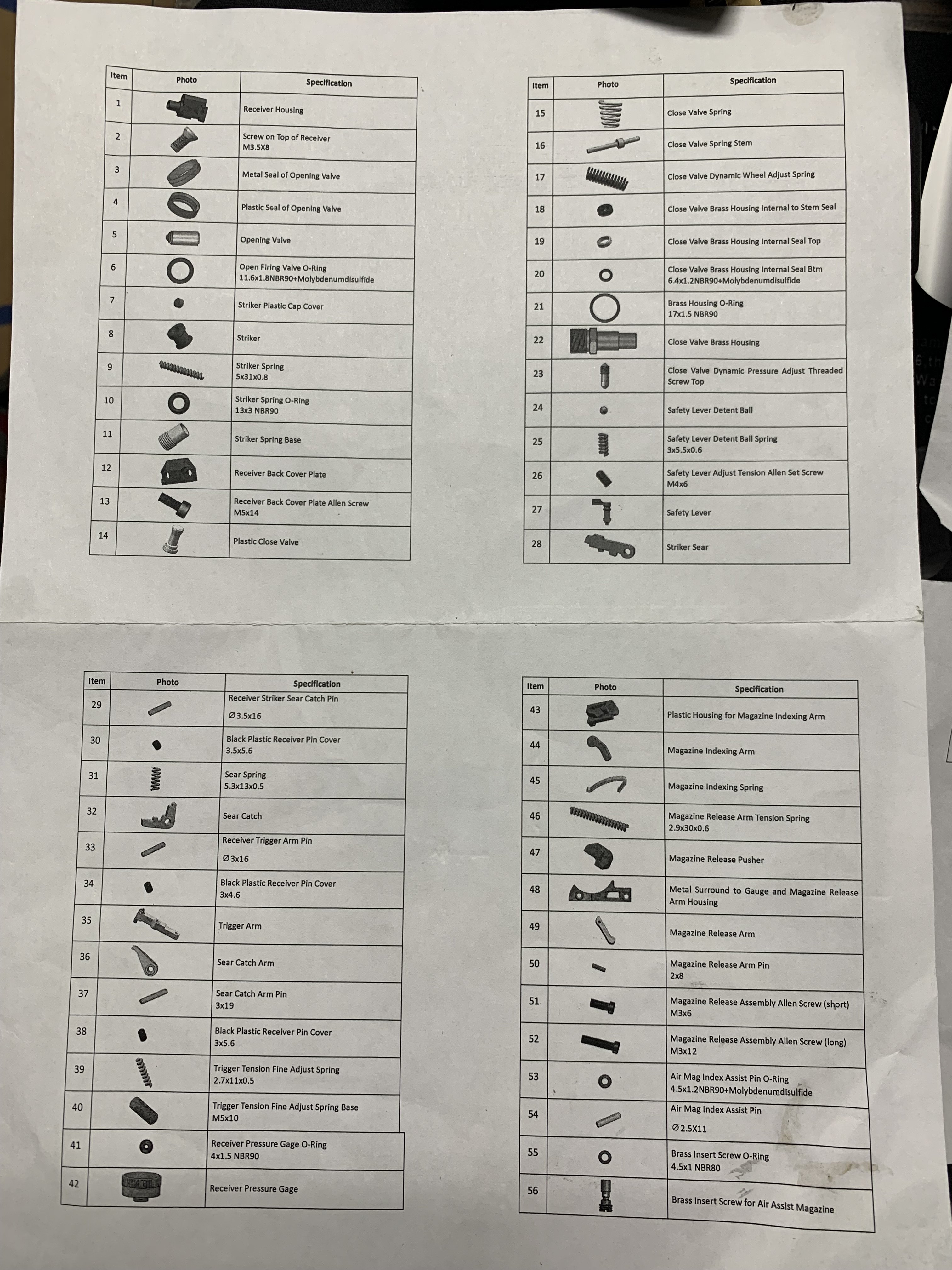

the striker sear(part#28) is in the video. you can see it cycle to release/hold the opening valve(part#5). mine (part#25) was broken and the opening valve would not fully cycle part#5 which in turn would slowly bleed my plenum. the regulator would try to keep the plenum pressure setting so it just kept pulling air from the tube reservoir(this the leaking air i would hear from the muzzle and area of mechanical action).
he’s my broken striker sear.

the striker sear(part#28) is in the video. you can see it cycle to release/hold the opening valve(part#5). mine (part#25) was broken and the opening valve would not fully cycle part#5 which in turn would slowly bleed my plenum. the regulator would try to keep the plenum pressure setting so it just kept pulling air from the tube reservoir(this the leaking air i would hear from the muzzle and area of mechanical action). View attachment 510580

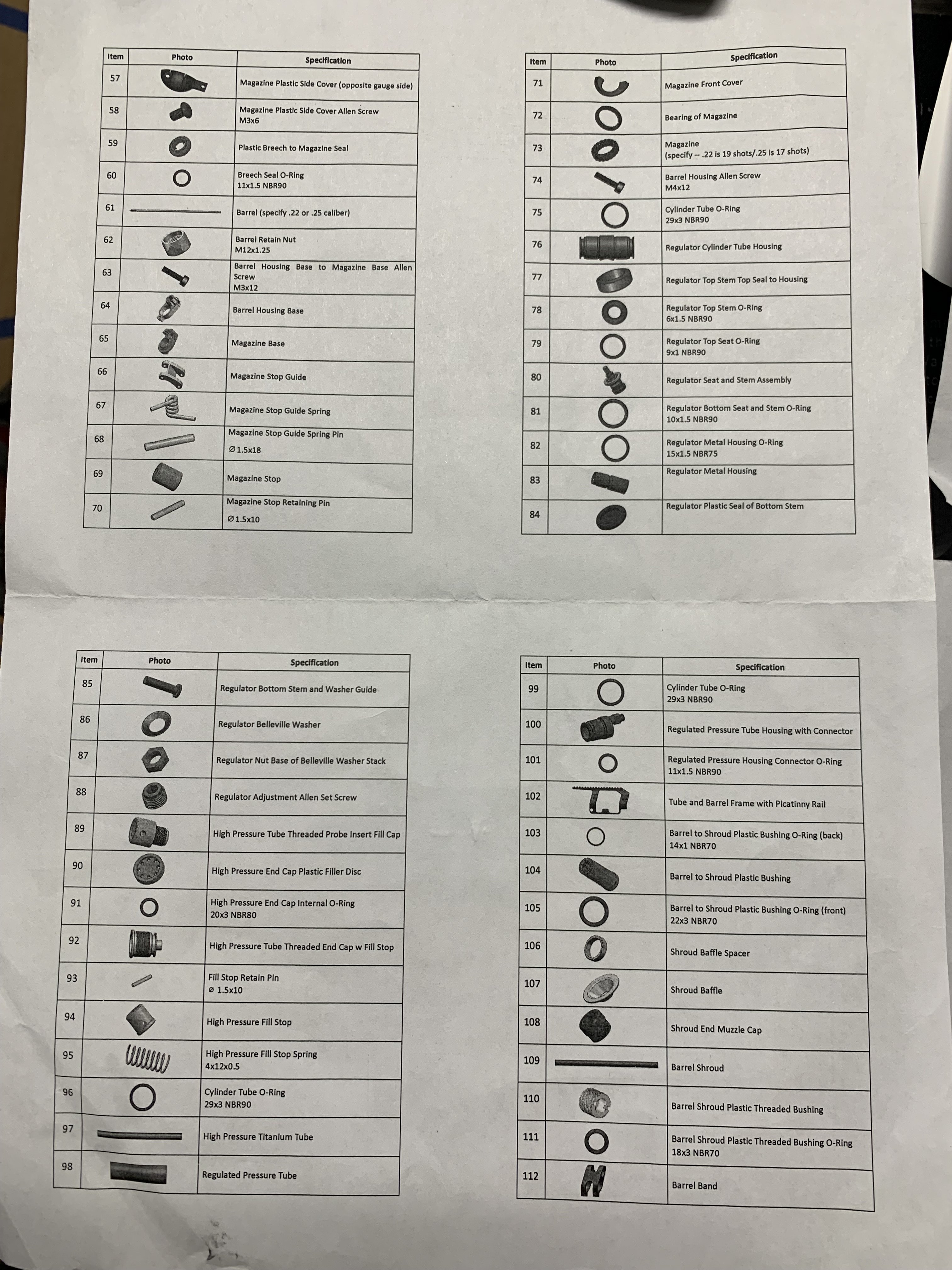

@JaceSpace1369 Which part # is the "top hat?" The only other time I've seen that term is in reference to a part in the Air Force Airgun system. I think it's a part of their valve system, but I'm Unser exactly what that is. Do you have a photo of that part in the Huben K1?
Part #80, kelly referred to it as a top hat
