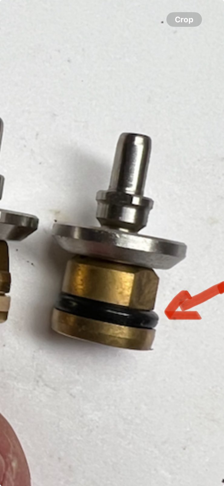

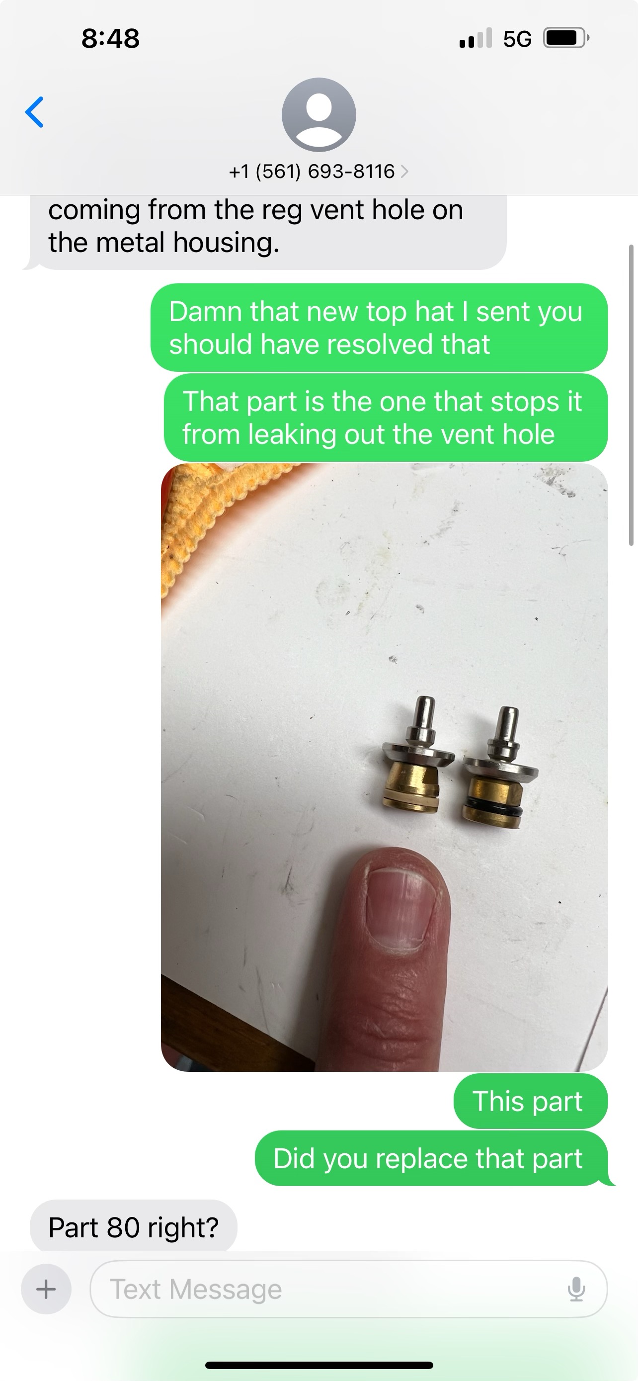

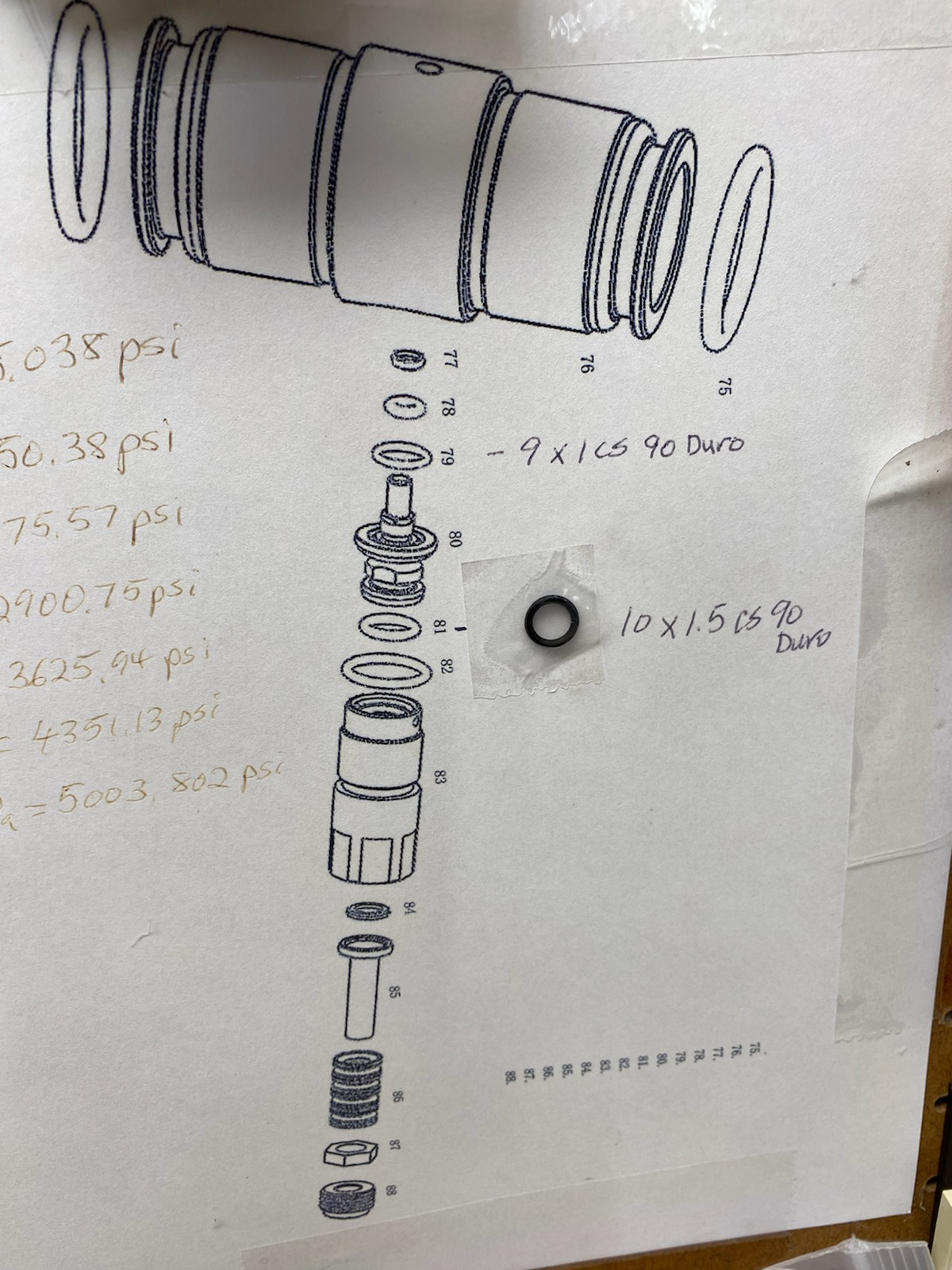

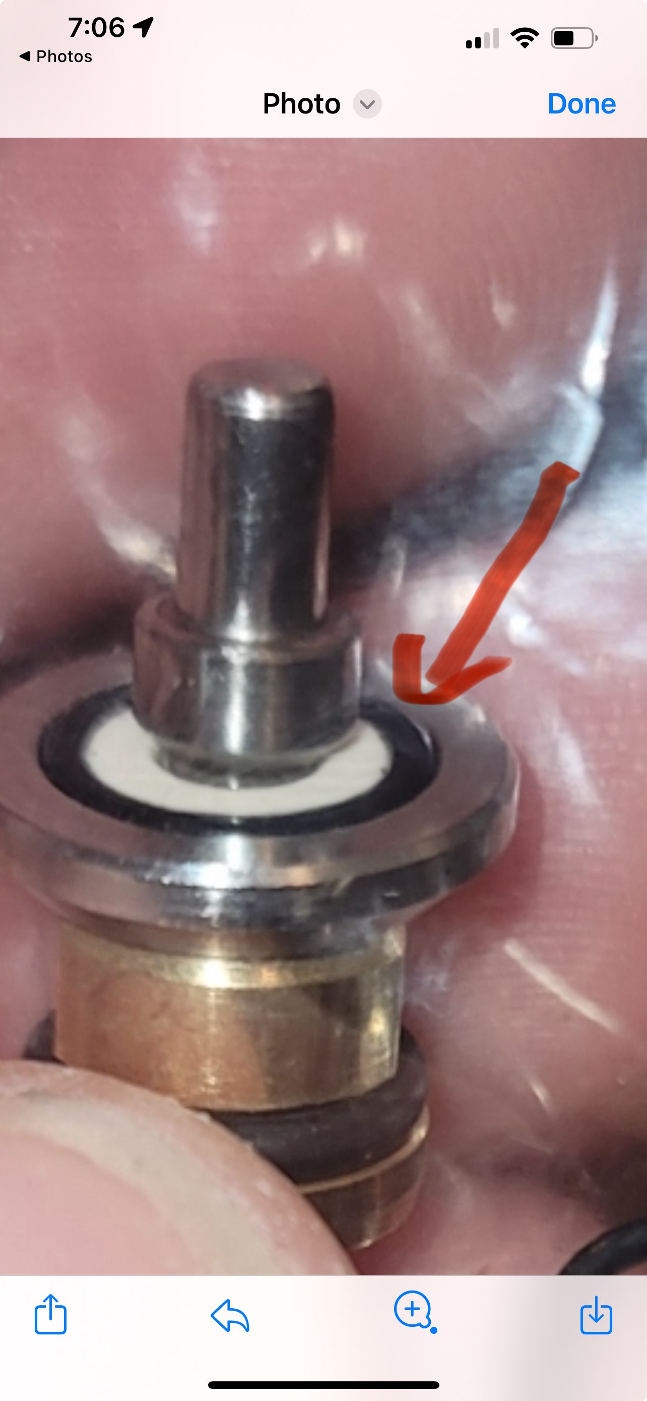

Before you decide to just rebuild the regulator or replace it. Look at your mow rings because you have several o-rings in that area. Yeah, including in the top hat, as well.
Reactions: daddypaddy
thanks! i’ll definitely get a good look at all of the o-rings. is that a replacement top hat? how does replacing o-rings help?
There's a possibility that it could, but i'm not going to directly say that it will as I am not entirely sure. I'm just saying make sure to check all the o-rings are good. As we know that any kind of oring damage or dry rotting will cause issues. I'll see about contacting kelly today to see if I can get any information for you.
