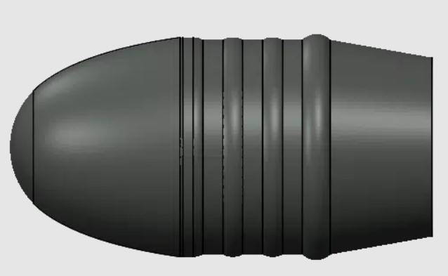

Huben used to sell ammo for it that looks like the one pictured below. I bought a mold from mpmolds but haven't cast any slugs yet to try them out. I know Altaros makes a similar slug but they don't ship to where I live so can't get them. Are you guys shooting slugs or pellets? What is your preferred ammo?
I have some of these if you want to try them. Pay the postage and they are yours. They shot well in my Hubens but are very hard and not great for hunting purposes.
@Jammin22 That member is in Sweden.
@MadCowCrazy2 The types of pellets that some of us are shooting were mentioned in various posts earlier in the thread. I have shot the boat tail slugs that look like what your MP mold produces. They load and shoot fine for me. Pellets or slugs shoot well for me. Mine is a 2020. I’m not sure if that makes a difference. What ammo I’m shooting depends upon what distance I’m shooting and what I’m shooting at. I suggest sticking with what works best out of your gun. Yes, changing out the loading gate helps. As can be seen in this thread, a magnetic loading gate can be affixed to a Huben K1. @Gregor has made some good Huben videos over the years. They’re definitely worth checking out if you encounter issues.

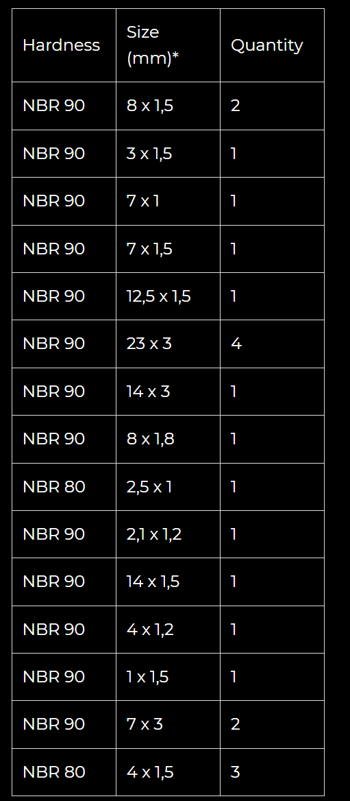

Also, I bought a bunch of o-rings from the oringstore. I now have enough o-rings to reseal this huben for the next 50 years. If you don’t want to buy a bunch of o-rings at the very least buy some gauge o-rings which are most likely to go first.
1.5mm x 1mm ID
@Legionaire I’m in the process of placing an order for o-rings. Can you post the sizes needed to reseal the Huben K1? I would appreciate it.
