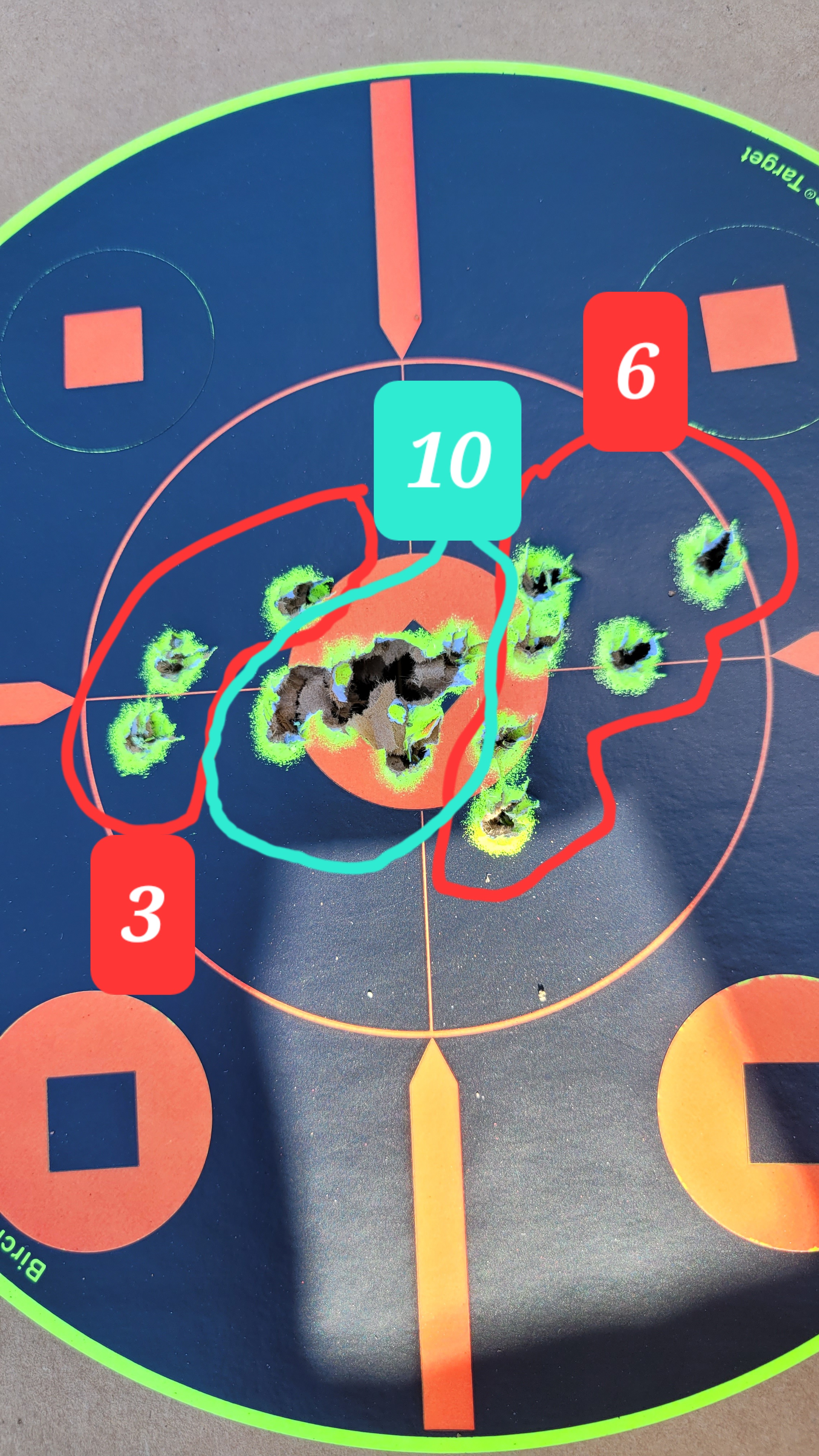

Maybe this is the issue I'm having.... my huben .25 is set at 14mpa which is 140 bar , was shooting around 920 fps , would watch them do hole in hole at 100y then fliers. Then do the dance all over again. I'm going to try n run it at 16 to 17mpa
Have you tried different speeds at 140?

This is what's happening pretty regularly
Reactions: Pale_Rider
Man that’s frustrating when you see it making a ragged hole and then fliers pop up. Do the fliers occur consecutively or do they happen randomly?
It is random.. I may get 3 or 4 in a hole and then 2 fly then a couple to few more in the hole then a flier or 3. I can't pin point it. I almost 💩 myself when I was same holing them .
Mine is a 2018 with the LW barrel and I shoot .25 heavies and it was doing the exact same thing. The problem was that the pellets were too loose in the magazine and the were getting blown backwards and when the mag rotated they were getting deformed. My fix was to flare the skirts on the pellets so the fit snug. Problem solved.

My magazine is very loose actually, it also doesn't appear to have any rifling in it like they should have ... mine appears to be 2020 model year

The rifling in the mag is pretty faint so it is hard to see especially if its leaded up a tad, i also had to line my mag up with the barrel its a rite PIA job but worth checking, i found that when you tighten the barrel it moves very slightly which then off sets it to mag you have to try to pre empt this it is trial and error…
Is the mag loose or are some pellets loose in the mag?
Pellets loose in the mag, I apologize for my poor choice of words.
It could be very well leaded up now, 3 tins since Sunday. I guess I've got a handful of things to try.
