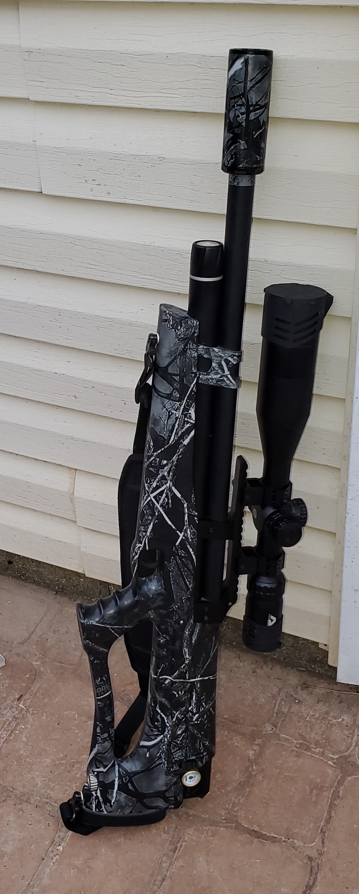

I’ll start with a photo of my 2020 Huben K1 .22 caliber with a Vector Veyron 4-16x44 FFP IR scope.

I have a couple of questions. Considering the weight of this gun, it gets heavy while carrying through the woods to hunt. I’ve got some holes in my synthetic stock but don’t what type of sling studs to use. I don’t want to mess up the stock.
1) Anyone know which type of sling studs are good to use?

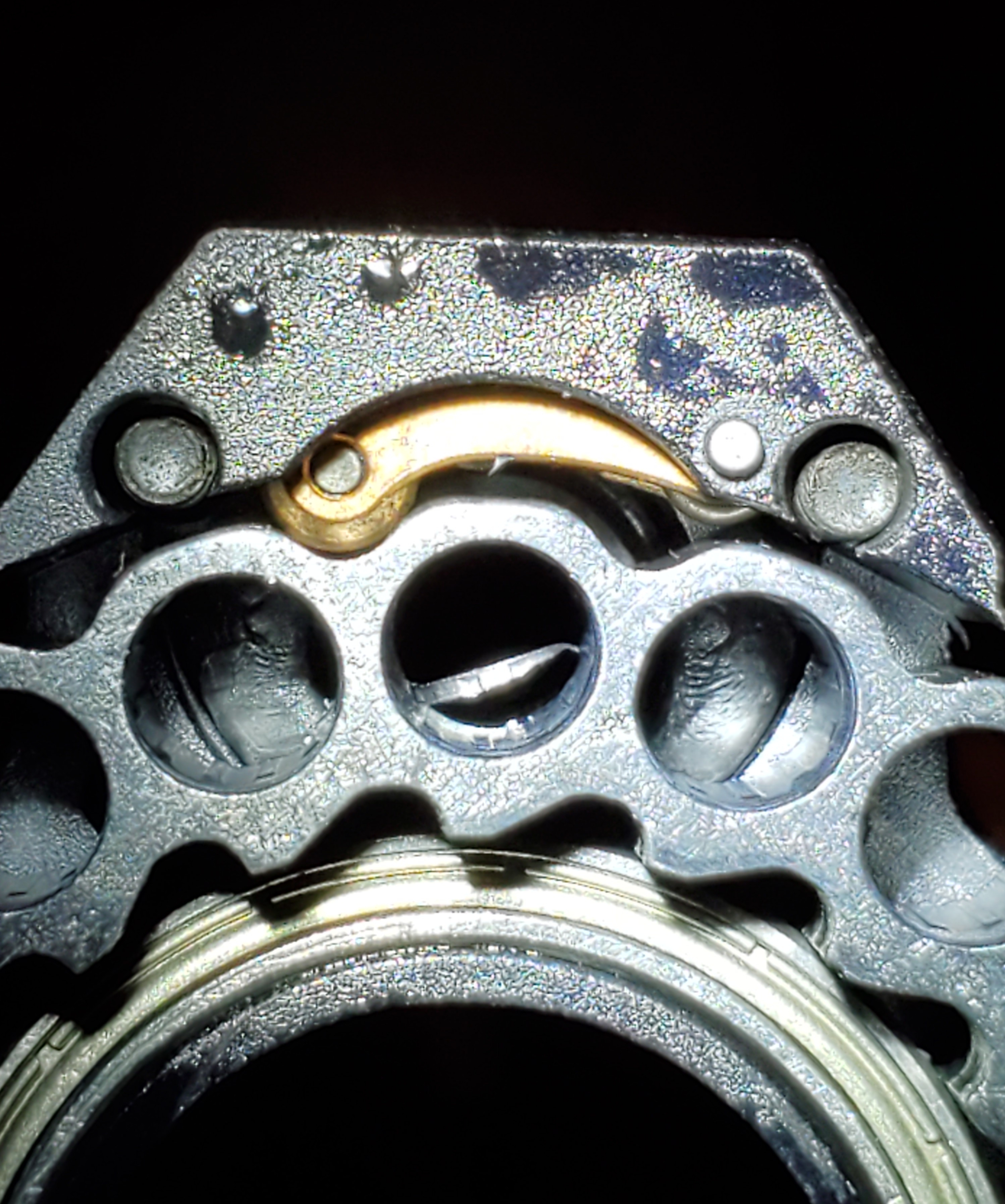

Here are some pics when the barrel isn't aligned correctly.. a friend brought me his gun and said it wasn't shooting very good
So I took it apart and thus us what I found.
