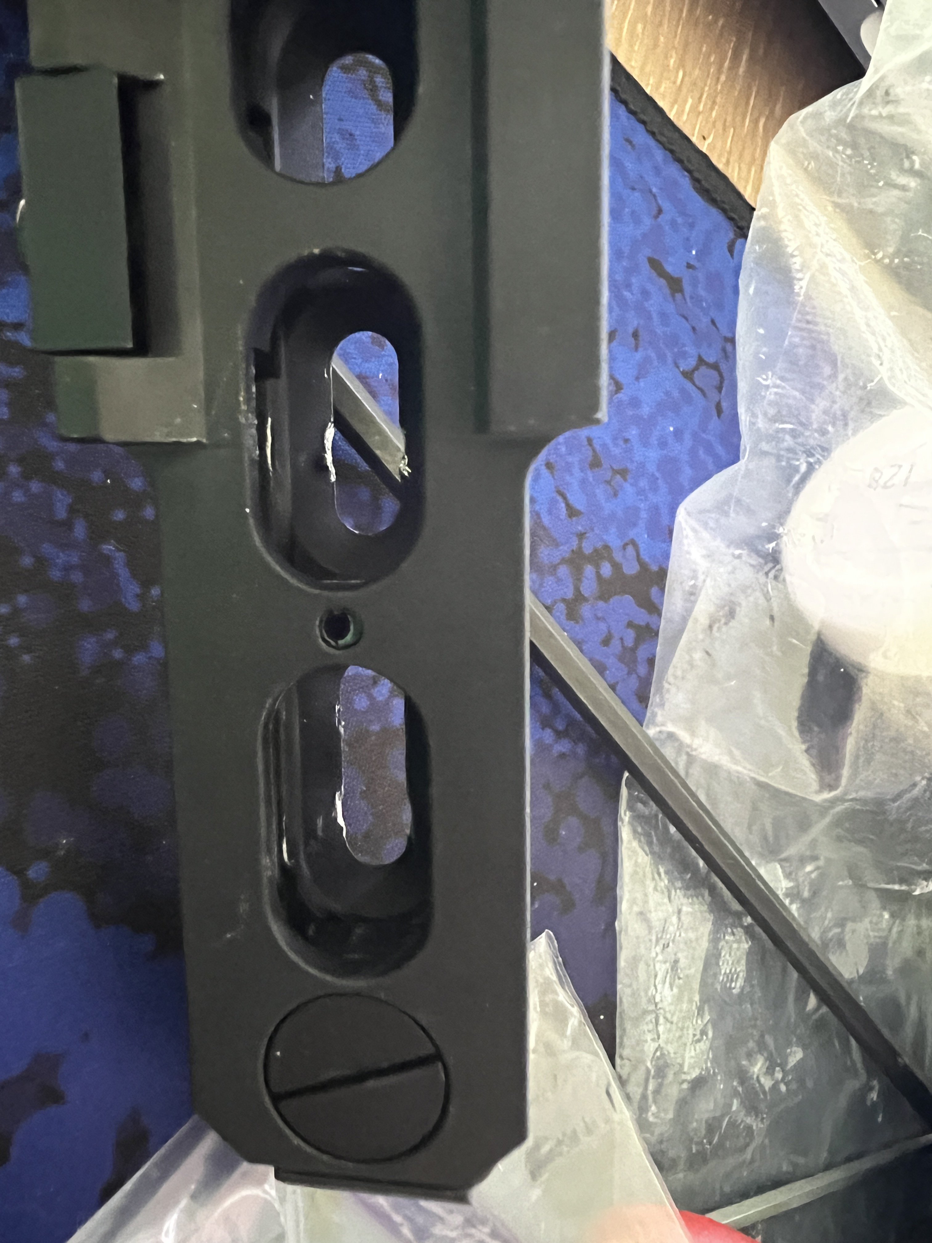

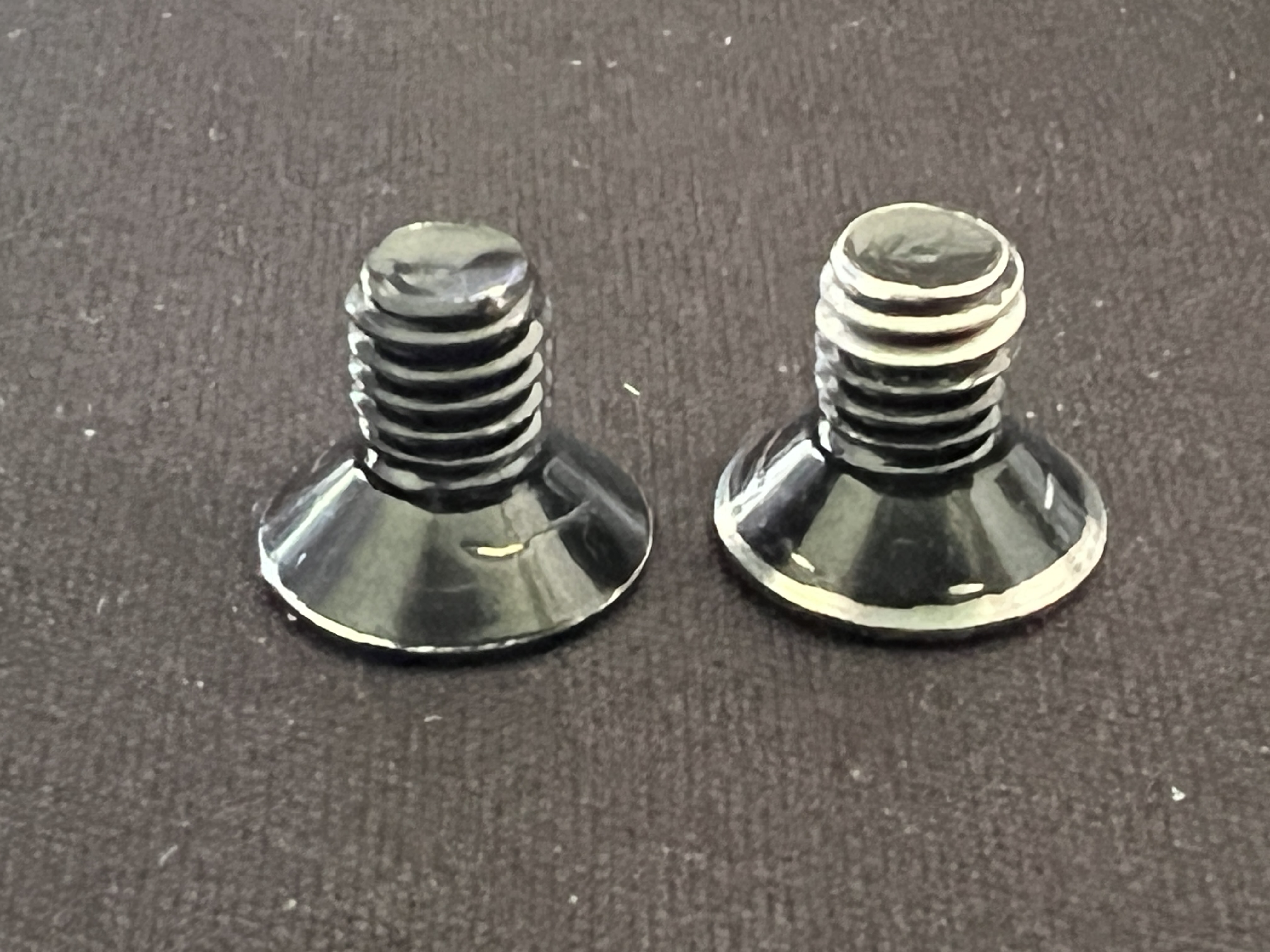

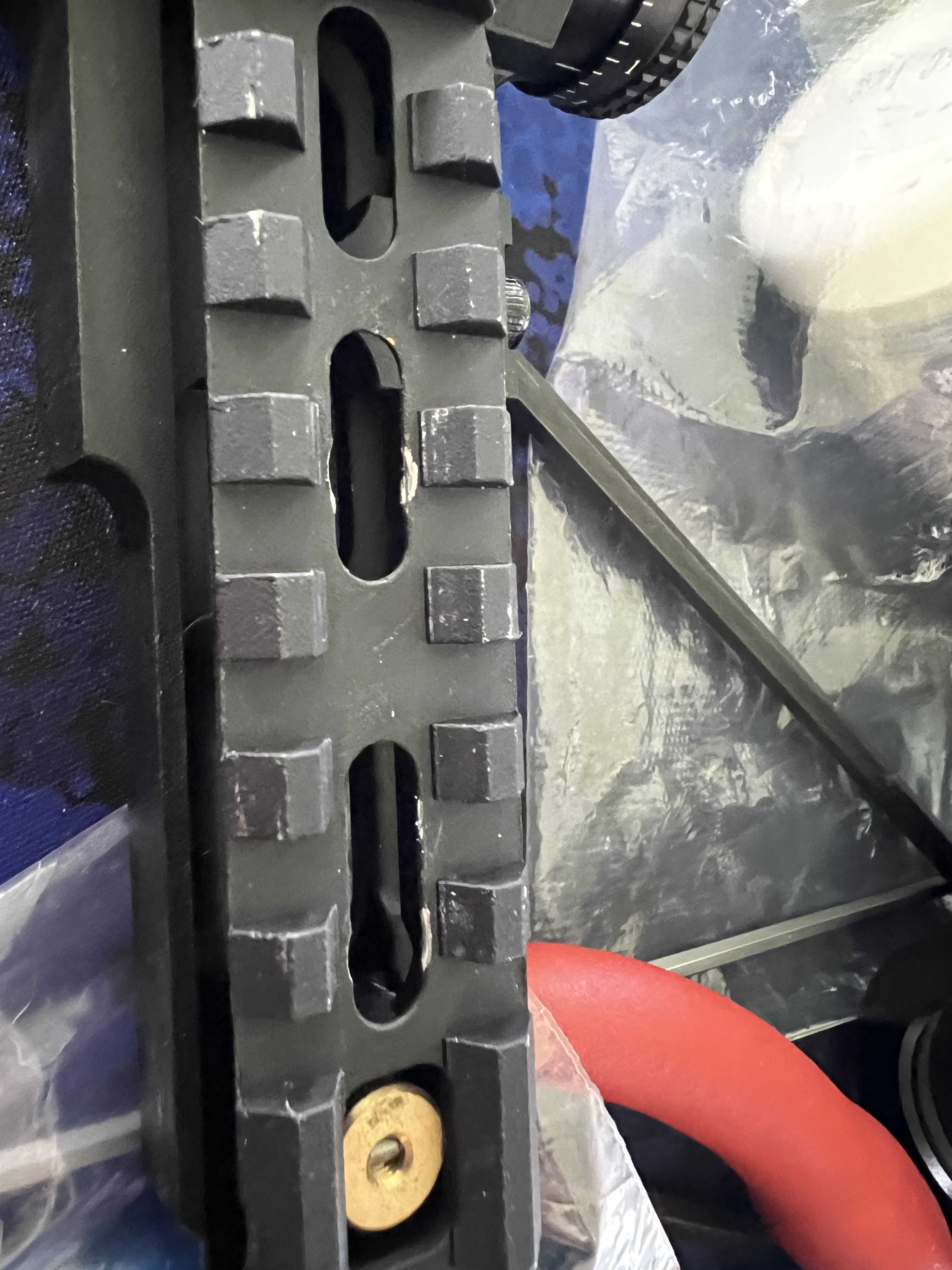

anyone know the size of the screw that mounts the pard. My zb lite universal ate it up. I thought it screwed directly into it ….
@PARD_Tech AGN member @Florida_Man needs a couple of mounting screws for his Pard NV008 unit. How can he obtain these screws? Where can he look to obtain the size of these screws? Does Pard have a parts list available for Pard owners or a place where we can buy spare screws, shims, battery compartment covers, mounts, throw levers, lens covers, eye cups, etc.?
Reactions: Florida_Man
