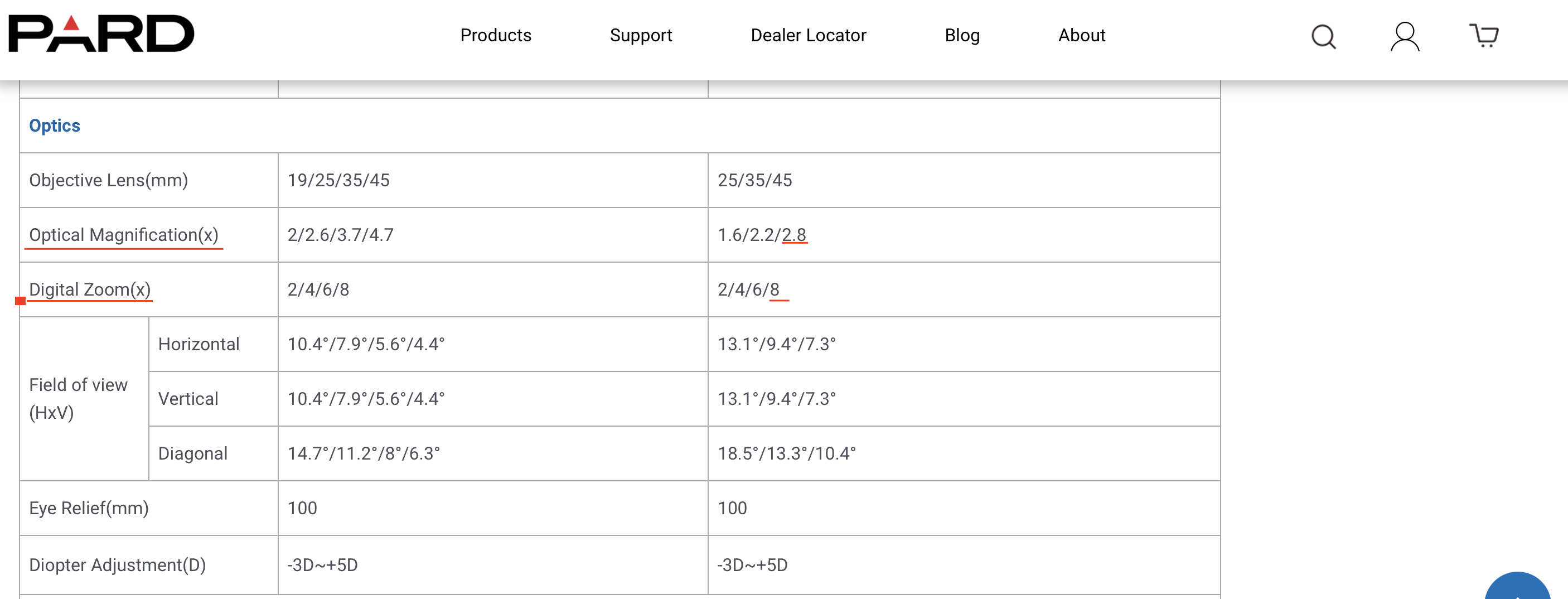

When customers get to the specs it gets confusing because optical zoom and digital zoom are both mentioned. After reading this it is unclear how each is used and if the maximum zoom is a combination of the maximum optical zoom multiplied by the maximum digital zoom. For example on the 45mm lens, does this mean the max magnification is 2.8 x 8 = 22.4x? Can you provide clarity here? Some people reading this thread no nothing about thermal and night vision and are learning from us. I think it is beneficial to all to explain things as thoroughly and concisely as possible.
