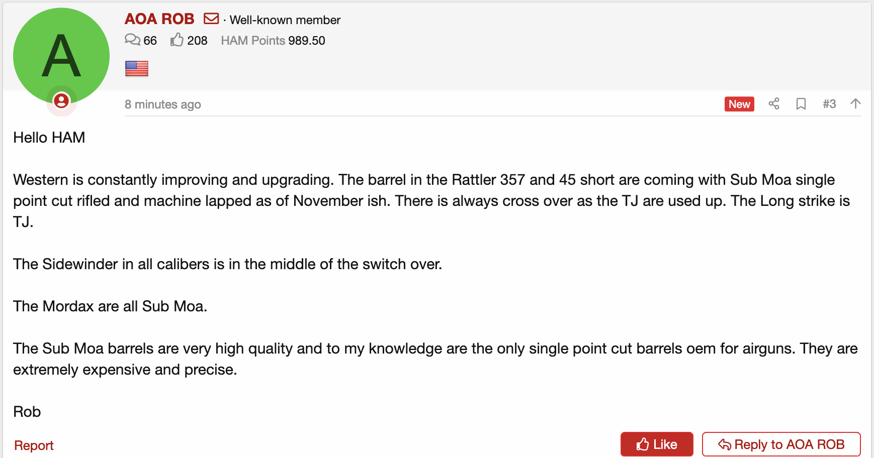

In regards to the Western barrels, Rob at AOA had this to say on 12/05/24
source of photo https://community.hardairmagazine.c...and-sidewinder-barrels-specs.3385/#post-39421

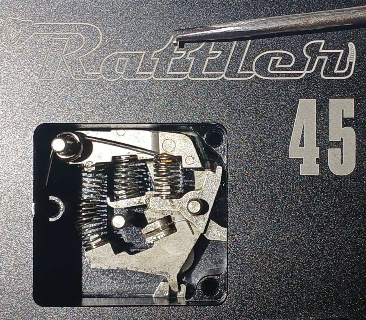

Here's a picture the inside workings of the Rattler 45, cleaned of excessive grease, and ready to be re-greased and assembled. The hook tool was made by filing a small screwdriver to the appropriate size and shape to get in and under the cover via the three screw holes to lift it off squarely.
Re-greased on all the sliding and wear surfaces, it travels back to it's second stage and breaks smooth, light, and predictable; like "glass" as they say.

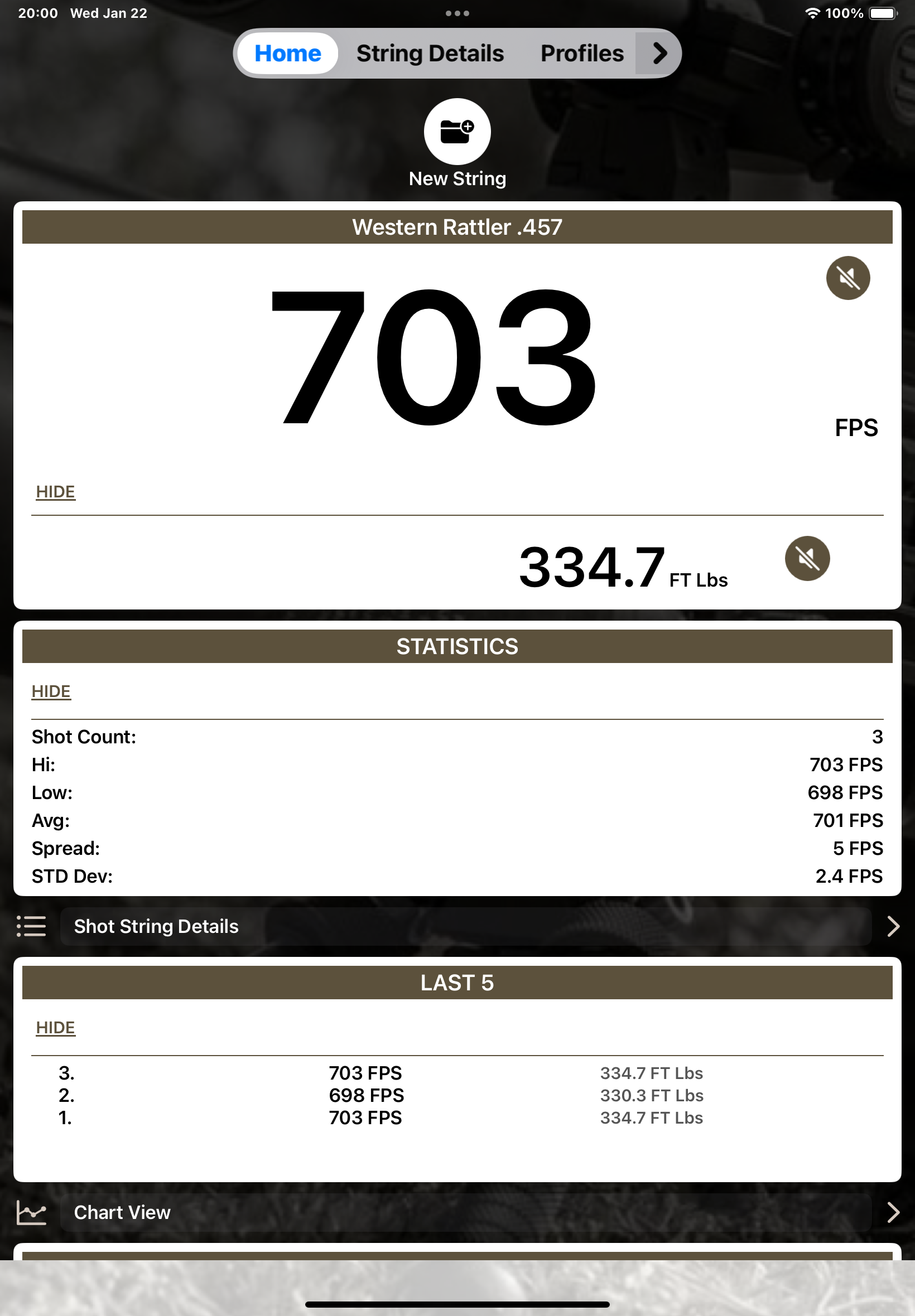

Couple three shots over the crono look promising as well as groups on paper. This is with the .457 305g HP Assassin PRO SLUG(now Molly’s lead shed). With a little more tuning tomorrow then it will be off to try out on a yote or two..
