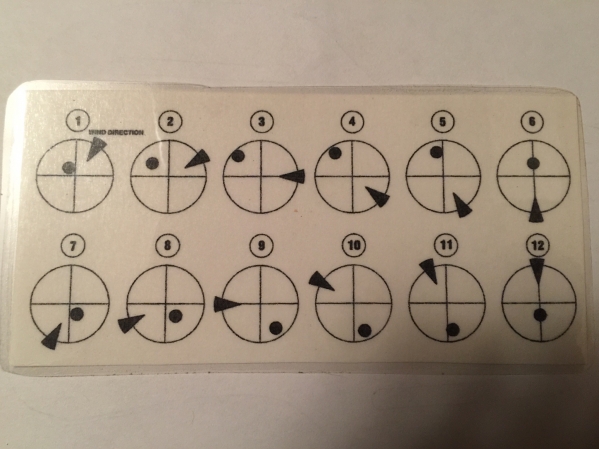

This is a chart that shows wind effect on poi for different directions of wind ( for right hand twist barrels). It’s a good rule of thumb to get a general idea of the effect wind has assuming it’s the same direction for the entire flight path, which it often isn’t. Of course nothing beats actual range time and getting to know your rifle and ammo. You’ll notice wind from the left forces the projectile to the right and also down due to the rotation. Wind from the right moves it left but also up as the rotation makes “ climb” or ride up on the air. The chart is pretty accurate but I’ve found a direct head or tailwind can sometimes have the opposite effect than the chart shows depending on the angle up or down of the shot. Hope this helps a little.
