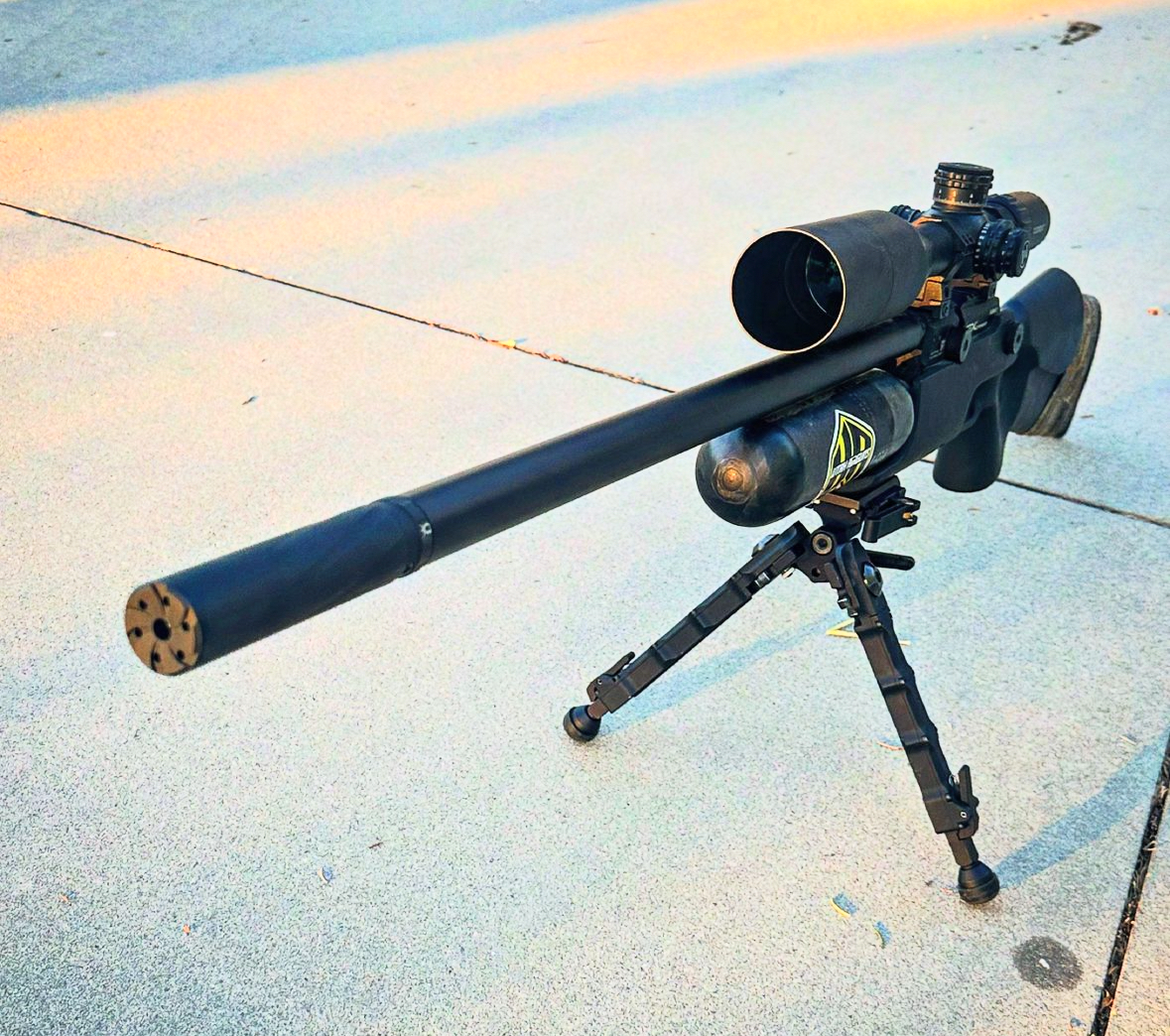

The slower the pellet, and more efficient the gun, the quieter things will be. This can be applied to nearly all air guns with reasonable barrel length, ie: 500mm or more.
Shooting 550-650 fps is incredibly quiet.
The more unreasonably long the moderator the even more 'suppressed' the muzzle noise will become, to the point you vaguely here it and the pellet smacking the target becomes predominant.
You shoot a pellet slow enough it'll sound like you threw it across the yard...

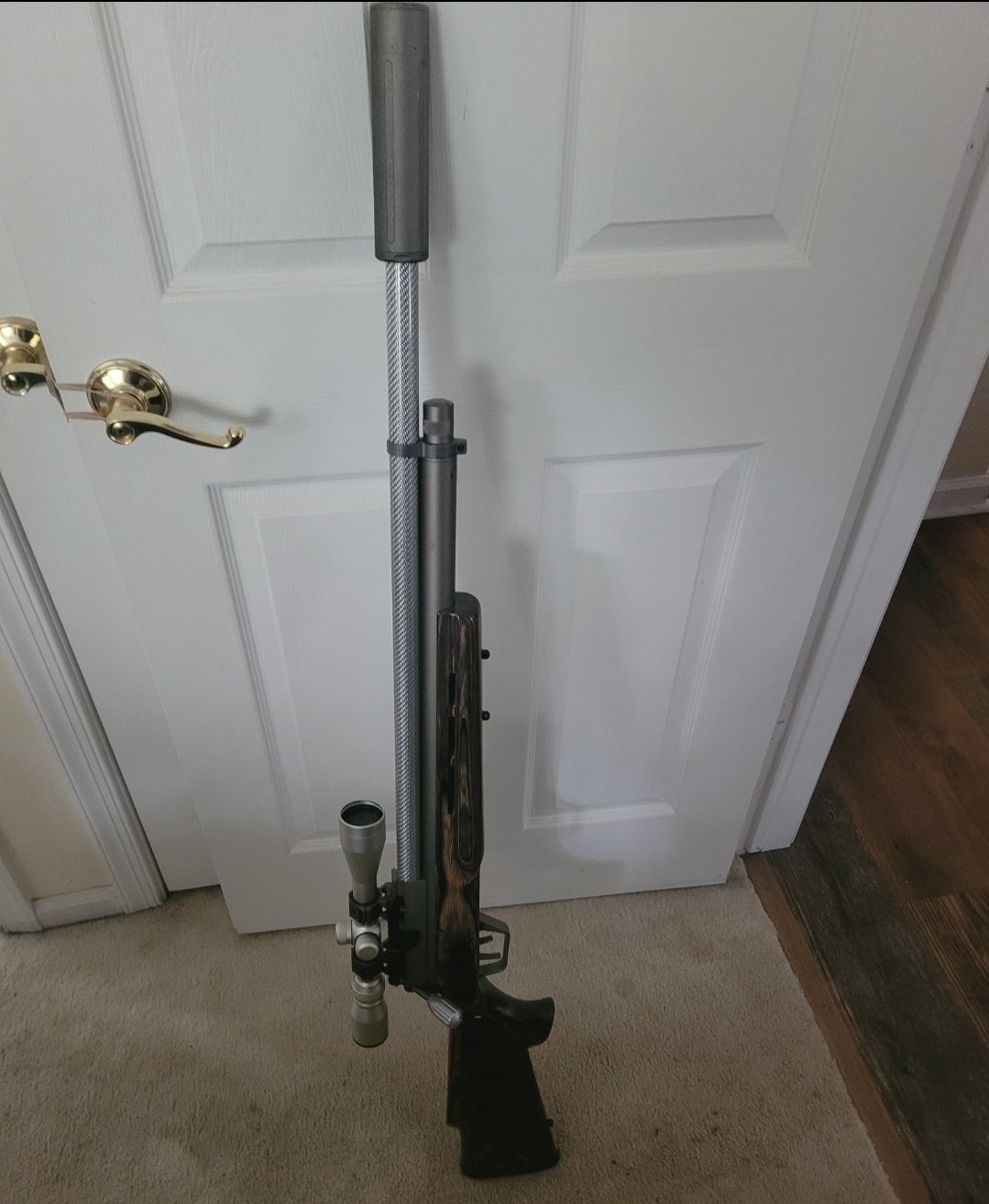

Noise within a regulated airguns action is basically determined by the force required to open the valve, so if you have a conventional valve, you'll likely here a ding from the hammer smacking the valve stem to unseat the poppet to get air flowing, even balanced valves require quite a bit of hammer and spring to actuate.
Needless to say no mechanical valve operates quieter than a pilot valve that runs on 3-4 grams of hammer and 3-4 lbs of hammer spring. While it doesn't contribute primarily to known 'gun shot' noises that may disturb neighbors, it certainly was always an issue for me until I arrived at this valve, which...if you think balanced valves are quiet or anything you shot has a quiet action that is not electronic, you're selling yourself short, and if you have shot an electronic rifle, pilot valve actions are basically that quiet, just...muzzle and pellet noise.
