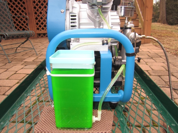

If some type of small fluid holding container is connected to the the coolant hoses, it allows all the air to be quickly purged from the cooling system and allows for heat expansion. This is what I did shortly after getting my Carette. Now if I need to drain and refill the cooling system, I just pour the coolant into the container, turn the machine on and tilt the machine slightly rearward. Within in a few seconds all the air in the system is purged into the container.
Thanks very much for the setup recommendation! Can you provide a link and/or description of the reservoir that you added? Nevermind, I see you already did!

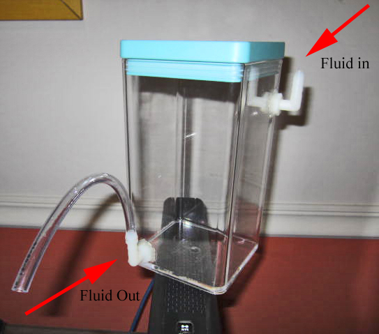

​Kudos to Azccj for his overflow catch can mod. A squeeze bottle removes most bubbles but being anal retentive I want no air in the cooling system. I made an economical overflow bottle that cost a total of $8 in parts. The clear tubing on a Carette is 3/16" ID x 5/16"OD. I bought 10' of tubing, two 90 degree nylon hose barb connectors, and a quart sized plastic storage container from the kitchen utensil section at Walmart. I drilled two half inch holes in the sides of the container, epoxied the hose barbs in place from the inside and attached 3/16" tubing to the 1/4" output barb by heating it with a hair dryer to fit. Coolant flows from the low pressure piston to the high side of the container and exits the bottom of the container. Gravity takes any air to the top of the container. Within a very short time all air is gone from the circulating coolant The container makes it easy to do a coolant change quickly and without a mess. No more squirt bottles or hypodermic injectors needed.
