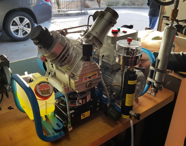

Here is a photo of DrippinLead's compressor with the coolant reservoir tank that we installed.
We were lucky that we caught the gauge issue before it reached the "4500" shut-off level or else our tank would have been filled to 5,000 psi.

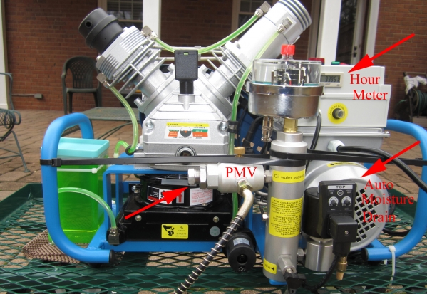

Your Carette appears to be the base model. I don't see the auto moisture dump or the PMV that comes on the higher priced model that Joe sells. The side of the switch box which is directly behind the pressure shutoff gauge in your photo is where the hourmeter is on the deluxe version of the Carette. The red arrow in the photo points to the hour meter. It also has a Pressure Maintaining Valve and Automatic Moisture Drain which are both labeled.

I have a question and observation regarding your overflow tank. The hose running to the input of the overflow tank should flow in near the top of the tank. The water coming out of the overflow tank should have the outflow hose drawing water from the bottom of the tank. Gravity will quickly remove all the bubbles from the system. I see air in your output line. Once air is out of the system that has been run the lines should not have any air pockets in them even when your compressor is turned off.

You are very observant humdinger. The picture my brother took was before we started the unit and did have air in the tube at the time of the photo. Before we started the unit we filled the lines with antifreeze and with in a very short time of starting the unit we had zero air in the lines. We were very happy how the coolant tank was working. Also very happy with the sound level of the unit! It is a nice feeling knowing that I will always have air when I need it.

"Humdinger"I have a question and observation regarding your overflow tank. The hose running to the input of the overflow tank should flow in near the top of the tank. The water coming out of the overflow tank should have the outflow hose drawing water from the bottom of the tank. Gravity will quickly remove all the bubbles from the system. I see air in your output line. Once air is out of the system that has been run the lines should not have any air pockets in them even when your compressor is turned off.
Both tank input hose (output from compressor) and tank output hose (input to radiator) enter the tank from holes drilled in the top. Both hose ends are submerged and are at the bottom of the tank. We had two reasons for submerging the tank input hose: 1) to prevent air from entering the hose when the unit is turned off which would allow some of the fluid to drain; 2) to reduce air bubbles getting mixed in with the fluid inside the tank due to agitation at the surface as fluid is pumped into the tank. Since the radiator pump sucks the fluid out of the tank and doesn't rely on gravity, we could insert the hoses at the top of the tank, making it much simpler. We won't have any leaks at the bottom and we didn't need any fittings.
My brother explained that the photo was taken before we "primed the pump" and started the unit. I do have a video of the actual startup. The fluid was milky for several minutes due to all the bubbles. Once that cleared up, you can't tell that the fluid is moving because there are absolutely no bubbles. You have to open the lid on the tank to see that it is indeed flowing.
Bubbles in the coolant lines may not affect the performance of the unit, but removing them satisfies my OCD tendencies.

Good to hear that they are sending you a replacement gauge. I hadn't seen the Alpha filter when I previously looked at your photos. It is puzzling that you were sent a top of the line Alpha filter but not the full feature Carette. You don't need the factory PMV since the Alpha filter has one, but the auto drain and hour meter are useful features that you should have gotten with your order unless you opted for the base model.
As long as your overflow tank is functioning as you intend then it doesn't matter where the hoses are positioned. I'm just like you in being OCD about having no air bubbles in the cooling system. It is reassuring to see only coolant in the lines with no bubbles circulating. I just made an improved tank with hose barb connectors.. I enjoy Rube Goldberging equipment for better performance. The aluminum catch can in this thread is nice but a one quart clear plastic container costs $2 from Walmart. It will be easy to fill and service and it looks better than the smaller one I use now. I drilled 1/2" holes in opposite sides then epoxied the hose barbs in place. Gravity and the compressor pump removes all air from the cooling system in less than a minute of run time.
I like that container. If we had the hose barbs, we may have done ours differently.
