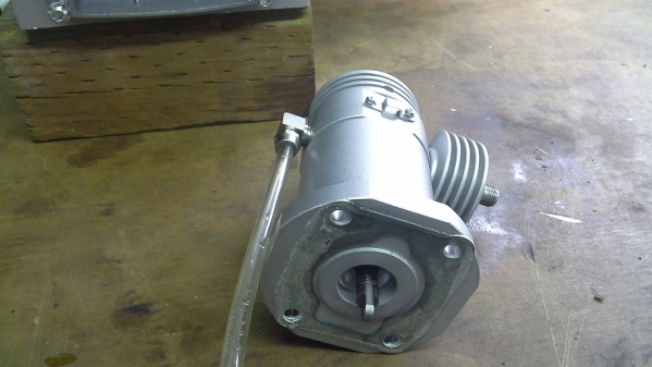

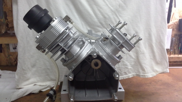

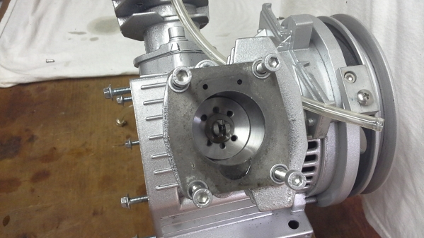

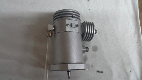

Tore it down today and the secondary high pressure side is froze solid. Had to pull the wrist pin just to remove the head because the piston can't be removed.
Joe says he'll take care of me will see.
12gauge, if you study this video you will see how easy it is to remove that frozen piston yourself. In your photos you have not removed the cooling fins. It just takes an allen wrench in the hole that holds a pressure set screw. Underneath is the cap that holds the pieces that make up the high pressure check valve. Once you remove them from the upper side of the high pressure piston all you would need to do is take a wooden dowel rod and tap out the piston from it's outer sleeve. It is hard to pull out from the bottom if it is frozen but it would be easy to tap out from the top if you have the entire assembly on a suppot with an opening to allow the piston to be tapped out. If you also tap out the outer sleeve I would then clean them with 0000 steel wool and lubricate the piston and sleeve before reassembly. If the piston is frozen I'd also make sure the upper check valve assembly is also cleaned and lubricated. This video will show you the steps. You've already done half of it already. Hope this helps. Keep us posted on your progress.
https://youtu.be/Q6pxOBwMISg
I'd first of all like to thank all of you for your support, you guys are great !
To answer some of your questions I received a replacement high pressure cylinder and piston from Joe at the beginning of the week. He charged me $70.00 to my door. Was told it was a new pull off although it had antifreeze dripping of it but looked new? I ran it just to build pressure and seems to work fine although no tanks have been filled yet. I was able to remove the piston from the old head after watching a video that Humdinger sent me ( thank you ) . After some some "persuading" the piston came out and what i found was galling had occurred causing the piston seizure. It's my opinion that there isn't enough oil getting to the top of the high pressure side.

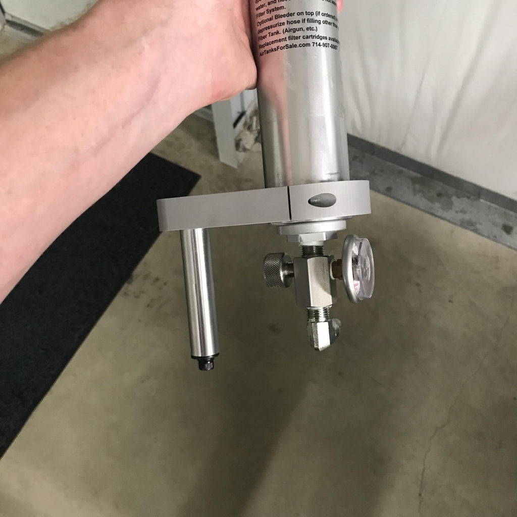

The only minor issue I have is the mounting of the Alpha filter assembly. I'll come up with something other than a couple zip ties, but in Joe's defense I'm sure he agrees and is probably working on having a proper mount manufactured.

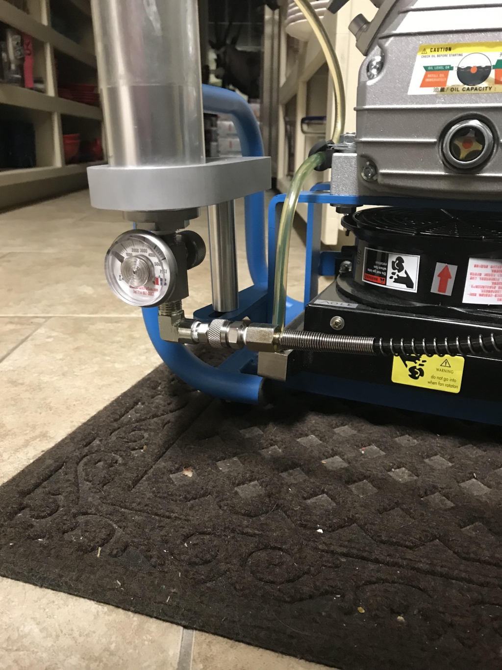

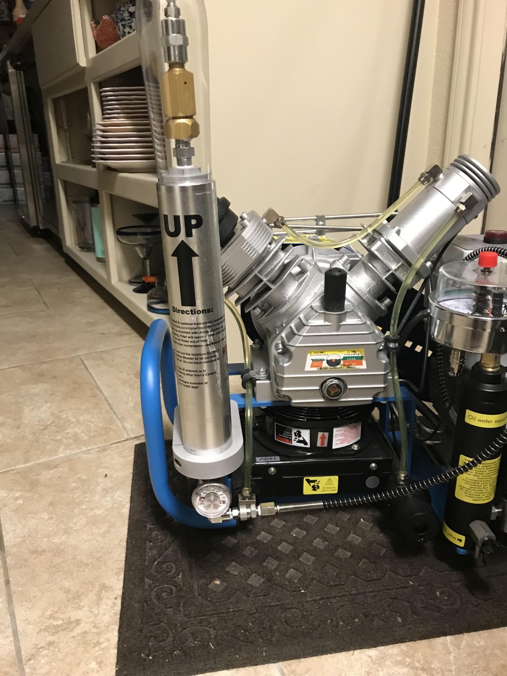

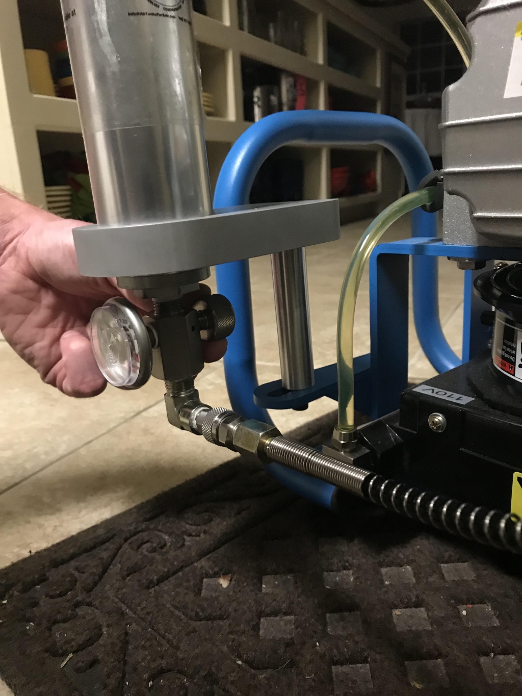

Here is what I did for mine.
