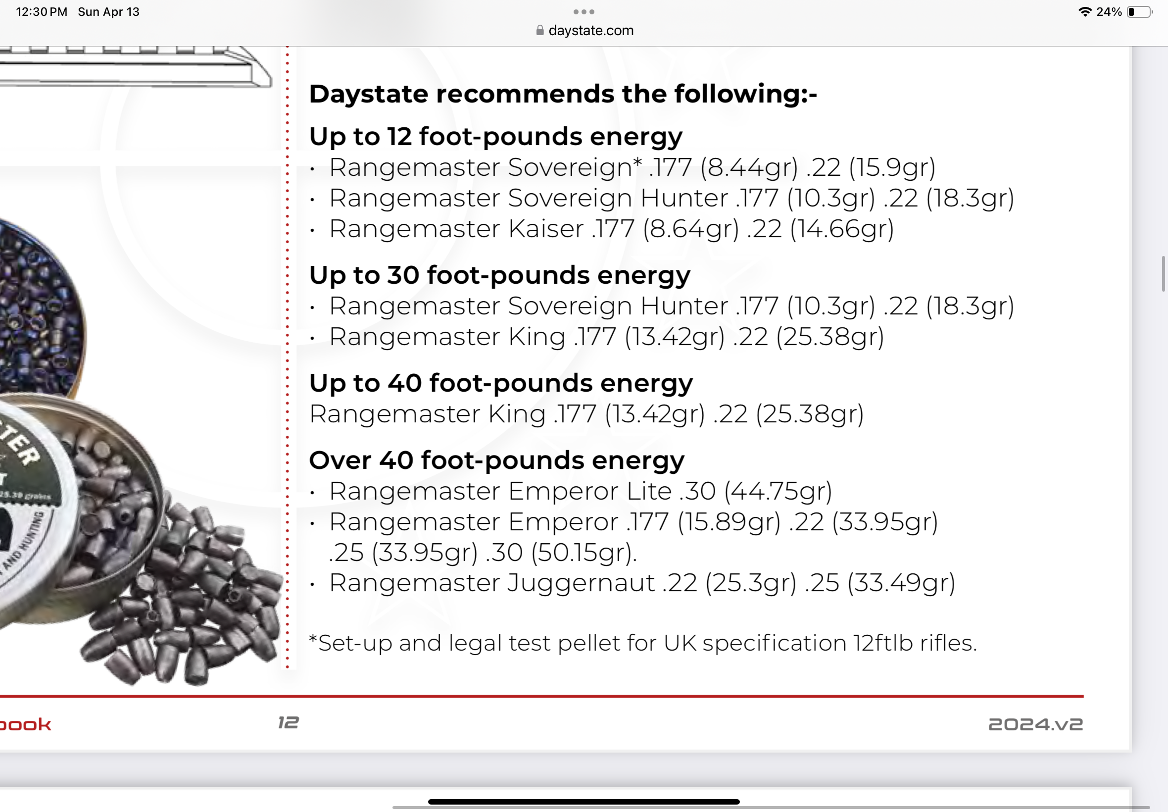

I purchased an Alpha Wolf Safari HP in .177.
The manual recommends 10.3gn Sovereign pellets up to 30ft pounds.Youd think that as this is the recommended pellet Daystate would have included that weight pellet as an option in the factory settings on the rifle. Instead my rifle only lists 13.4 and 15.89.

Not a single pic in this whole post...
What would like a pic of? The owners manual recommending the 10.3 gr pellet?
