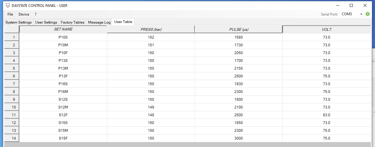

I'd also like to share my User Settings for others in case they might find this helpful.
To read the chart:
P = Pellet
S = Slug
10 = 10.34gr
13 = 13.43gr
16 = 16.2 gr
12 = 12.5gr slug
15 = 15gr slug
S, M, F = slow, medium, fast.
Now I set these up within the first few days of owning the rifle. When I did this S = 700 fps, M = 800 fps and F = 900-950 fps. There does seem to be a break in as the reg is still accurate to what it was set for but the speeds have slowly bumped up to around S = 740 and M = 860. I'll have to tweak the settings a bit.

I got in the 13gr KnockOuts and they are running okay but not great. I don't have a profile specific to them but running them in a few other profiles with speeds in the 895-900 range and up around 940 did not produce great results. I'm going to tweak a profile to get to 920 fps - maybe that is the sweet spot for these.
To read the chart:
P = Pellet
S = Slug
10 = 10.34gr
13 = 13.43gr
16 = 16.2 gr
12 = 12.5gr slug
15 = 15gr slug
Wow, that is awesome, is that Daystate Control Panel available with the daystate dongle for computer plug in? I do not have that yet as I dont even have a computer but this would make things much easier to look at verse writing everything down. Lol I know, I am slacking.
