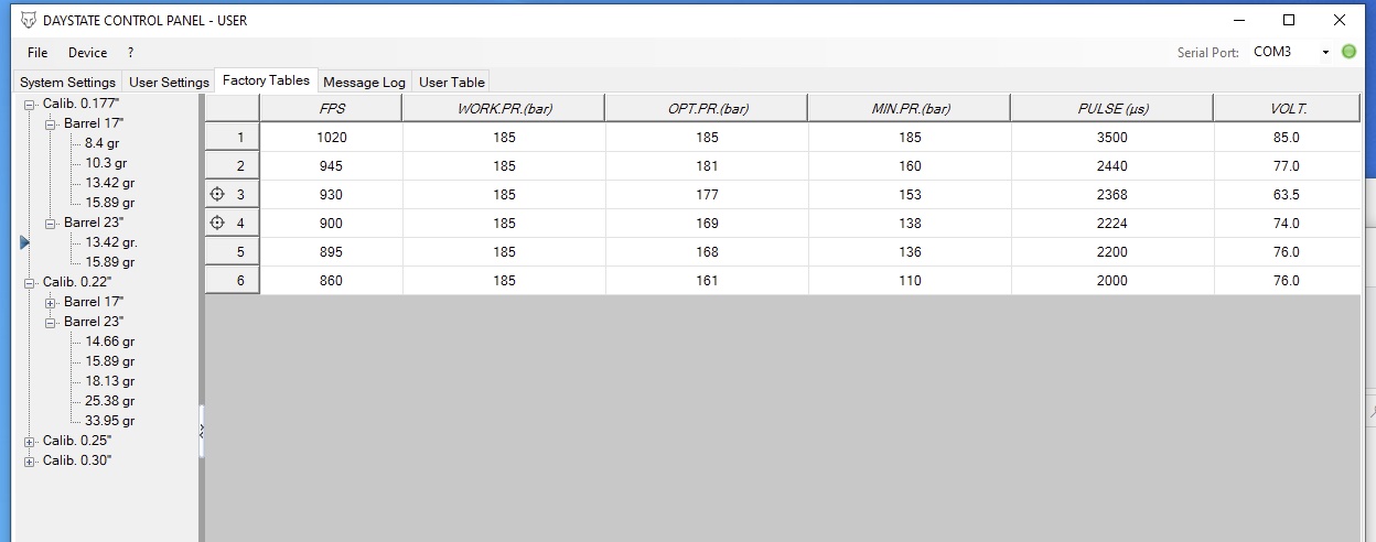

Yeah man - that's the Daystate Control Panel app. Very cool for tuning as you can simply update a cell, write it to the rifle and then select that profile an immediately see the results. No back and forth into the small screen on the side of the rifle unless you're out in the field.
Looks like this is a must have for me than, thanks for that!
Here is the Factory Setting for a 23" .177 barrel with 13gr.
If anyone is interested in the Factory Settings for other setups let me know and I'll post them up.
