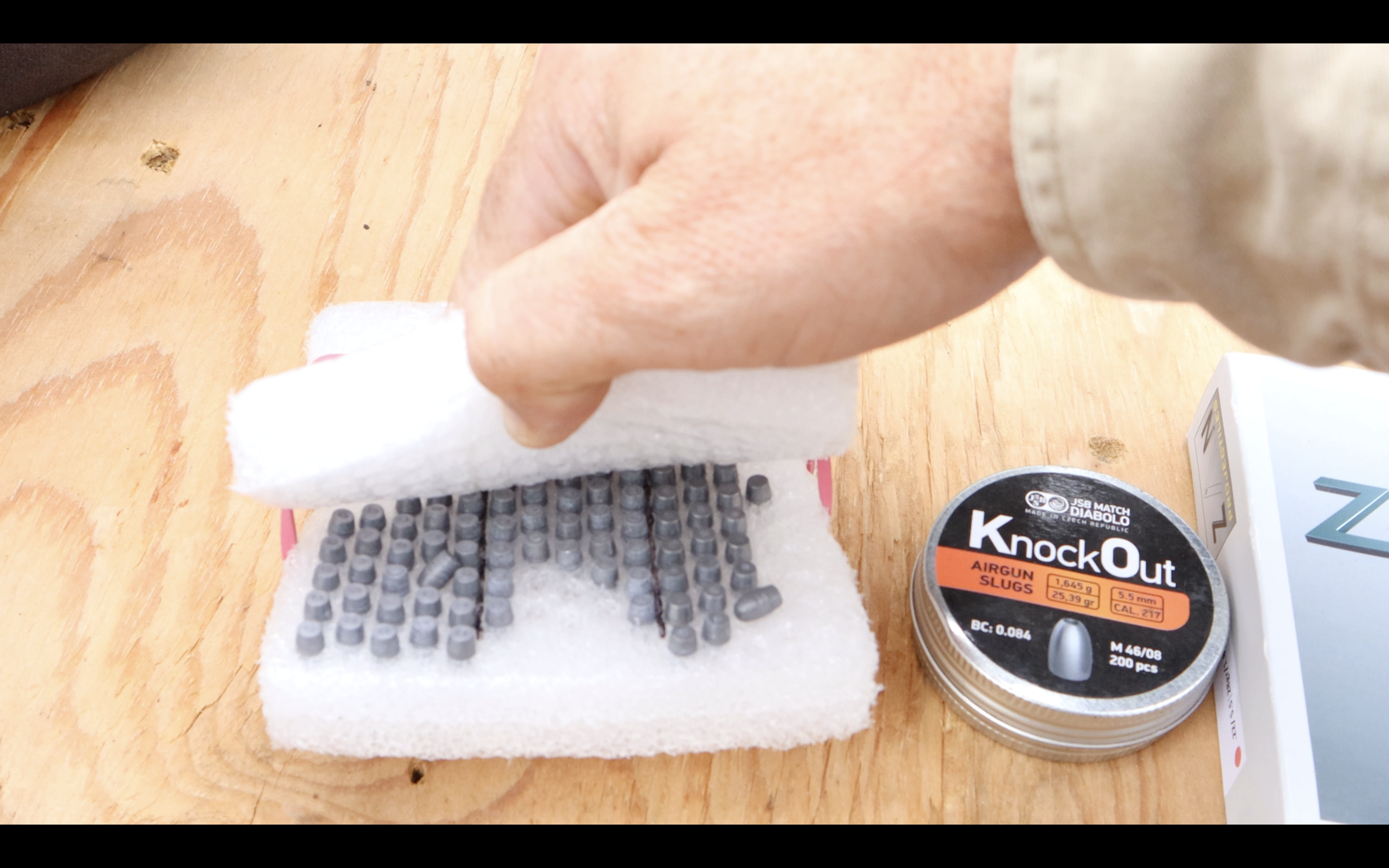

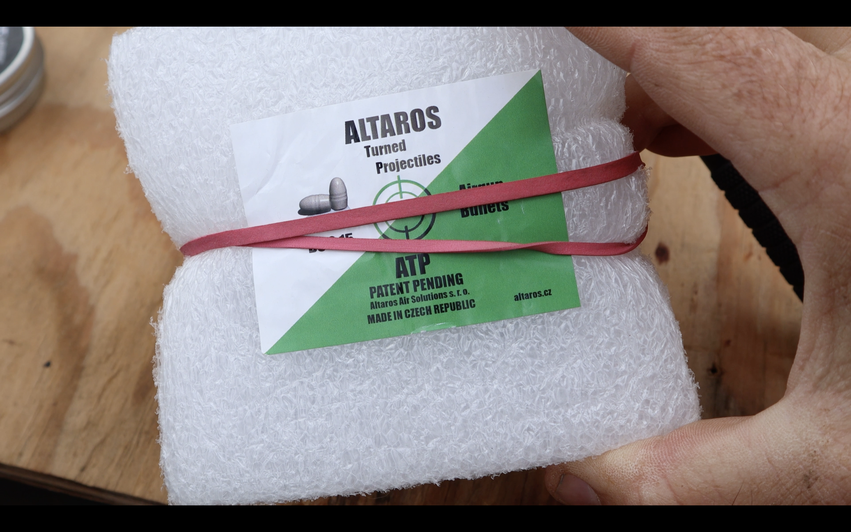

Okay guys...as promised here is a video on the Altaros slugs. I never white coat stuff so while we were shooting various airguns, pellets, and slugs, we decided to do a quick test of the 31gr Altaros slugs out of @intenseaty22 RTI Prophet (he did the shooting) with our friend Richard spotting. The distance was ~60 yards. We had on hand an @orion magazine and so loaded up back to back with JSB KnockOuts and Daystate Howlers the first round, and then the second round a different diameter Altaros, JSB KnockOut, and Zan. The results are real world ones. This Prophet had just used for EBR last month.
