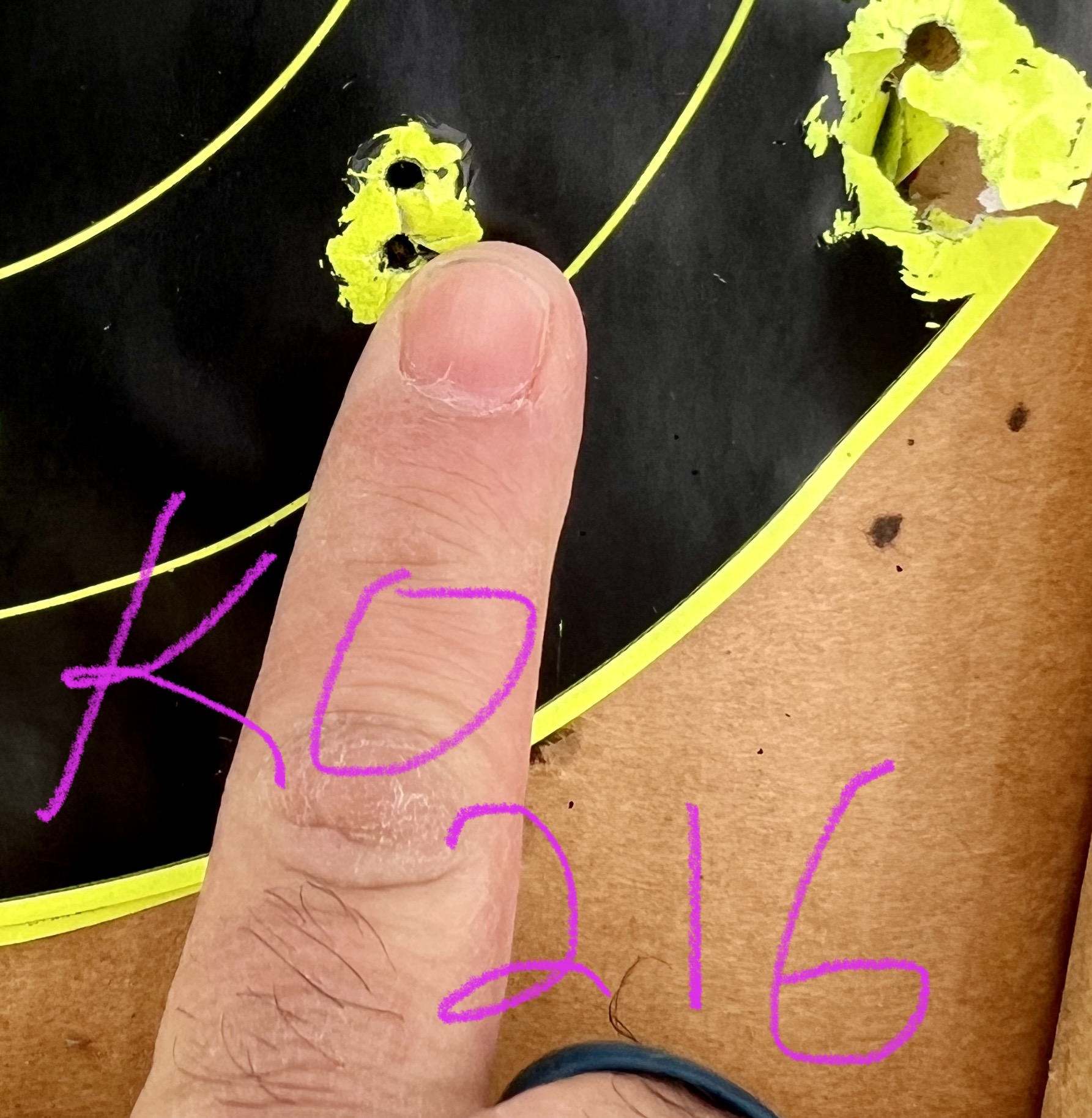

I did a little testing today at 22 yards. Just to see at that distance what would happen. Yes, I understand that this isn’t a slug barrel. But results are results either way.
So, the Knock Outs almost got into the same hole. The Altaros are 3 different sizes and I don’t recall them, but I did from Right to Left 3 of each.
The only of the Altaros that this barrel almost liked was the ones on the right. The Howler and Zan grouped decently as well.
Will try to test again, may up the power a bit. This tune has the 25gr RDs going out at just over 950fps

Also I could be incorrect but I think left to right it was 5.48, 5.49, and 5.5 on the diameters

This test of yours has no value if the barrel is not standard (1:17")
This thing about the test not having any value is what keeps me scratching my head. I mean, I guess I understand that that twist rate is what slugs require, or perhaps not always. Perhaps there is something to be learned, even from someone with little knowledge of the subject matter, someone that said, Hell, why not?! Yeah, I think I will shoot slugs out of a Springer!!
Go ahead and jump to 1:18 so I don’t bore you to death.
