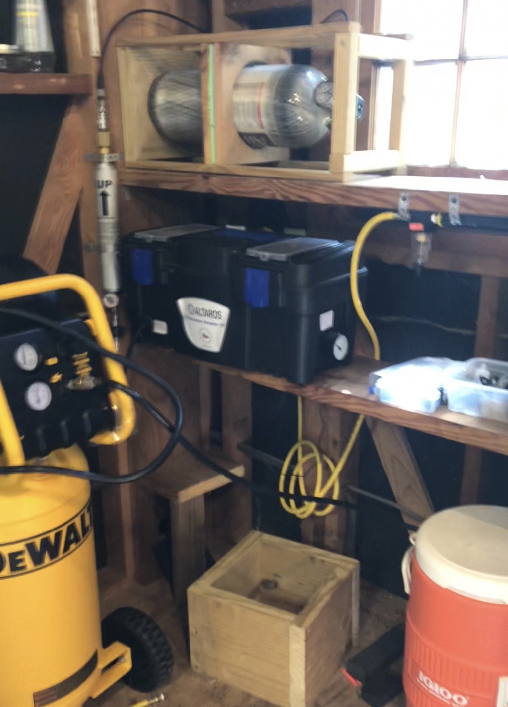

Lots of great info here. Gonna have to take some time and check out all the videos. I have had mine for a while now. No complaints so far. Wish I had the “upscale version” but I got mine barely used from a member here at a good price. As I understand they are practically the same, so... Here’s my setup, it’s not perfect, but works for me:
