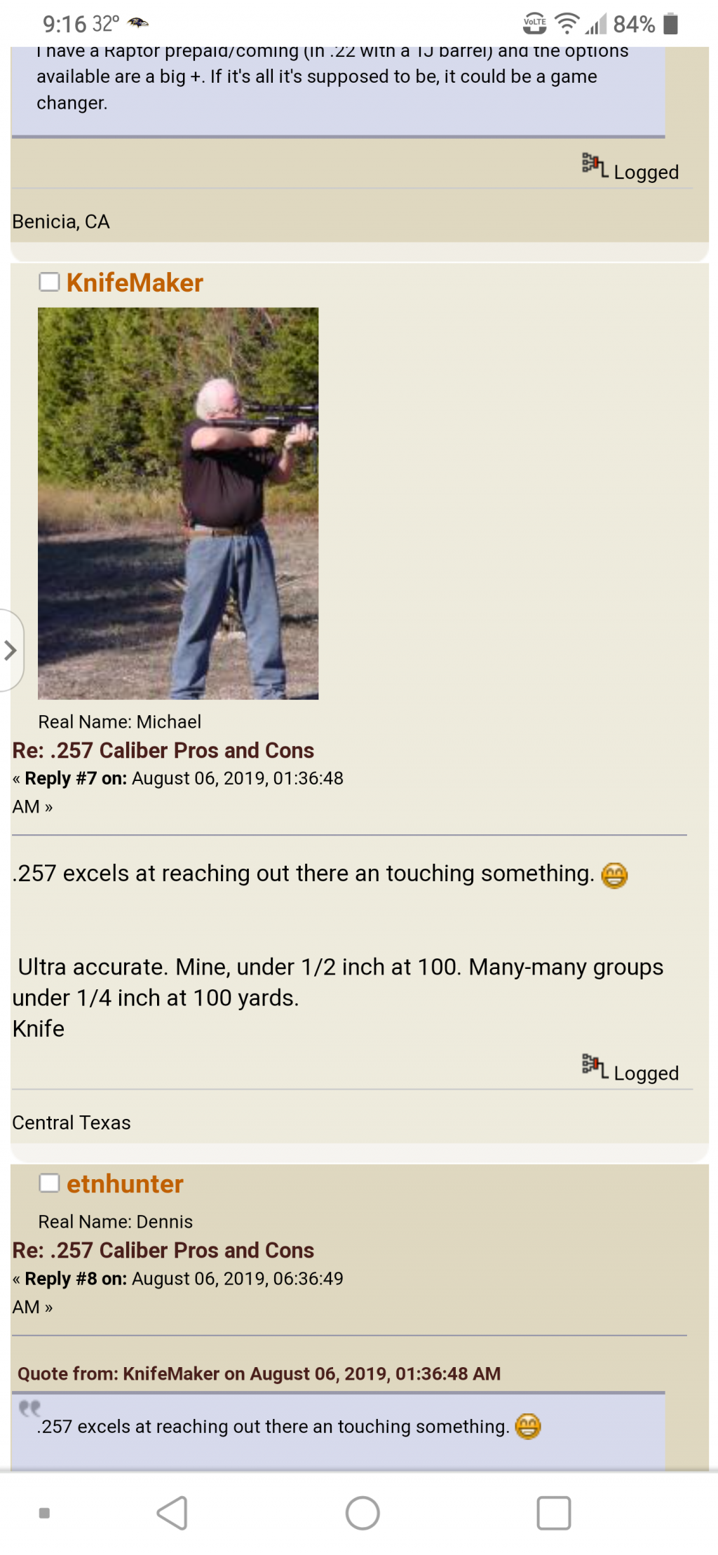

Factory accuracy , we need to get Knifemaker in on this conversation . A 1/4" @ 100 yds got my attention.
