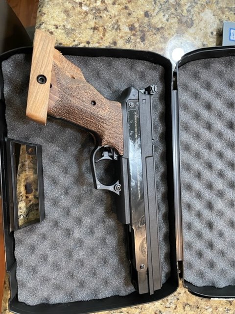

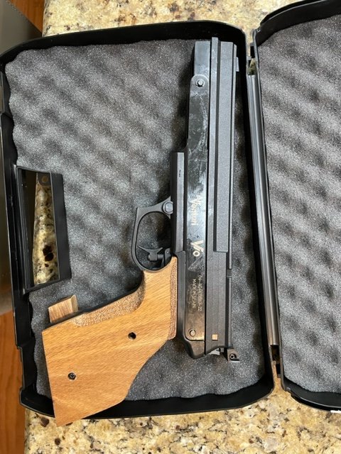

I got an Air Venturi V10 yesterday and I am very happy with it but the stocks need to be altered a bit to fit my hand. Specifically, I need to reduce the angle and height of the thumb rest. I thought I could just use sandpaper and carefully remove small amounts, check frequently, and arrive at a good shape. But I am not handy at all, and certainly not any kind of wood craftsman so I figured a google research would give me videos and articles on how to do this but I could not find any.
What I did find was articles on how to make grips and the tools and skills involved make it obvious that such a task would be way over my head. It also appeared that sending them to a craftsman to shape would probably cost more than the pistol. Can anyone give me any advice on this, or link to a video or article that might help?

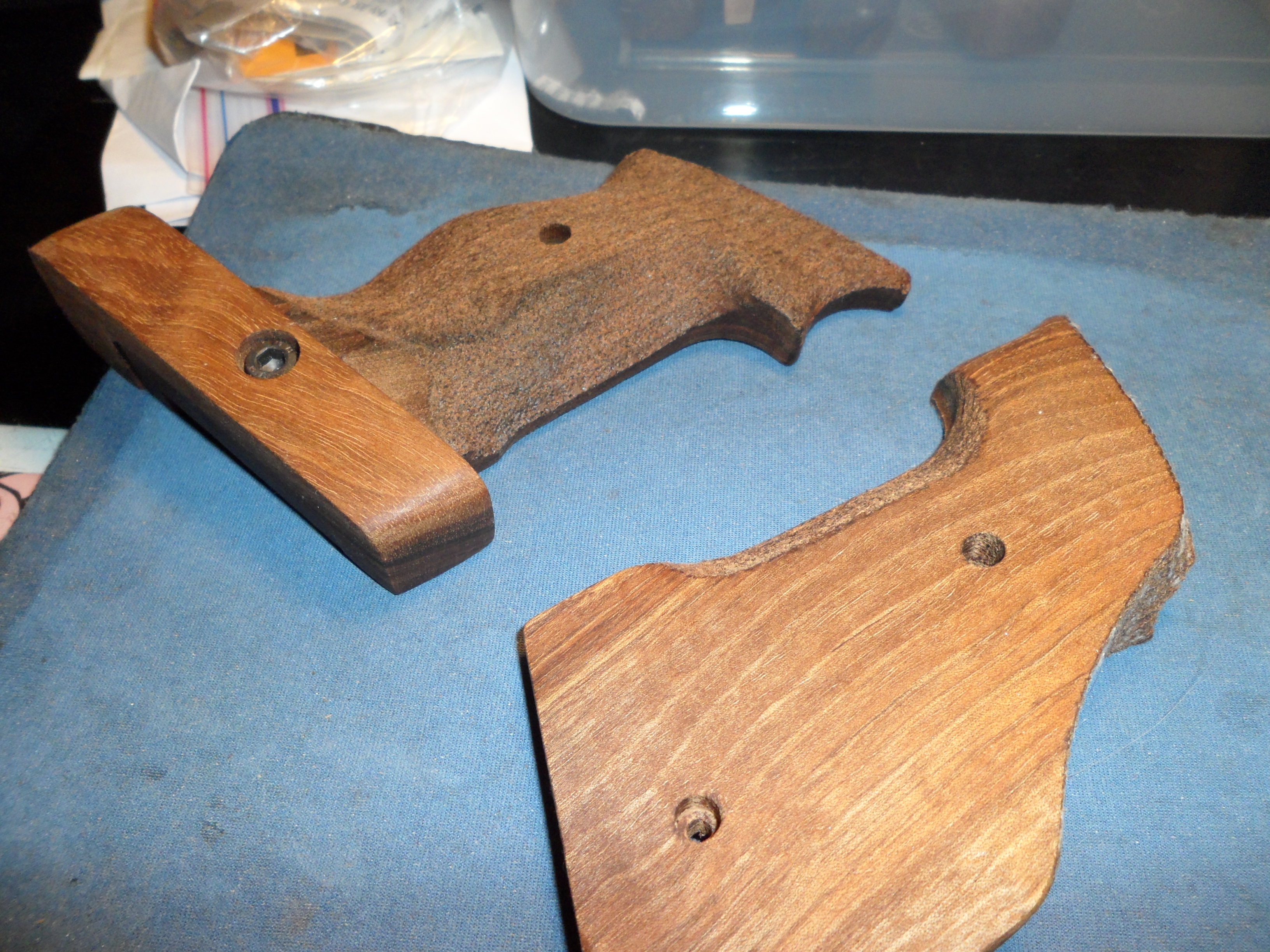

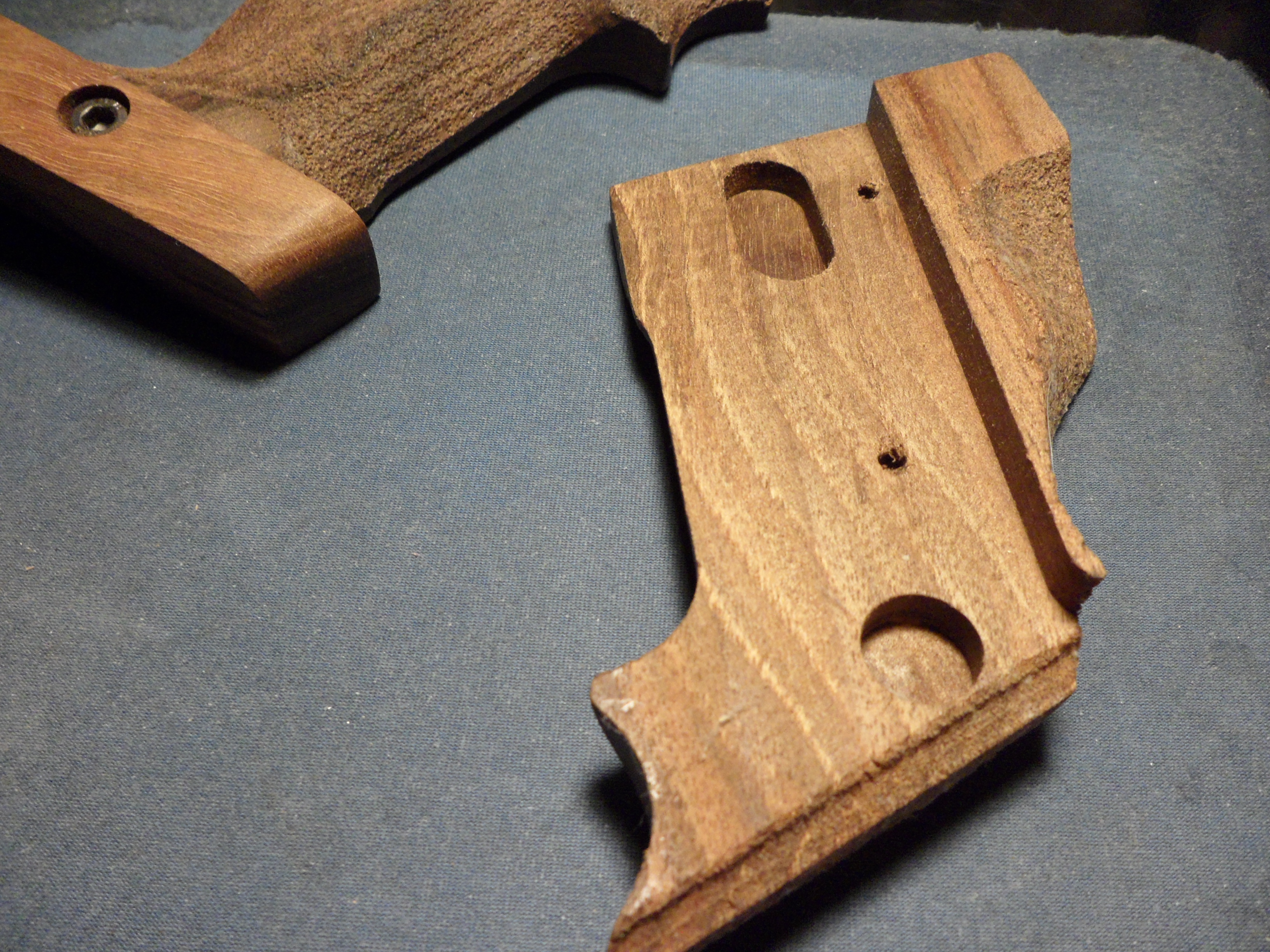

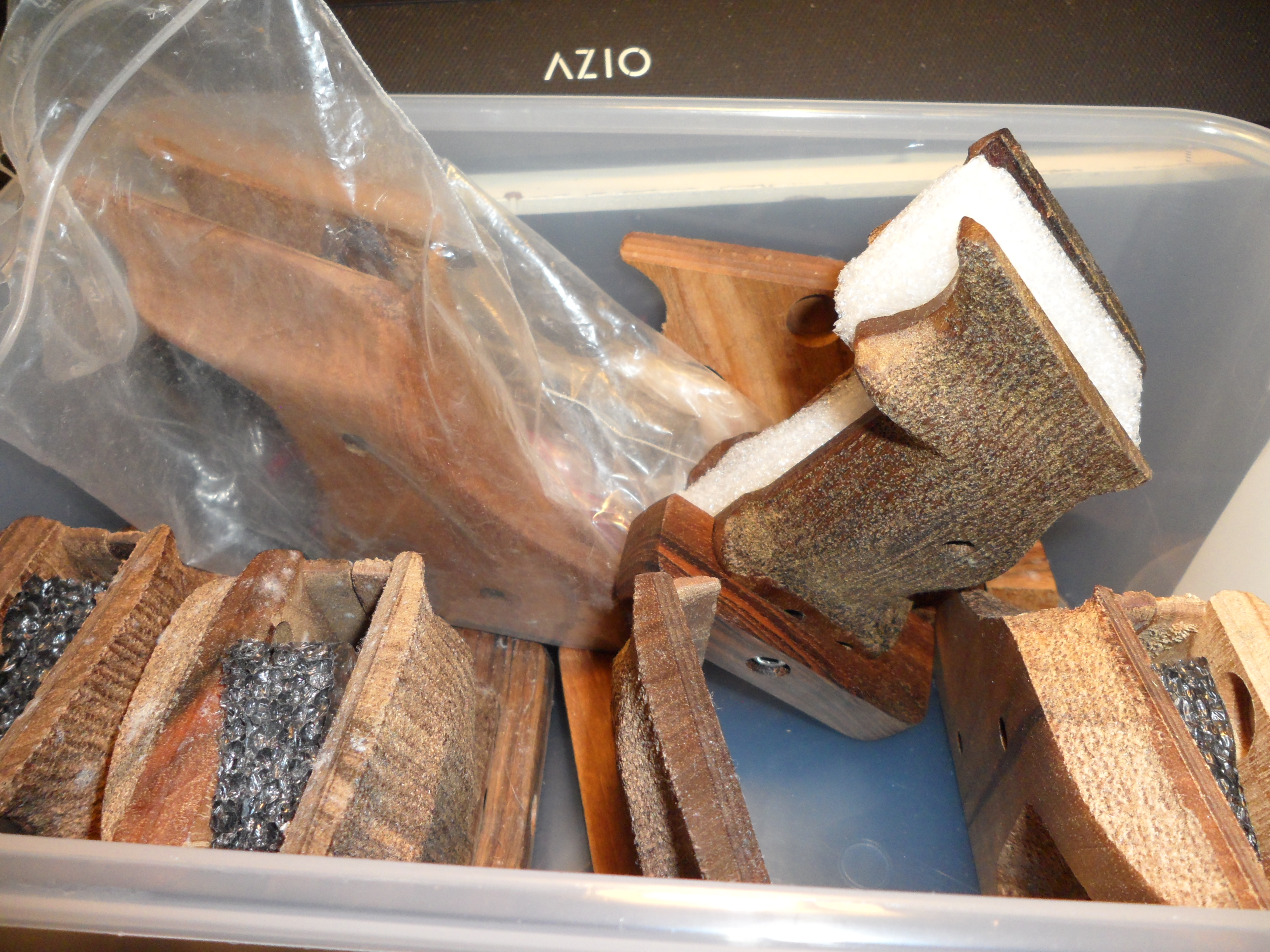

I am a lefty so I had to learn to make my own grips or find someone reasonally priced to do it for me. For years in my PB days I made my own mods or full grips and actually got pretty fair at it after a few years. After I started getting seriously into airguns and especially air pistols I heard about Vern Austin. At the time I was collecting alot of vintage American air pistols so I gave him a try and haven't made a set on my own since. After making them myself I don't know how he does it so reasonable and his work is excellent. I would check into him making a pair for you before taking it on yourself if you aren't equiped for working with wood and have some experience.
