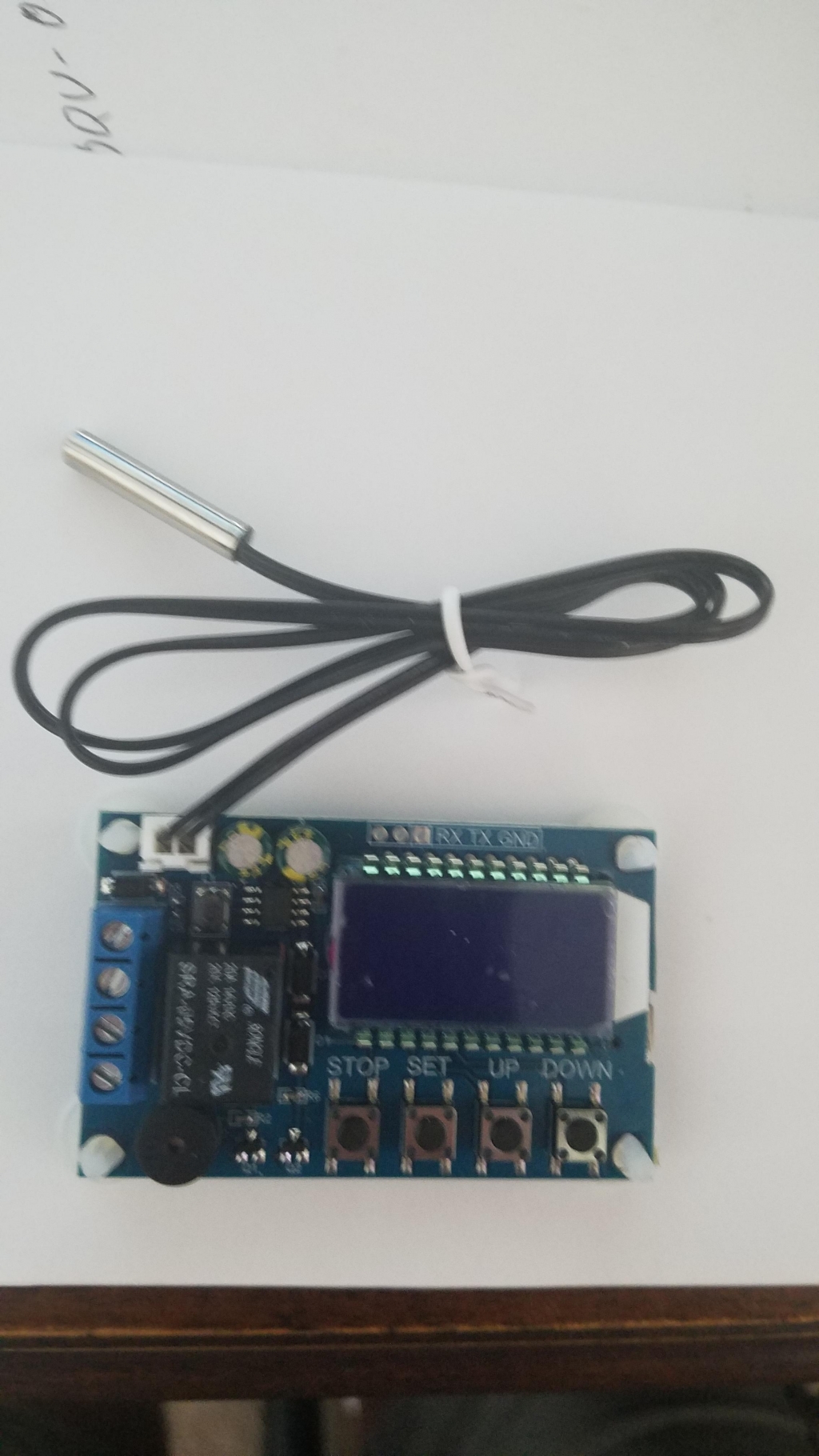

I bought a temp gauge with a F degree setting that I would like to install on my compressor. Only the sensor is slightly larger than the one that is provided with the compressor. It would require me slightly enlarging the hole that is already provided on the compressor.
How much of a risk would it be to enlarge this hole by less than 1 mm?
Here is the device.
If you really want a F gauge, I'd strongly suggest swapping out the thermometer for one of the same style in Fahrenheit. Don't bother drilling out the cylinder head to install the temp gauge you already bought. You won't be able to mount it cleanly in the panel because of the overall size difference. There are also way more parts/features on that circuit board than necessary. These compressors shake the everliving crap out of any component attached to the motor and reciprocating assembly, there's always the possibility that the temp gauge you originally ordered might prematurely fail due to all the vibration anyway.

If you have a little experience tinkering, ALL of the Centigrade thermometers that ship with our compressors can be switched from C to F. I've taken apart my thermometer to get to the circuit board, and while I was in there I found there's a pin labeled "F" for Fahrenheit, and if you short that pin to the ground pin, the board will display temps in F instead of C. I didn't permanently do this mod to my thermometer because after some thought, I don't mind it showing Centigrade even though I have pretty much no mental reference of temperature measured in C. For me, if I see my thermometer start to show anything higher than 60, I'm starting my bleed down procedures to cool the system off. I don't really care what the exact temperature of the cylinder head is, all I want to know is when to shut it off.
I bought one of these from Amazon. I recently changed out the Head on my YH compressor and the hole was smaller.
"Digital Refrigerator Thermometer LCD Display Thermostat Oven Thermometer Freezer Electronic Temperature Hygrometer with Probe for Vehicle Fish Tank Aquarium Incubators Brooders Climb Pet(Fahrenheit)"
I drilled it out being careful not to go too deep.
The gauge was a slight bit larger but nothing that a little sanding and silicon grease could not fix.
Works fine.
