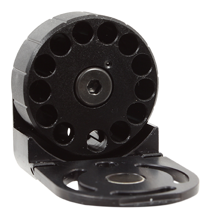

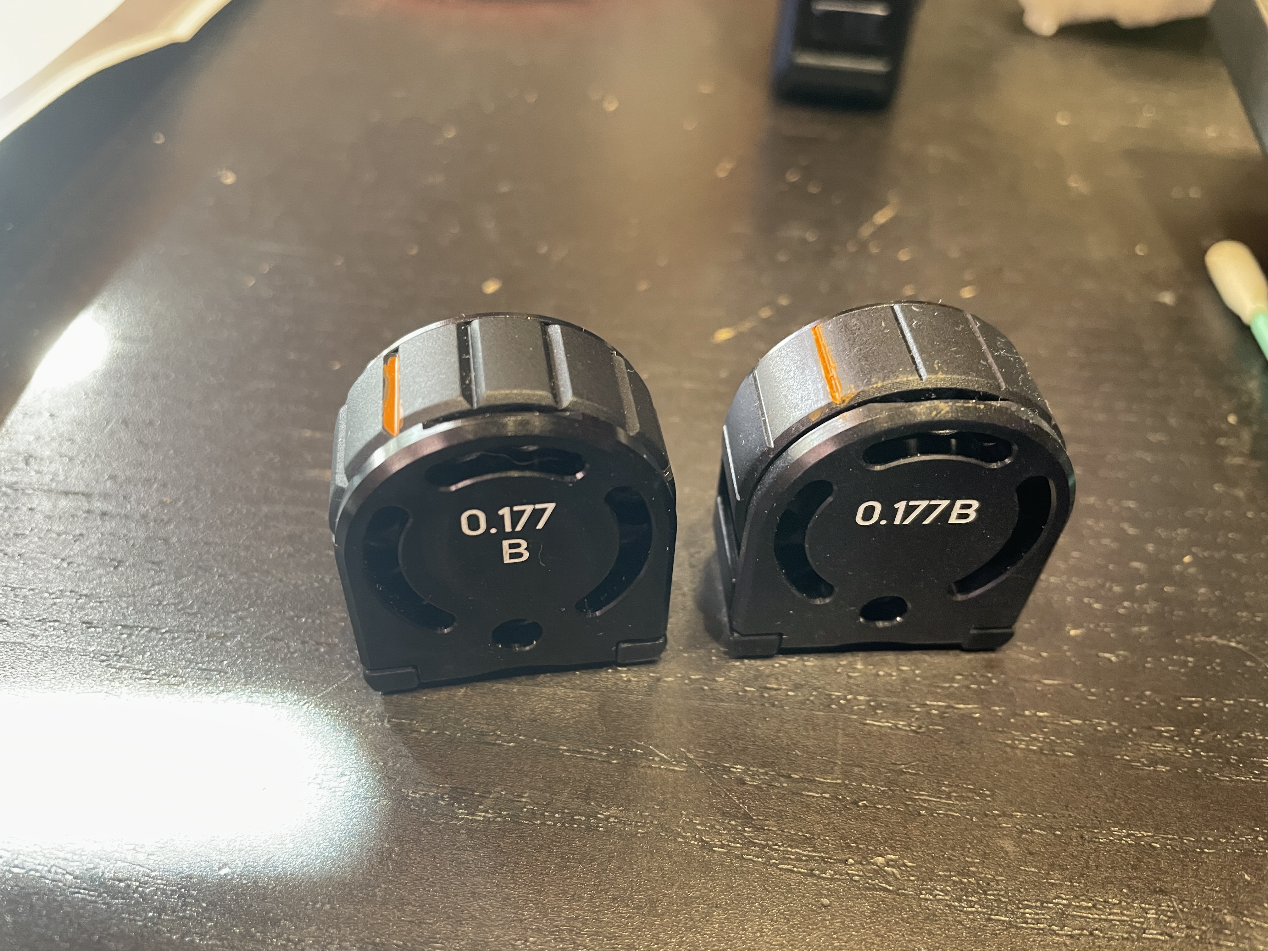

Does anyone know of an alternative for the new style flip down Brocock magazines?? The new style is pictured below. Official magazines are over $100! (Ouchie) The CARM magazines are the old style.

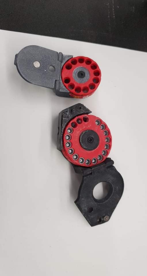

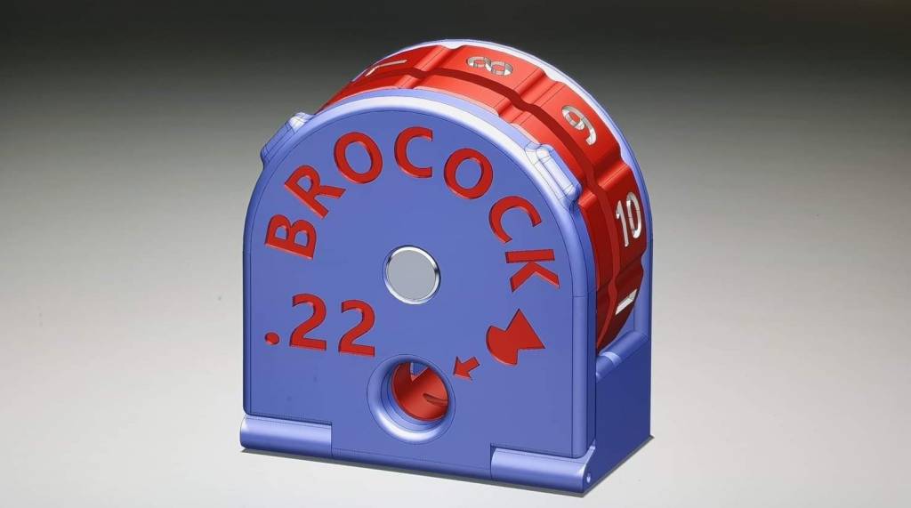

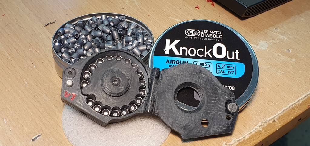

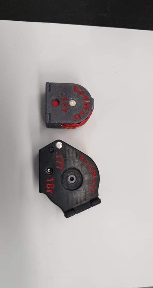

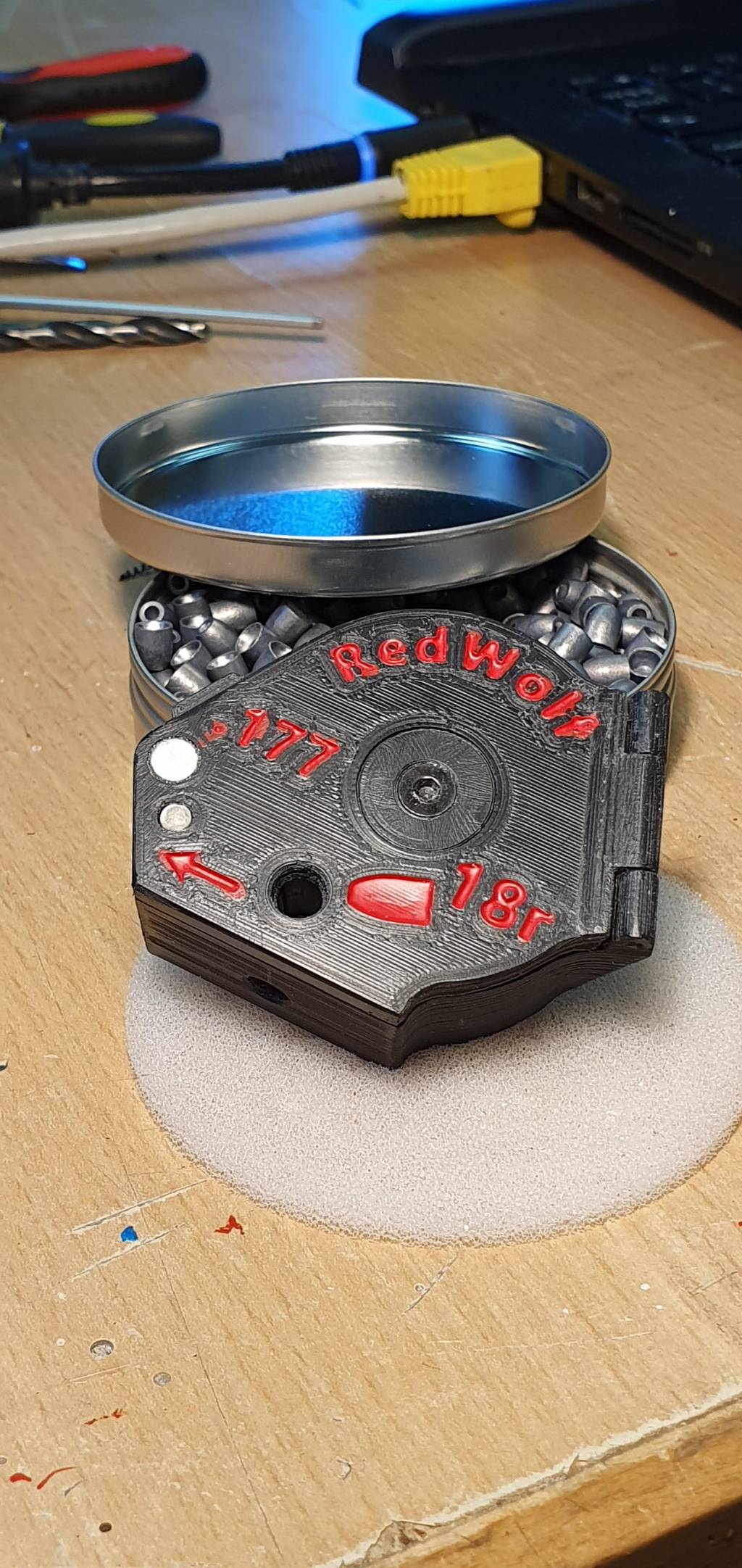

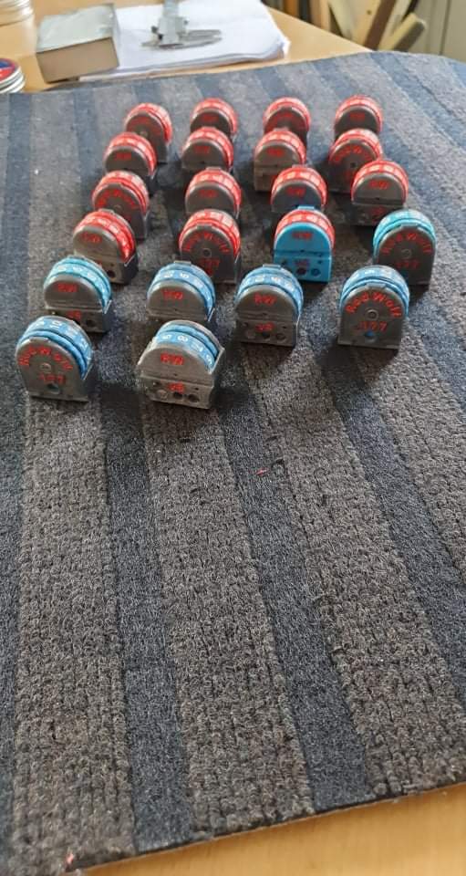

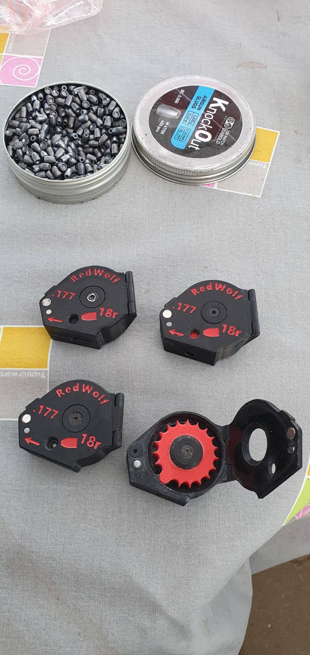

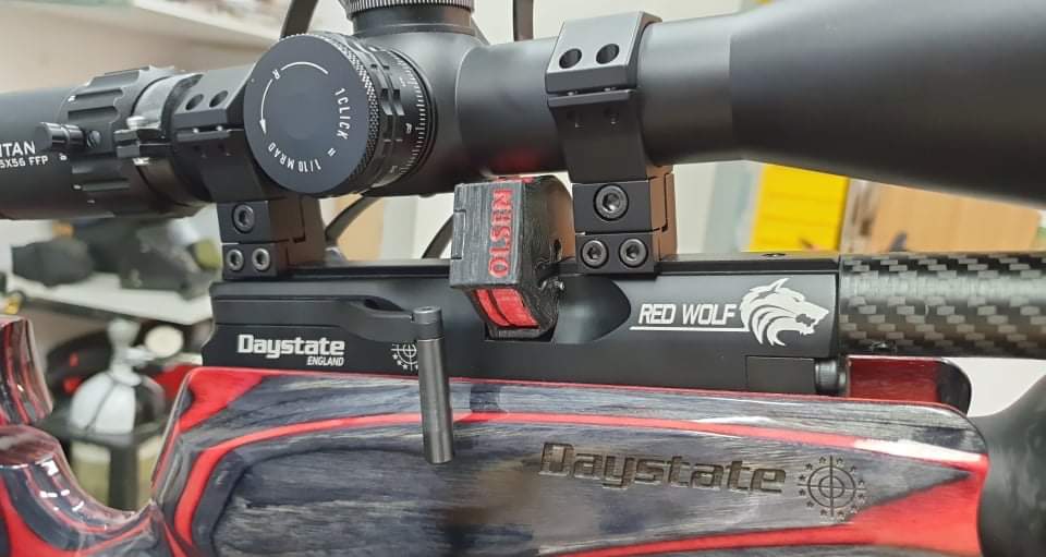

If you can 3d Print or have a friend that can help you with the print parts,

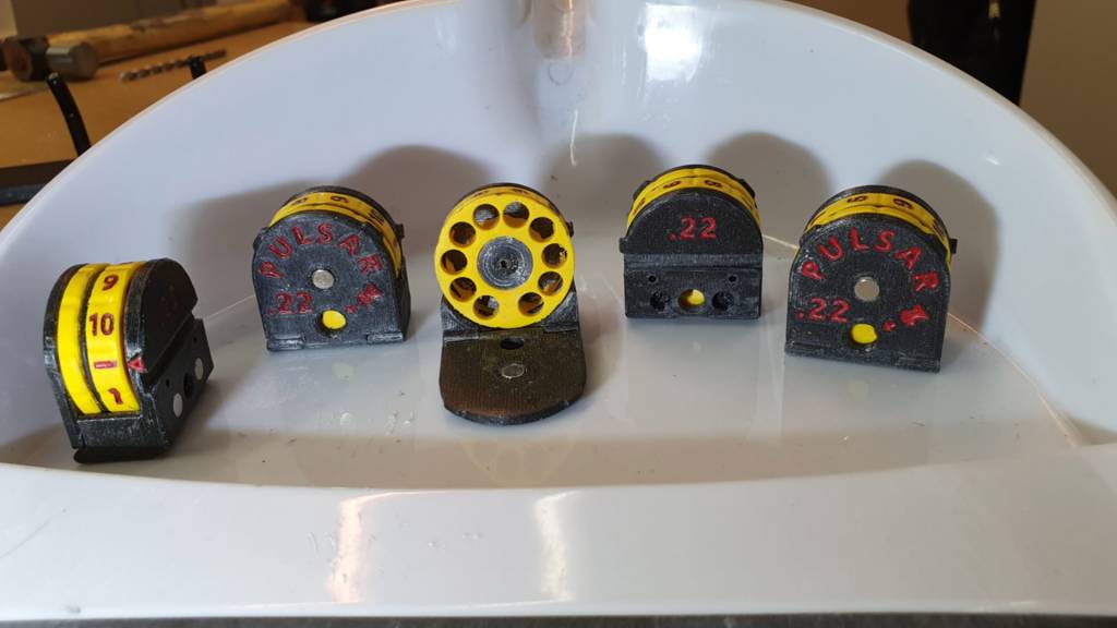

You can diy print Magz. from my own 3d design I use in my RedWolf.
I made the .22 version for a Greek friend - he uses them in his .22 Daystate Pulsar
Last image is my latest addition - a version which is user friendly for short slugs.
They work perfect- in fact i dont use the org. flip mag. similar to the image you uploaded at all.

certain Brocock rifles only take the new style Flip open magazines. You can tell by looking at the pellet feeding probe. if it has a lug on the top about 1/2 or so from the tip, it takes the old-style magazines. That lug engages the spring-loaded detent that allows the magazine to rotate.
the newer style with the flip open cover does not have that detent and so the pellet probe does not have the lug.

Thanks for the responses. My Sniper XR is the new style and only accepts the flip down style mags.
@Navyblue Looks like @engfred has the best thing going for mags. I wish I knew how to print my own magazines. Maybe ask someone who prints them to make some for you and in return compensate them for their efforts, time, and materials. You can also place a “WTB” (want to buy) ad in the AGN classified forum if you have more than 10 posts. Sometimes decent deals come about as a result.
Tooting my own horn but I have some older style magazines for sale in the classifies at a reasonable price. That said, directly comparing and contrasting the older style magazines with the newer -- the newer flip-down are far better in quality and produce the same accuracy. I prefer the newer style magazines even if it does impact the Pulsar's ability to count shot.
