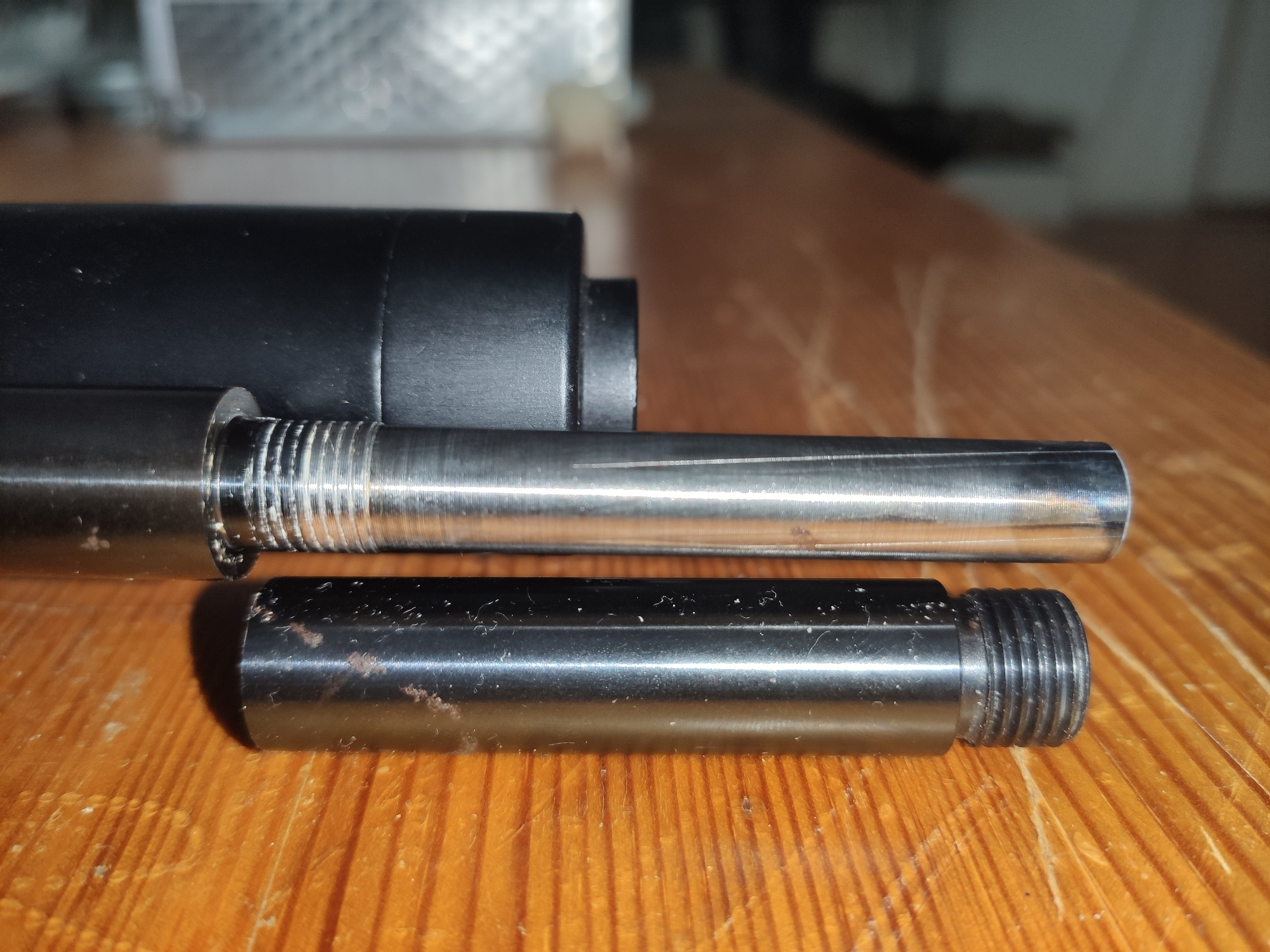

FX old ST barrels is probably the most easy way, with just rifling the very last 2 inches of the barrel, work fine too, i have always been impressed with the performance of my FX Cyclone.
Hi Peashooter, thnx for sharing you're insights. You are correct, molding the slug that precisely would be hard, didn't think about that. Also
"FX old ST barrels is probably the most easy way, with just rifling the very last 2 inches of the barrel, work fine too"
this is a good alternative, thnx for your suggestion.
I think even after FX moved on to make barrels ( in the same way but with rifling all the way ) some shooters still held on to their old school ST barrels for a while.
It did freak me a bit that what is essentially a smooth bore barrel aside for the last couple of inches could shoot that good.
Mind you on those last inches they do still grip the pellet to spin it up, its not like in that way it is a " softer " approach to a fully rifled barrel.
But its also not like the ST barrels needed to grip the pellet harder, it is after all just a rifling pressed into the barrel from the outside, so in profile i assume more like octagonal barrels than traditional hammer or cut rifling that have sharper transition between lands and groves.

FX made Original Smooth Twist, Smooth Twist & Smooth Twist X barrels. The Original Smooth Twist barrels were the ones with rifling only at the last 3 or 4 inches. Some of the most accurate pellet barrels ever made. Not so great with slugs. Luckily for me I have 3 of those guns.
My Bobcat with the ST barrel was a laser. I did not know that it was only rifled at the end. Interesting.
Reactions: CreationInk
My FX Royale 500 has the smooth twist barrel and it's definitely a keeper!
