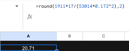

What is EXP? Is that just expansion abbreviated?
Also with this formula I got .207139
1911*17/(53014*.172^2)
@Stubbers
It's a mathematical term "Exponential function" that excel and other spreadsheets recognize. , must not leave it out if your impact velocity is not known.
I get 20.7" using your above data, suggesting basically 21" of penetration through flesh, I am unsure how your 2 orders of magnitude off but its close!
-Matt
I see why now. And your screenshot formula at the end.You also times that by two whereas in the first one it ended with to the power of two.
^2 = ² when you write a formula in excel which is how I showed the above formula, which means to square the quantity or multiply it by itself. Same thing as power of two.
-Matt

I got thay part, but in the screen shot you took it shower ^2)2).
Where as in the original formula you showed it ended in ^2
In the screen shot the second 2 = the rounded decimal place with the use of the round function in excel. ^2,2)
Here it is again, without that ",2"...showing the number unrounded to the 2nd decimal..matches your original just 2 orders of magnitude difference.
-Matt
