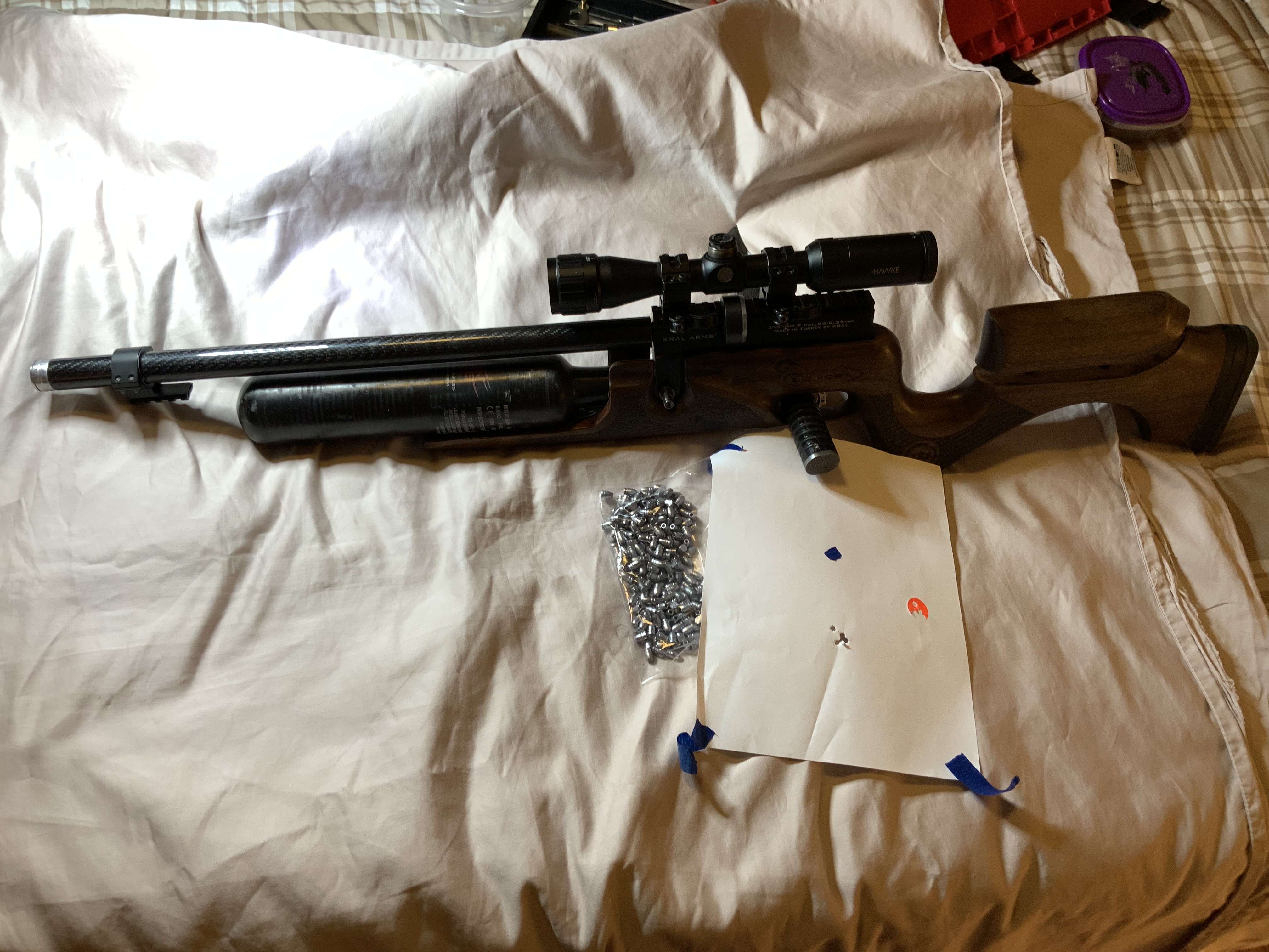

I got my choked Kral Bighorn to shoot slugs but first…..
I amputated that insidiously tight choke. Then I polished the barrel with #7 using a jag and patch on a box Smooth stainless ball bearing handled rod from the chamber. Then I reversed the barrel and polished to make a full barrel length taper, but just 1-2 thousands. I then used up a pile of bullets as single use go-no go gauges to get the lead perfect for that one slug. Finally, I finished the polish with Flintz, then crowned.
The Kral barrel with the exception of a way to tight choke, was one of the smoothest most consistent barrels I have worked on, the TJ barrels were one of the roughest. The Bighorn shoots 44.2 grain MPmold .252 hp’s from a 3 cavity mold dropping 44.2 grains with 20-1 at 966 fps. It shoots touching at the limited ranges My only remaining eye with a Dying optic nerve will allow me to shoot which these days is 35-40 yards.
