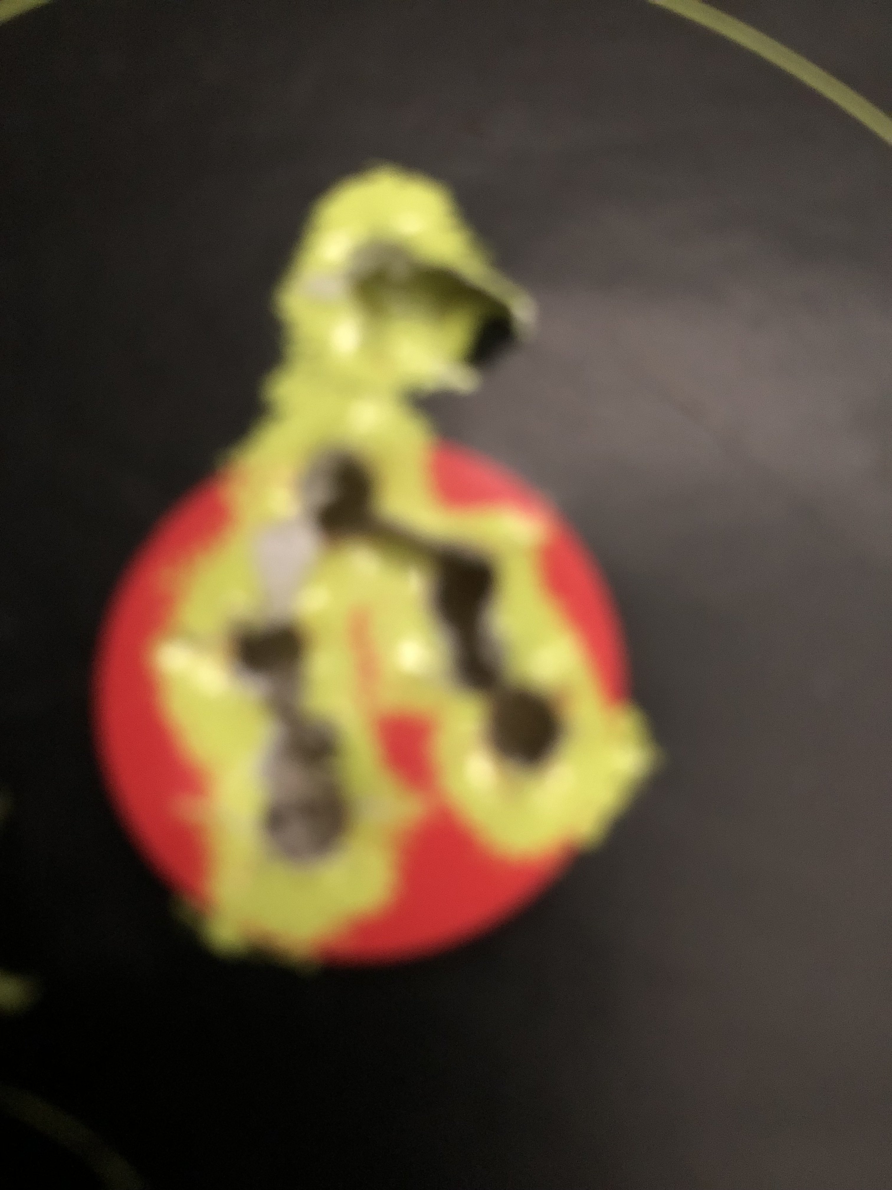

Lol ……. Now I’ve heard it all ….. it’s always a combo issue. I like the guys reinventing the air gun itself …. My Brocock commander XR magnum shoots as good as I need …… sub moa at 100 yards is just fine for my small game hunting for now
Picture is My hundred yard target. Using knock out in 25.38gr. 217cal
My future needs may change Who knows.
