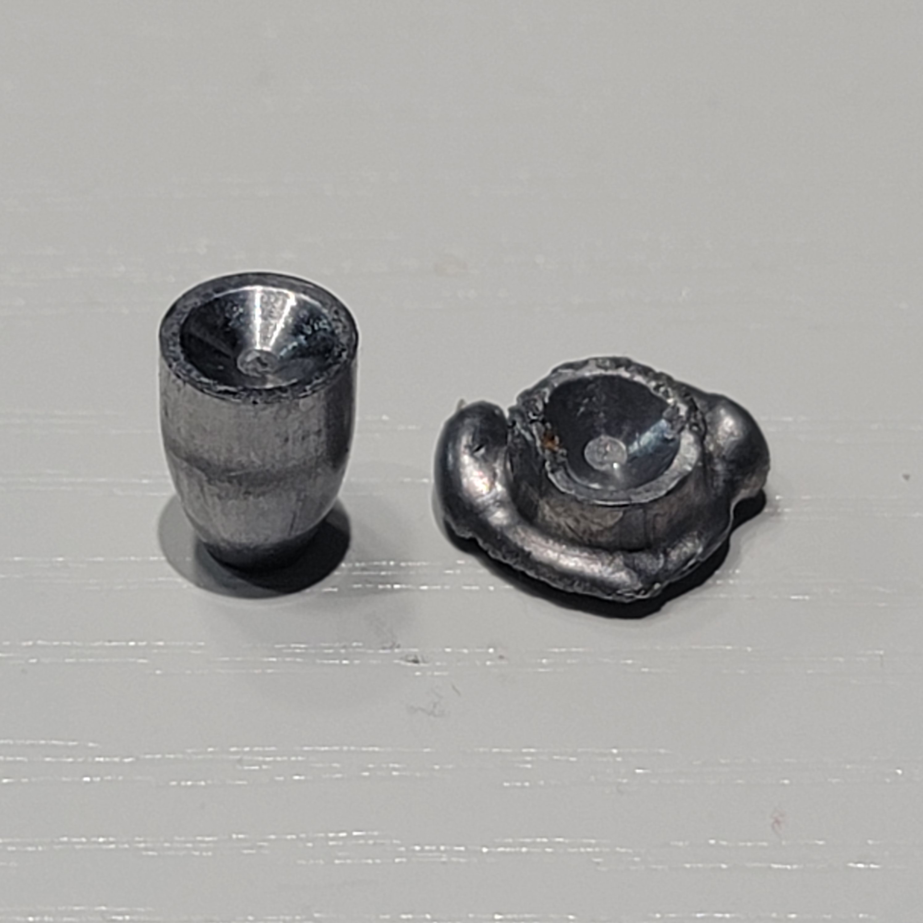

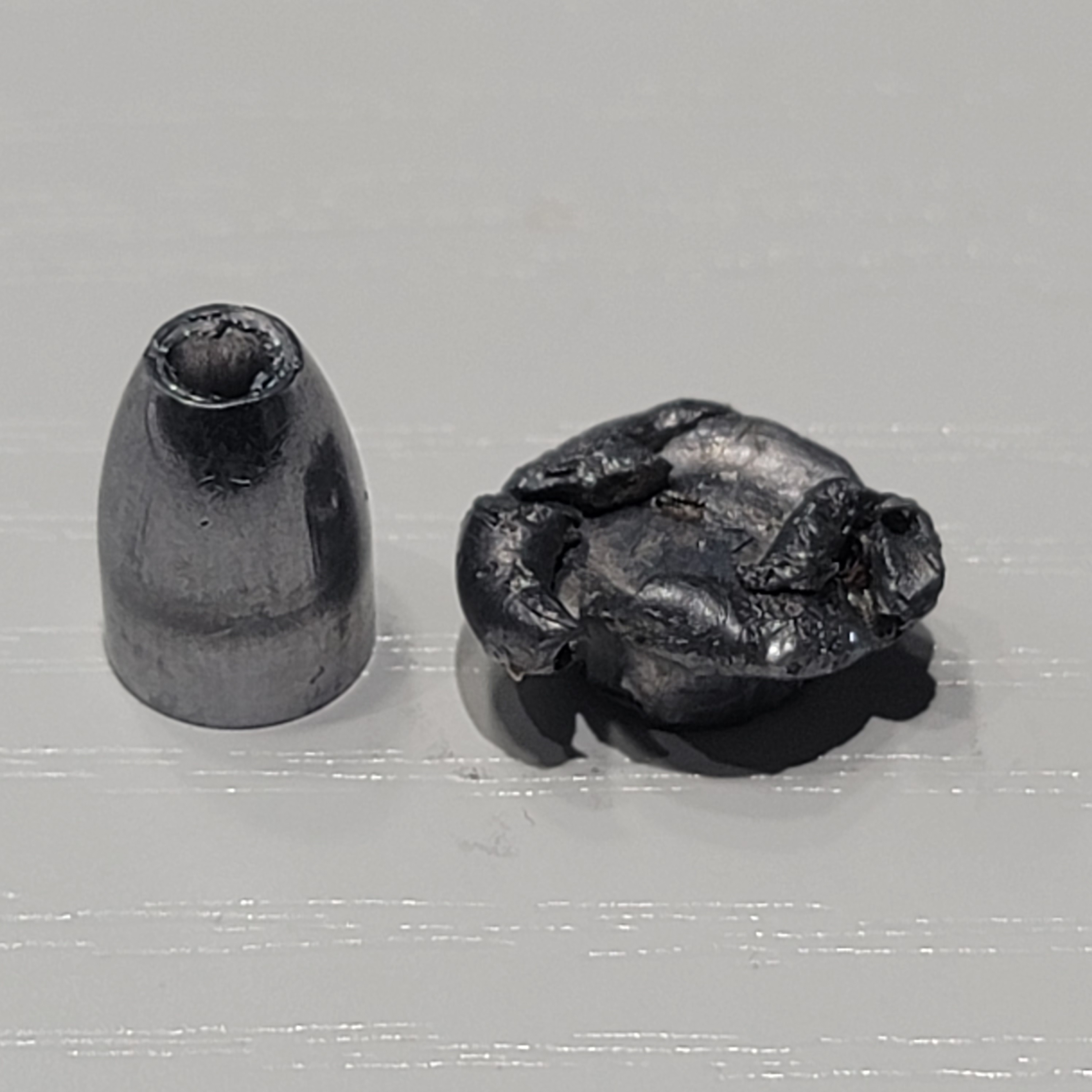

If you think you are going to get the same accuracy as pellets, you probably won't. But I have been able to get excellent results using the FX Hybrid Slugs in my Maverick VP shooting them at 930 fps, with the Superior X Liner the gun shipped with. My groups are slightly larger than MOA, but I'm also not that great of a shot. Here is a photo of a 50 yard group of Hybrid Slugs:
Might as well shoot high BC pellets if you're only going to shoot something like the NSA 20.2 or FX Hybrids with a BC only slightly higher than the .25 JSB King Heavy.
If all you want to do is punch paper, then high BC pellets are definitely the way to go. But if you want ammo with excellent expansion on impact, the lighter Hybrid Slugs are worth a look. Those high BC pellets look like they've never been shot in the first place after zipping through prey. Here is the expansion I get after a full passthrough at 66 yards on groundhogs with the FX Hybrid Slugs at 930 fps.
