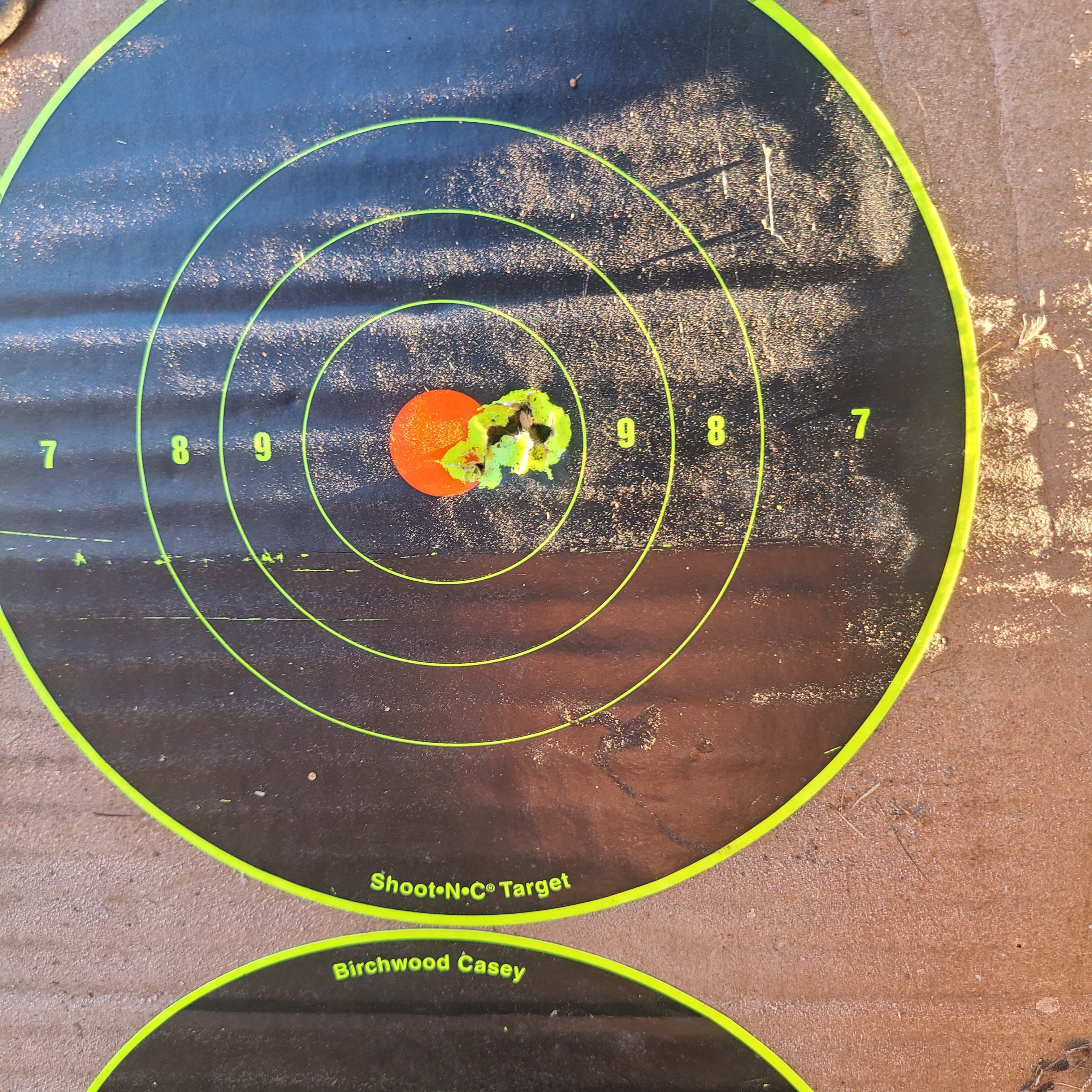

I finally jumped on the slug bandwagon and boy did I spend a lot of money for some terrible accuracy!
Can you validate if you're having the same experience?
Yep, similar experience.
Lost exact count but seems like it was around 15 barrels. And all good stuff too, mostly LW but even some of the old Career barrels machined to fit modern PCPs.
I eventually got a Career barrel to shoot slugs pretty dang good. Also reviewed a .22 Red Wolf barrel that would should the 20.3 grain NSAs pretty good. Had a couple .177 LW barrels that would shoot 12.5 grain NSAs okay. The unchoked LW barrel on my Vet Long will do pretty good with the 20.3 and 17.5gr NSA also, as well as some of the Griffin slugs (seems like the 23gr griffins). Anyway, even the best shooting barrel/slugs I've come across didn't outshoot a good batch of the .22 Monster RDs. Even the .20/15.89 pellets from JSB have shot better than every slug I've tried, and that's even stretching them out to 145 yards.
My current stance on slugs? If I get a new barrel or gun I'll try em, but I'm not investing much time or money in them anymore. One 10 shot test group with a slug is typically all I need to move on these days.

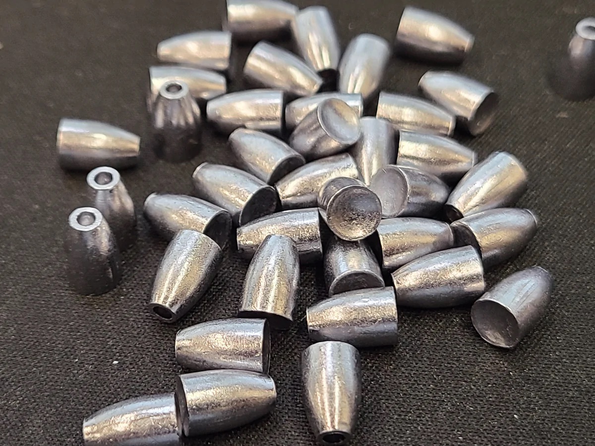

When it comes to slugs there are some things that should be obvious but guys overlook. Maybe some guys know better but the need to shoot something a million fps clouds their judgment. Here are 2 pictures, both the same caliber. One of these projectiles is begging to frustrate you because it’s a slug. The other is approaching what would appear to be an actual bullet. Stubby dumb little bullets keyhole or become unstable out of our powder burners so………

All the above recommendations are vital to slug shooting! My RAW HMx .22 likes NSA 17.5gr .2175 slugs but not 17.5gr .217....that little amount of circumference makes a world of difference in accuracy and if the slug does not fit snuggly into breech/lands.....shotgun groups! So...I need to measure each and every slugs diameter if I want to shoot accurately unlike pellets where I shoot JSB 18gr str8 from the tin more accurately than I can shoot. Slug shooting takes a lot more dedication than pellets for sure and will be frustrating! LOL!
Reactions: rsfrid and qball
Good to know! I’ll let the guy I know who has the RAW in .22 k ow about trying .2175 NSA!
qball, remember each barrel is ever so slightly different but I do hope his barrel will do well with .2175'! Best bet is to get a .22 sample pack from NSA, that helps narrow sizes much easier and less costly!
Reactions: qball and rsfrid
In this case, it would be almost easiest to directly buy a .217 sizing die from NOE and widen it to .217,5 and then buy wider slugs .218/ .219 and size those slugs to the right diameter

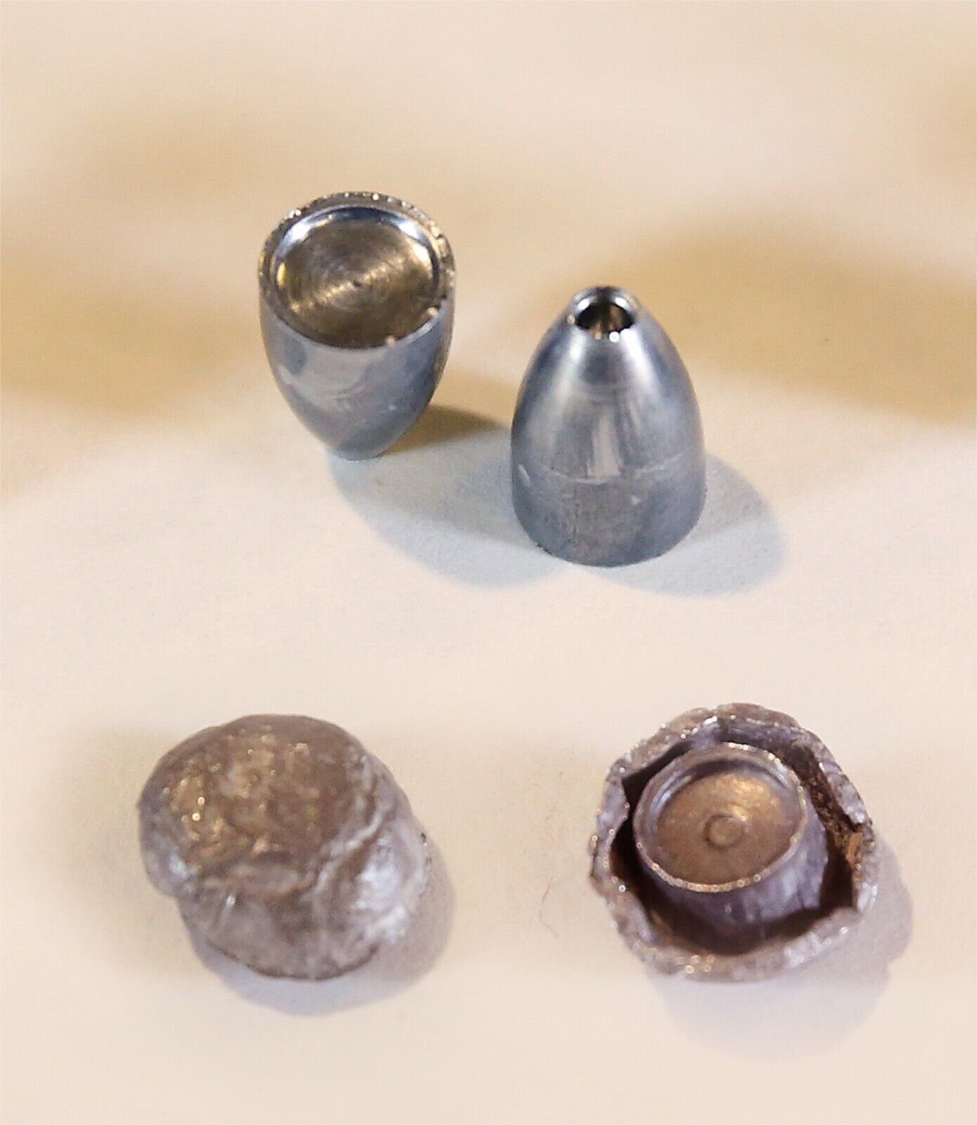

Also you want to shoot slugs with a BC higher than 0.10 (or close), and not the light ones. Might as well shoot high BC pellets if you're only going to shoot something like the NSA 20.2 or FX Hybrids with a BC only slightly higher than the .25 JSB King Heavy.

As I shoot .22cal 20.2 gr nsa in two guns, and feel there is a considerable difference in knockdown and BC (.075) Especially considering the comparable pellet would be the MRD with a .053bc in .22cal
