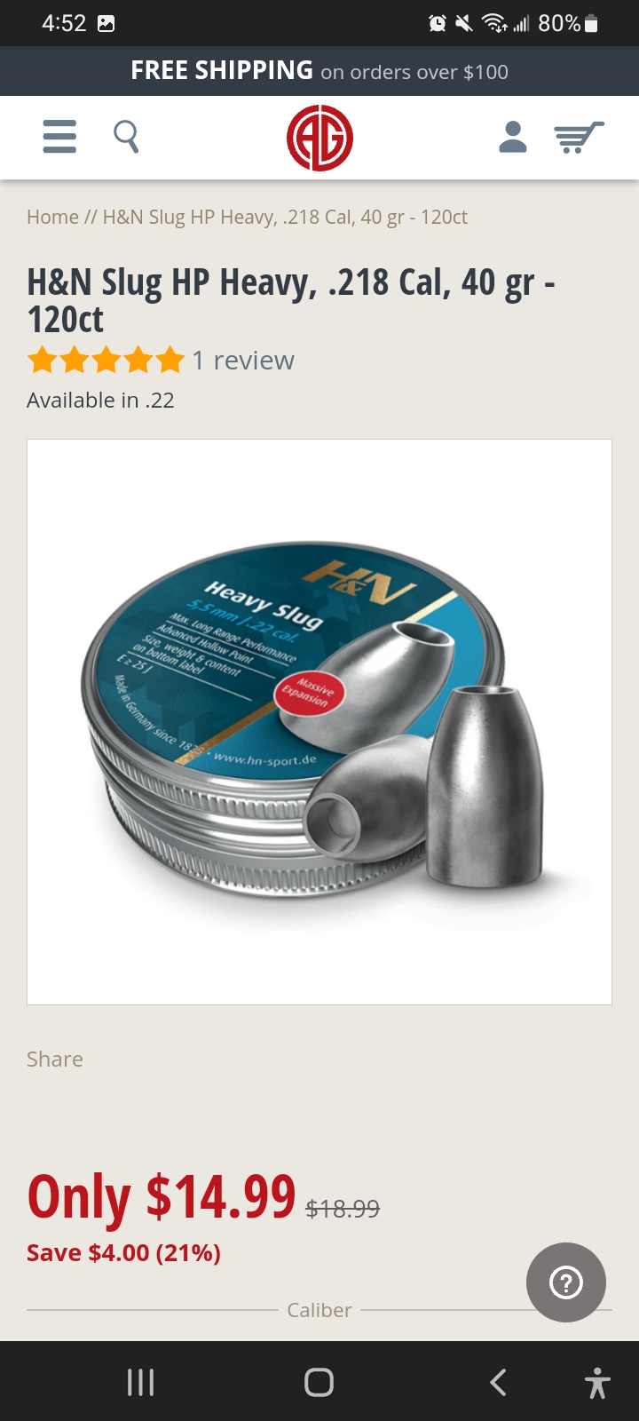

Only slugs I have tried out so far. Just about as accurate as my regular pellets; but they hit like a freight train aaaand my aim is way higher with these beefy 40gr beasts
