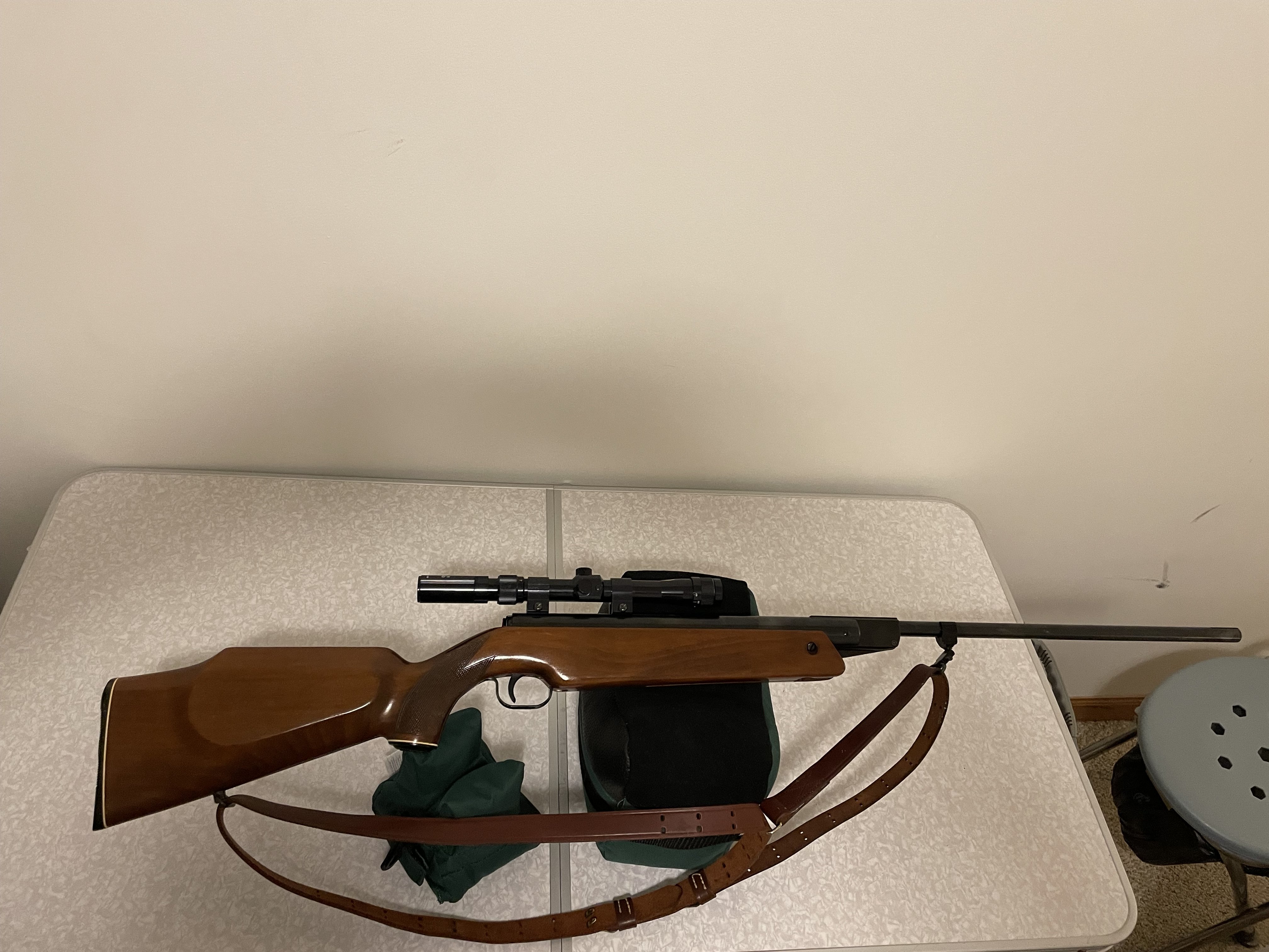

I'm a collector of quality (mostly) piston powered airguns. I've had 4 different FWB 120 series rifles over the years and not one of them has ever shot well for me. I mention that I'm a collector because I want to stress the point that I have numerous piston guns and only 3 or 4 of them produce unacceptable accuracy. I've tried a soft hold, a loose hold, a firm hold, and a tight hold. I've tried countless types of pellets and ruled out scope issues. The only thing that I can think of is that although none of my other rifles have a problem being shot off of a bag, perhaps these guns do. Some of you have seen my channel and you've seen what kind of accuracy that I can achieve while shooting off of a bag.
I just picked up a 127D and cleaned out the old wax like remnants of what used to be the original FWB seal. I ordered and installed new seals ( piston and breech seals) along with an ARH full power kit.

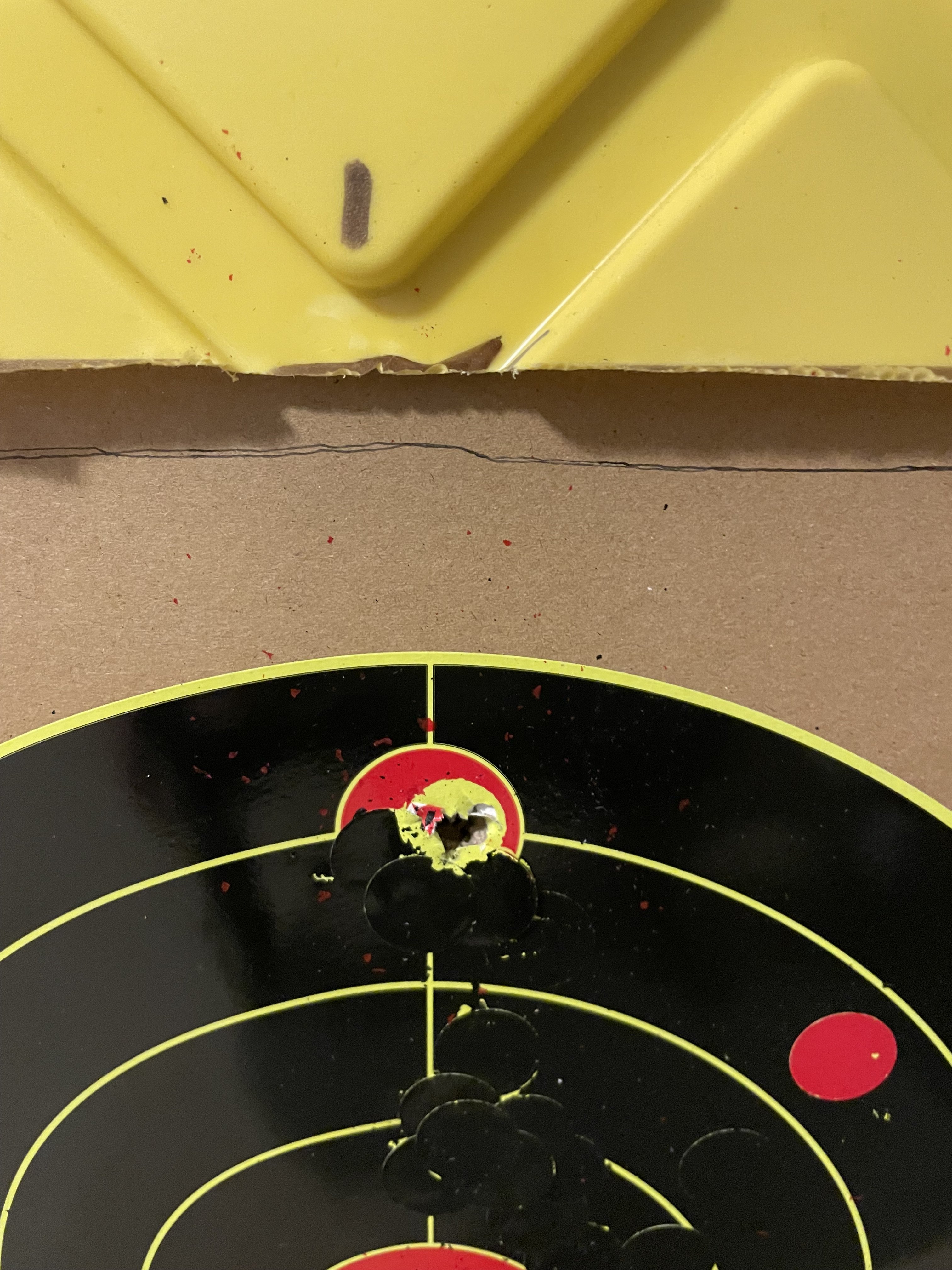

Sat down this evening for the second shooting session with it to try to get it zeroed and I can't get any sort of consistency out of the POI. That's 4, 120 series rifles that I've owned now that I can't extract any accuracy from. Is it time for me to toss in the towel and accept that me and the old FWB Sports will never see eye to eye?

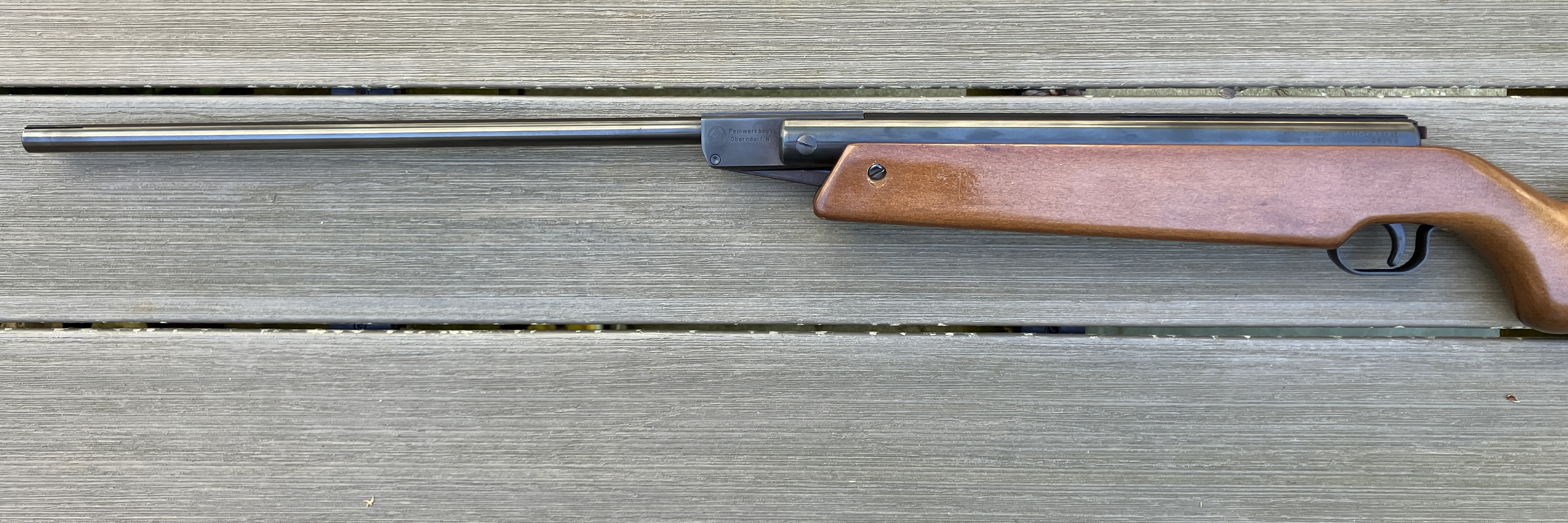

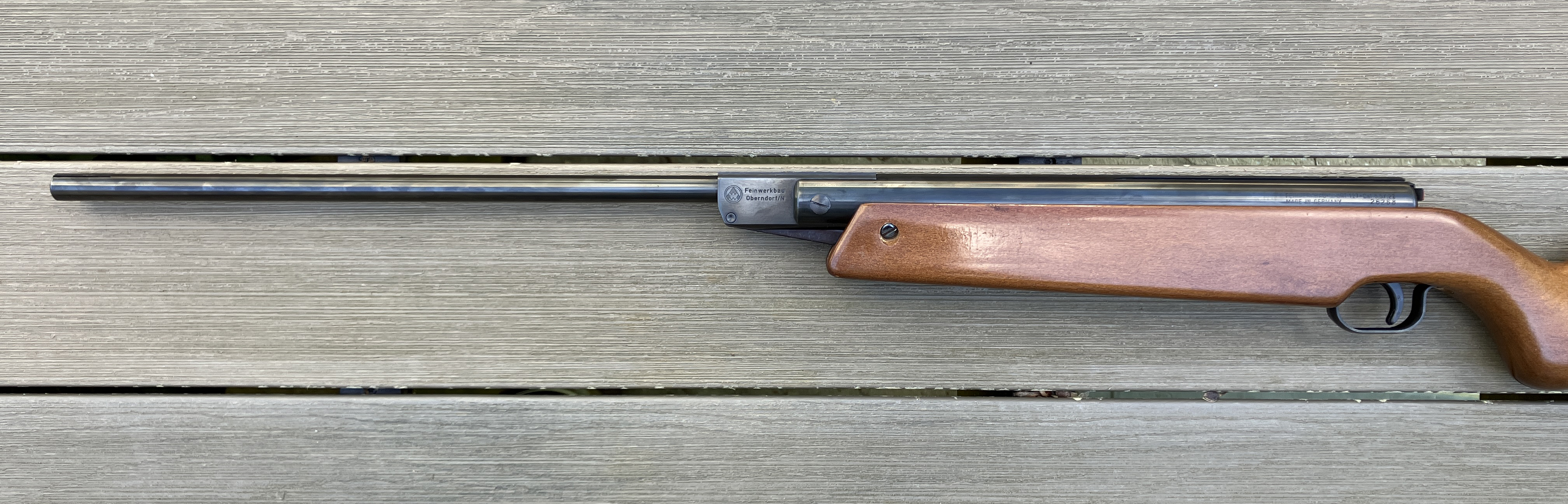

The barrel lockup is extremely weak, mostly due to the ball detent arrangement and longish barrel.
The breech shim setup is also not the best for strength with it having a spring washer on one side that you can never actually take the slop out of.
As far as the shot cycle goes they are harsh. The piston is large and diameter and very heavy relative to the weight of the rifle.
They were also plagued with compression tube diameter inconsistencies over the years. Some would be very tight, some oversized, and some with a taper towards the muzzle.
I do still have one that shoots well after some work. But I've counterbored the breech block to take solid bronze shims to help the lockup, and lightened the piston considerably to help reduce the hold sensitivity.

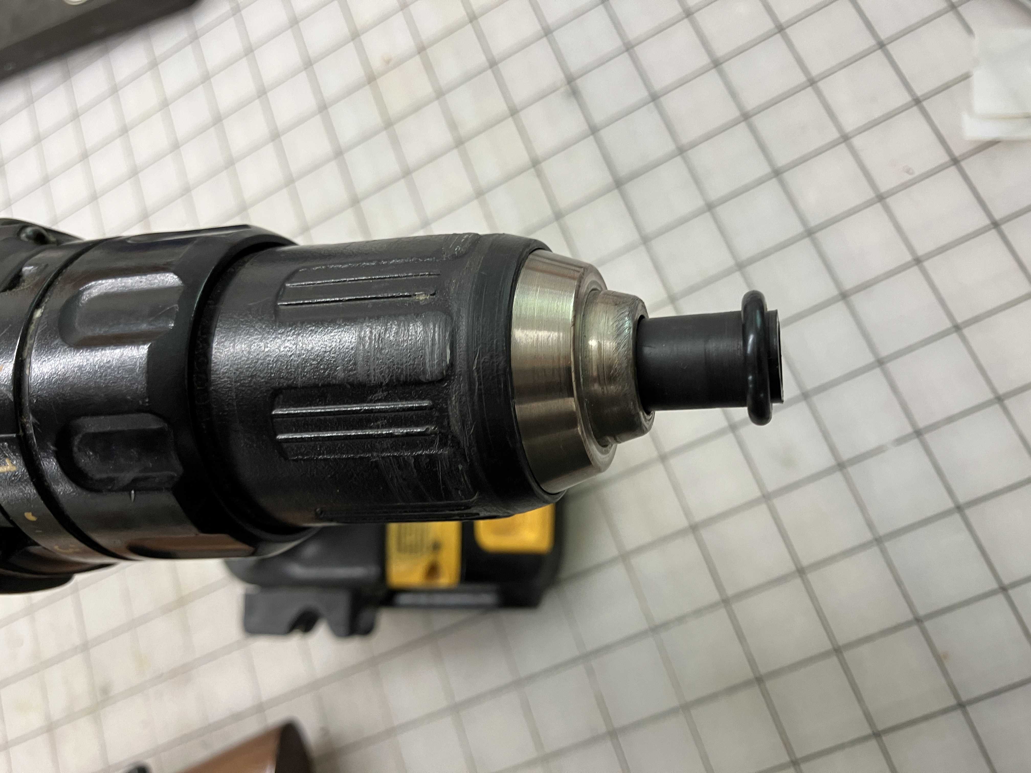

JM's breech o-ring is a bit oversize and the OD needs reduced slightly to fit in the groove so it doesn't sit too proud preventing a solid barrel lockup.
This can be achieved by sliding the o-ring onto a wooden dowel and chucking it up in a drill and spinning against a disc sander. I have my fair share of FWB's so made a special tool out of delrin just for this purpose. You can see the before and after pics of the barrel next to a straight line. Of course, use tissue paper to check for blowby when you think you've got it.
