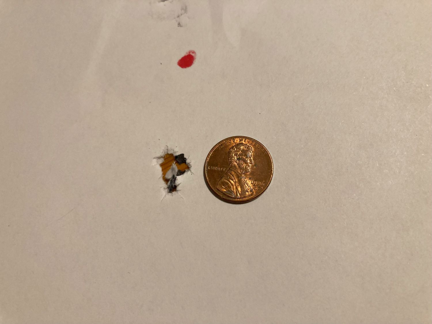

My 124 D is a delight to shoot. Bought it in the early 80's and avoided most of Beeman's propaganda however did add the 3x Blue Ribbon scope bought at gun store in Chalmette, La. 25 years ago. I'm on 2nd piston seal from 13 years ago so will check here when it goes again. My latest chrono and target at 20 yards on bench. I always shot prone or back to tree when my back was new. Took squirrel offhand, last week, raiding wifes sunflower plants .
