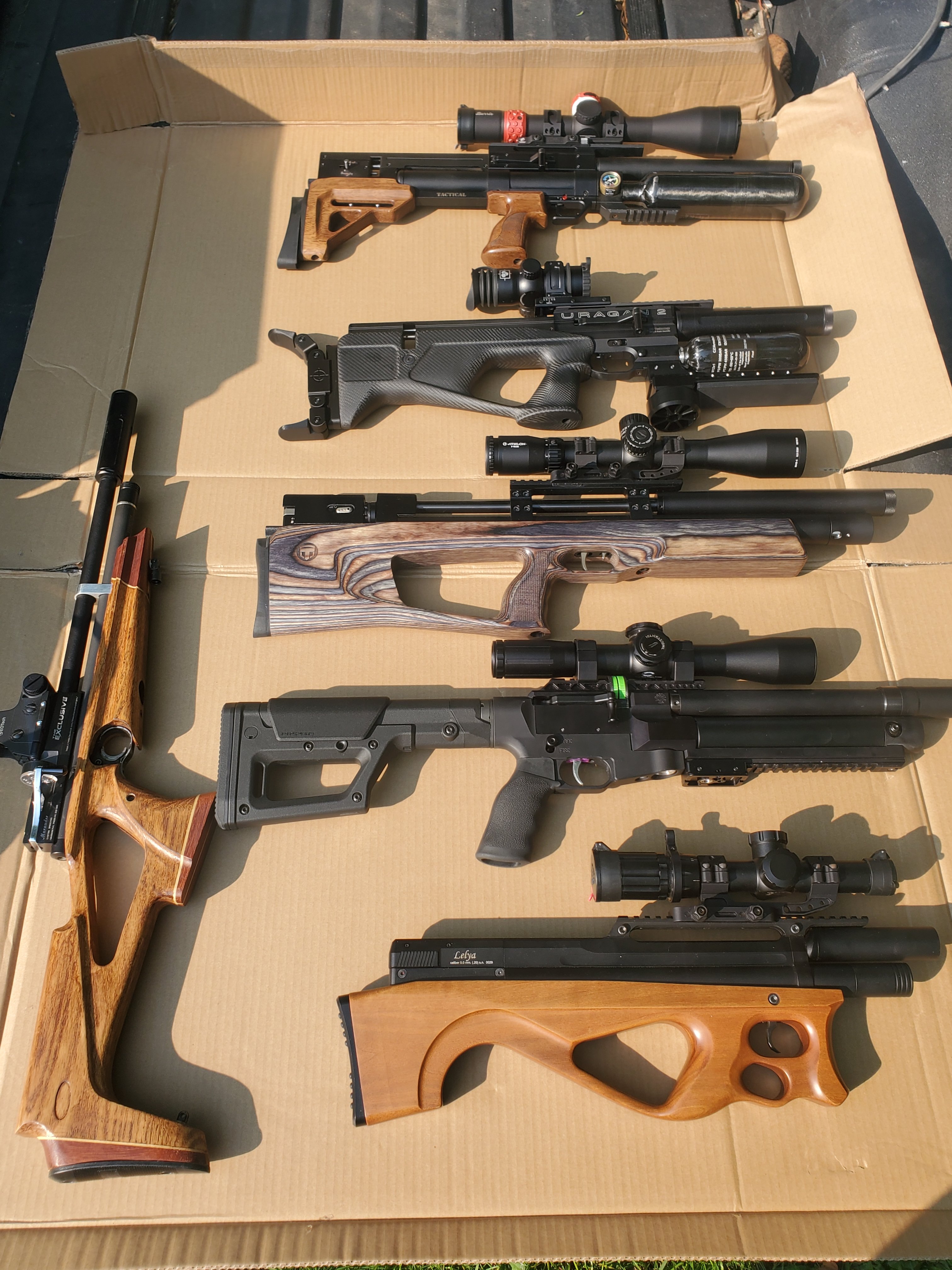

Yes, very helpful info for sure and an awesome little collection you got there! I have heard great things about the Taipans and Uragans. I really dig the Vixen's looks. And I remember when the first Lelya came out, I had just purchased a new Matador at the time. How do you like it? I know I said I was sick of bullpups but something about the compact ones draw me in :)
I was also considering an Edgun Leshiy, I love the tactical look with the M-Lok rail...but I have seen a lot of them for sale and mixed comments as well so I put it on the back burner.

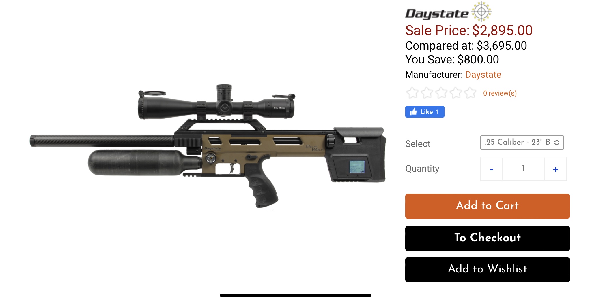

Does this interest you? $800 off
Oh man, I've always admired Daystates but from afar only ;) It seems like a sweet little rig, but pretty much every top end PCP I've had was during the bullpup craze so I'm trying to avoid them. If I was going for a Daystate I couldn't pass up one a model with one of the traditional wood stocks.
