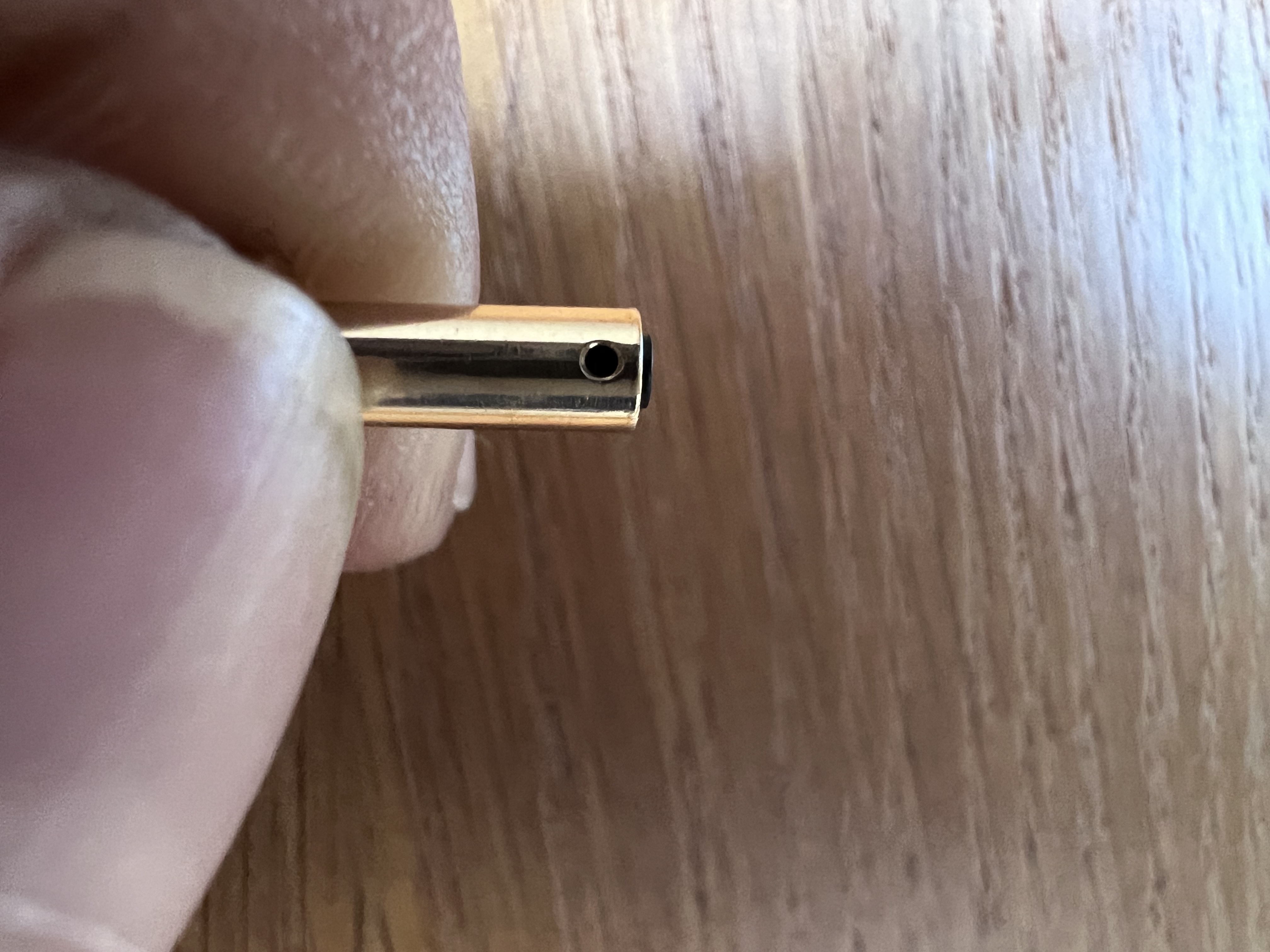

Hi guys, I own a wildcat mk30 sniper in .25. I’m having 30 sec or more reg recovery. ( reg 150/190). Examining the piston more closely I noticed the derlin sticking out a bit too much from the two holes. It looks like there’s no airflow.
Is it normal?

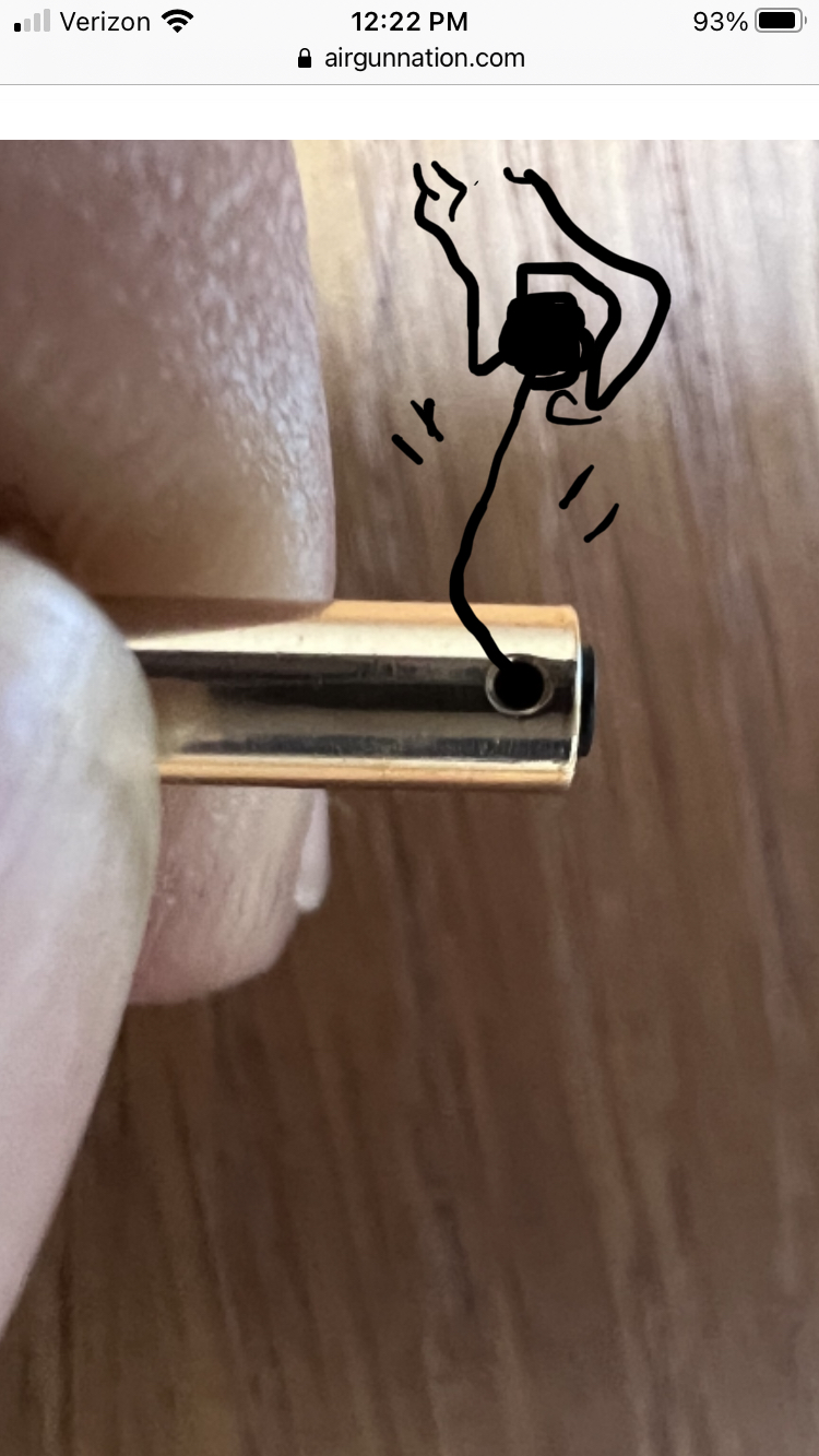

Correct me if I’m wrong, but that thru hole design I believe is meant to remove that Delrin insert if need be-
Like inserting a fine and pointy sharp needle in there
So i did it, I’ve used a hot needle to make it trought as Corny suggested.

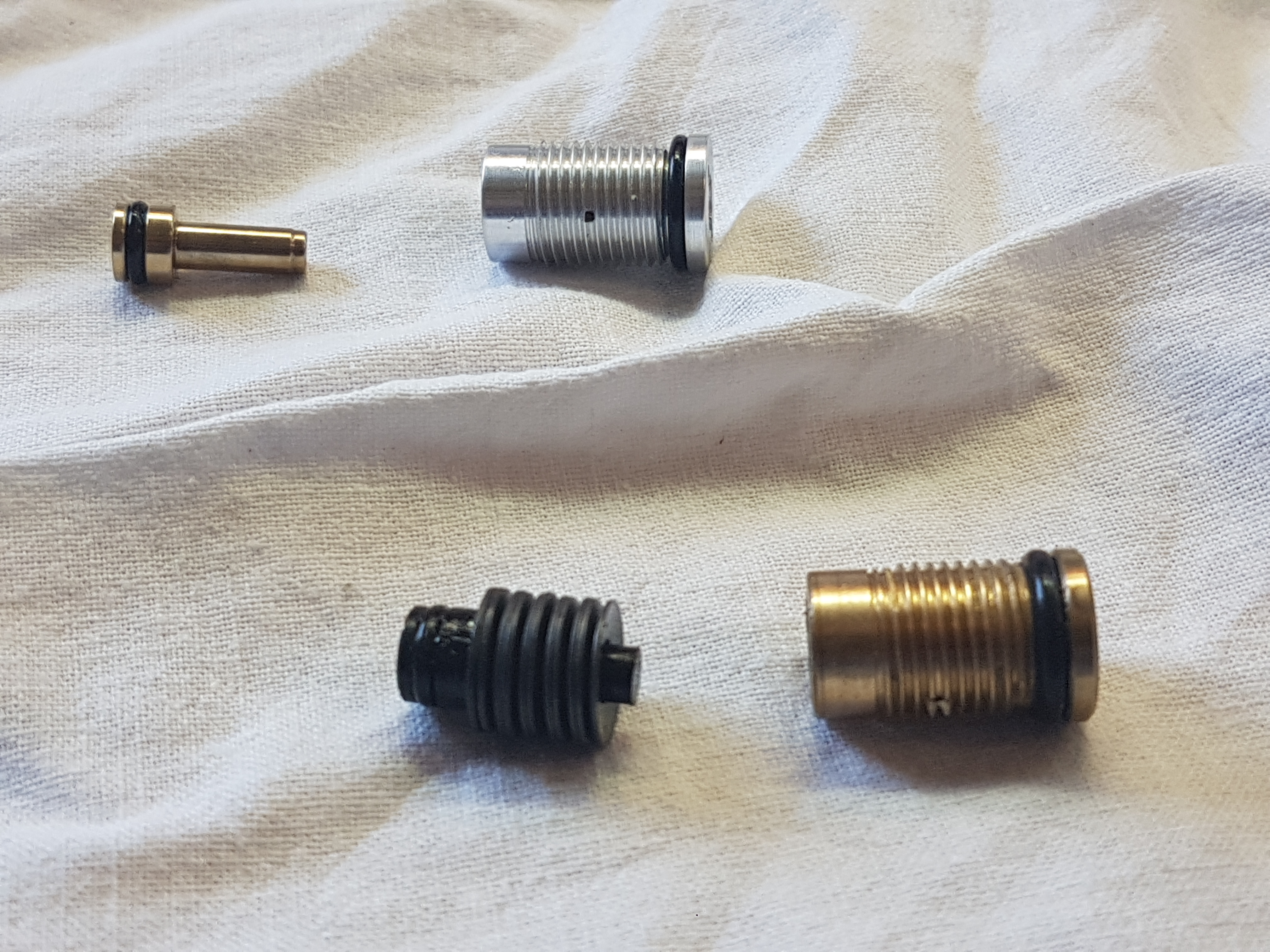

The image is the huma Gen. 3 (Brass piston) and the original gen. 3 Reg. (Closest with the black plastic piston)
I am sorry I haven't got a picture of the original Huma belleville spring stack.
I would compare the two stacks and use the amount of springs that gets closest to the total length of the original stacking.
