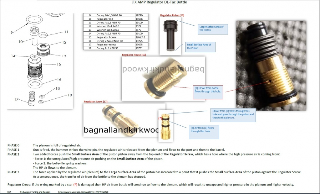

Well I do not have much knowledge off the huben, but the AMP reg and huma regs are almost identical. Regarding the piston, and seat, I would believe it is the same design as on 80-90 persentage off all other guns. Some might use other springs than the washers, but the washer design is very common. When I mentioned about comparing owners, I meant not you specifically, but all the thousands off other owners. The reg on a impact is easy to damage, if you screw it in the wrong way, or doeas not follow the right procedure. The more times you adjust it, the greater the chance it is that you forgot doing it the right way.

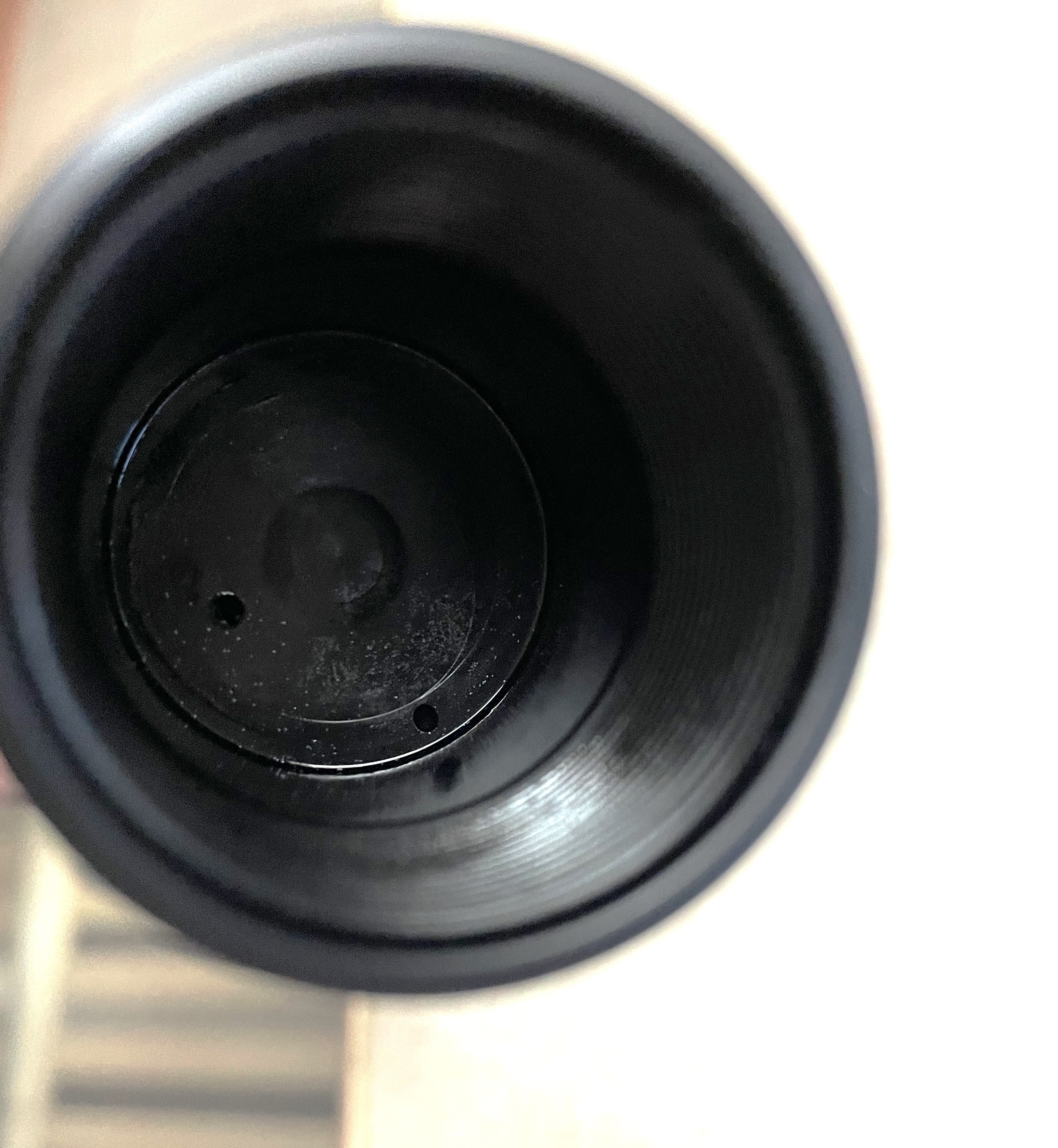

Last night I searched for a video or any information about how to remove this newer AMP reg from a dreamline. I removed the adjustment screw and cleaned it up with the microfiber sanding paper but it appears this also take a T35 (torx) on the outside of that?
I'm not sure if the regulator body is sideways in the tube or what.. as anyone ever show how to remove this newer reg on this rifle? I included a few pics..

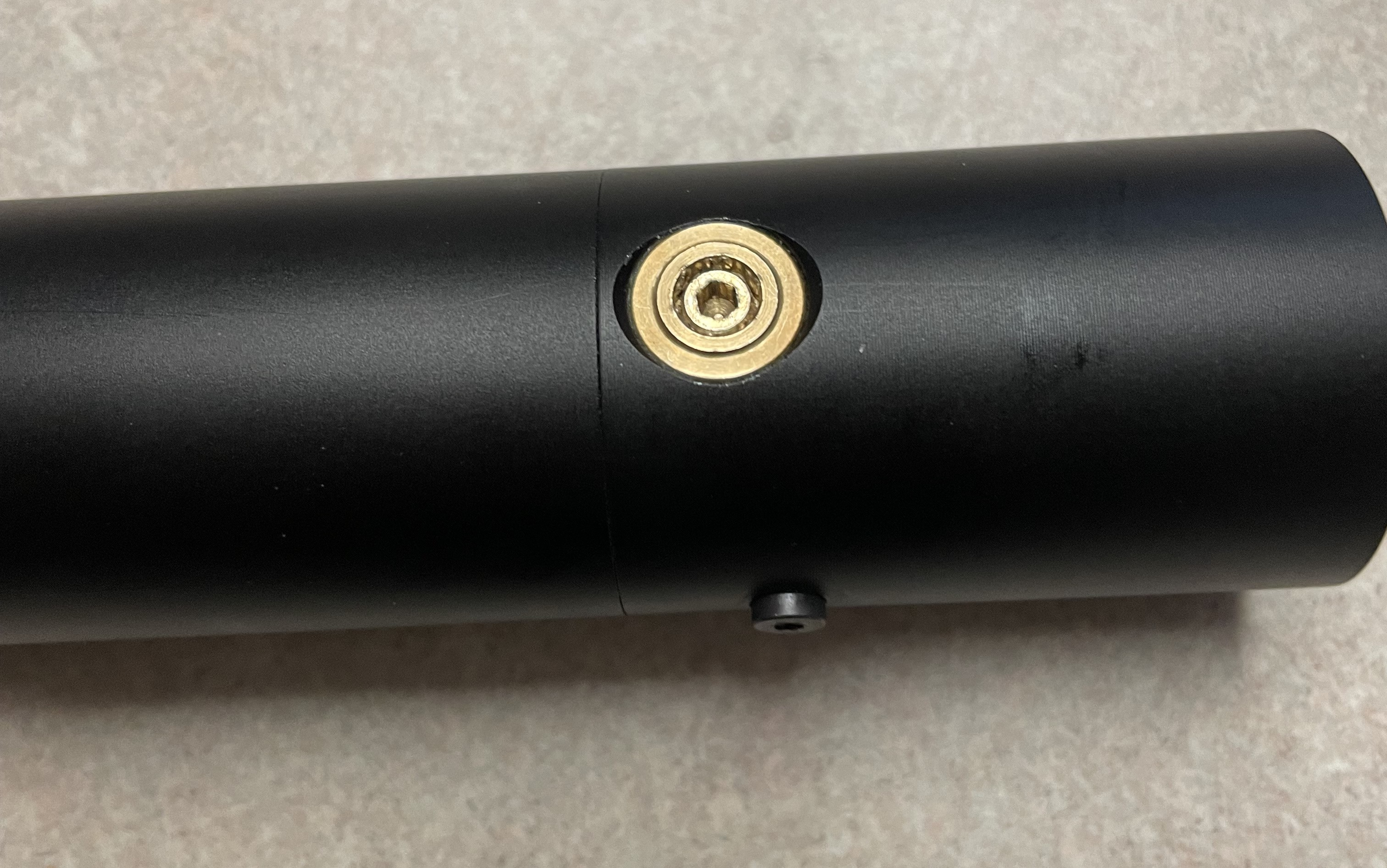

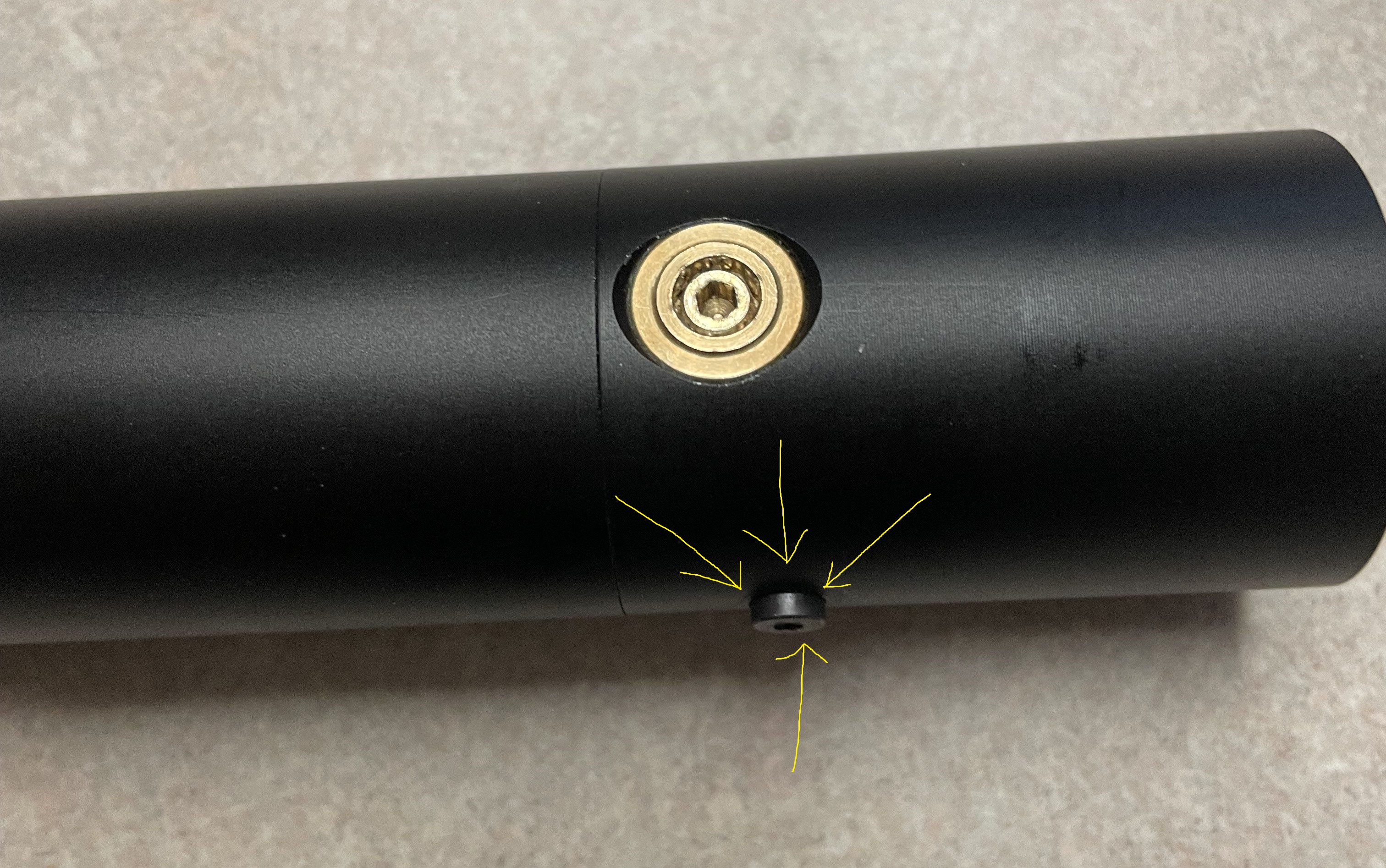

There is a dedicated screw on the body of the plenum on my Dreamline that is for de-gassing.
Looks like a torx bit . Just looking for the correct one. I think it's T35 And that's one of the one's I can't locate...
I just did 2 on my Maverick. After you remove the center adjustment screw you will see it takes a metric Allen , or mine did anyway. Pretty sure its 2.5 for the small center screw and 5mm for the larger reg body.

I actually just found out it was 5mm.. I was using a ball end 5mm and it dodn't want to work. Ended up using a 5mm I have that's on a tool with others that isn't a ball type end and got it out. I do have synthetic grease however I use it on PB's .. Not sure if that will work. I used to use moly graphite on these years ago and still likely have some around here.
