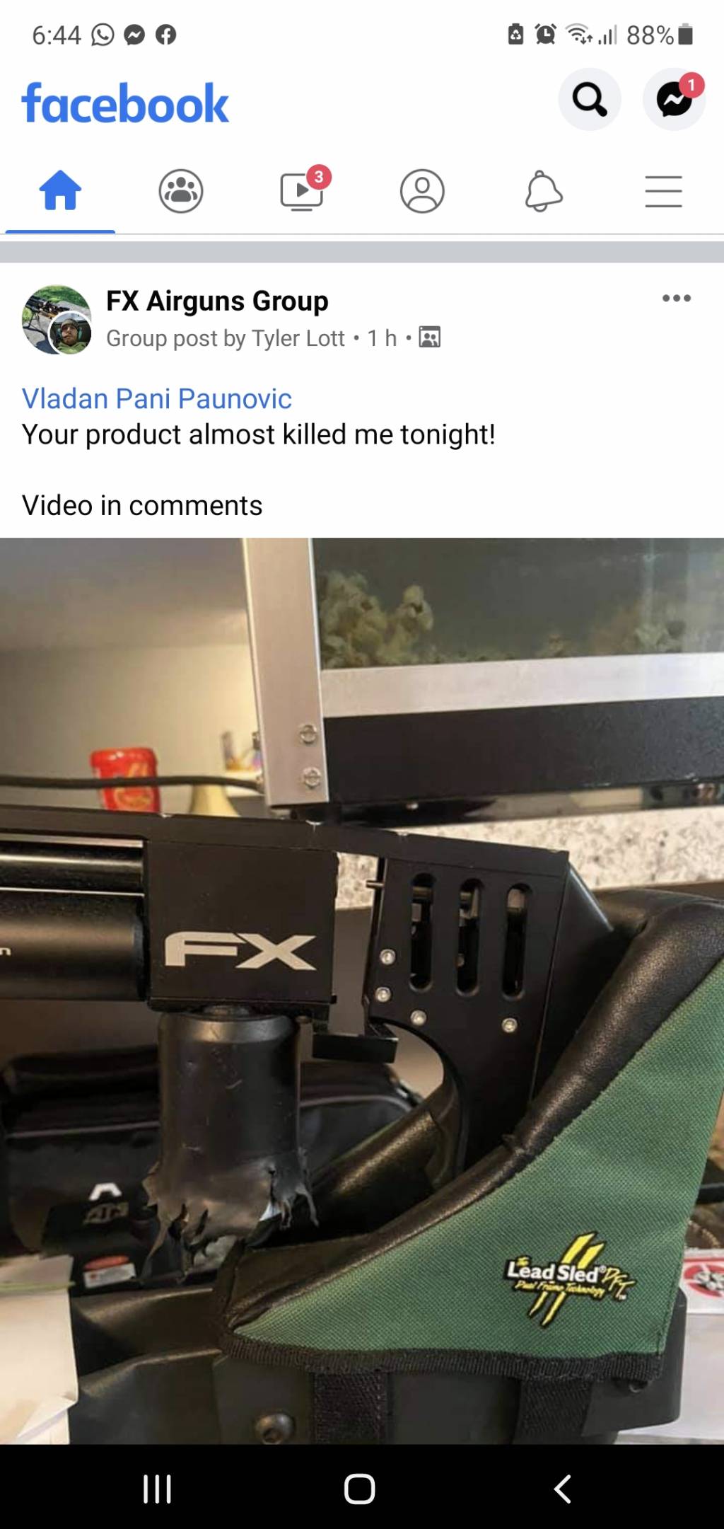

It happened with a product of a well-known tuner.

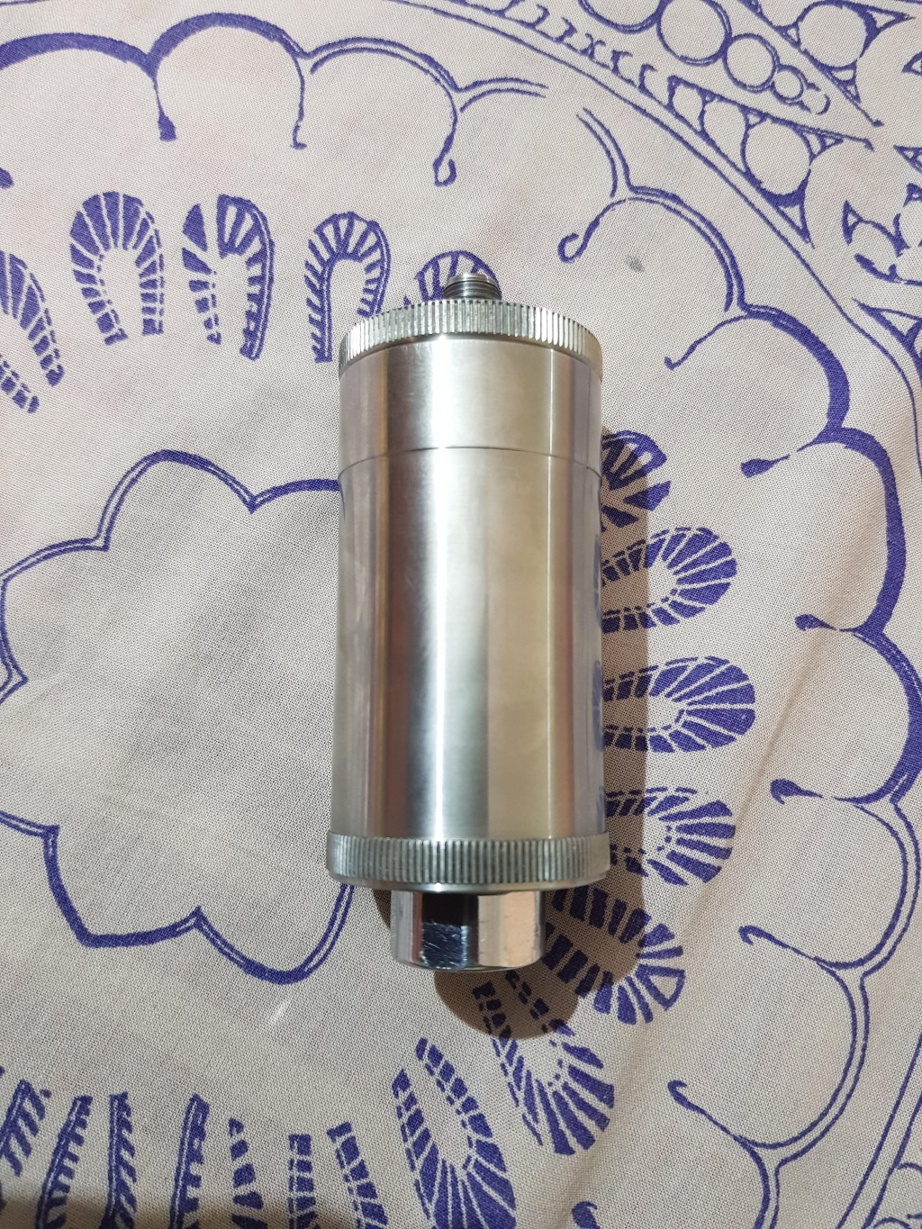

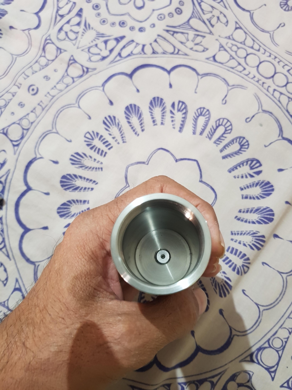

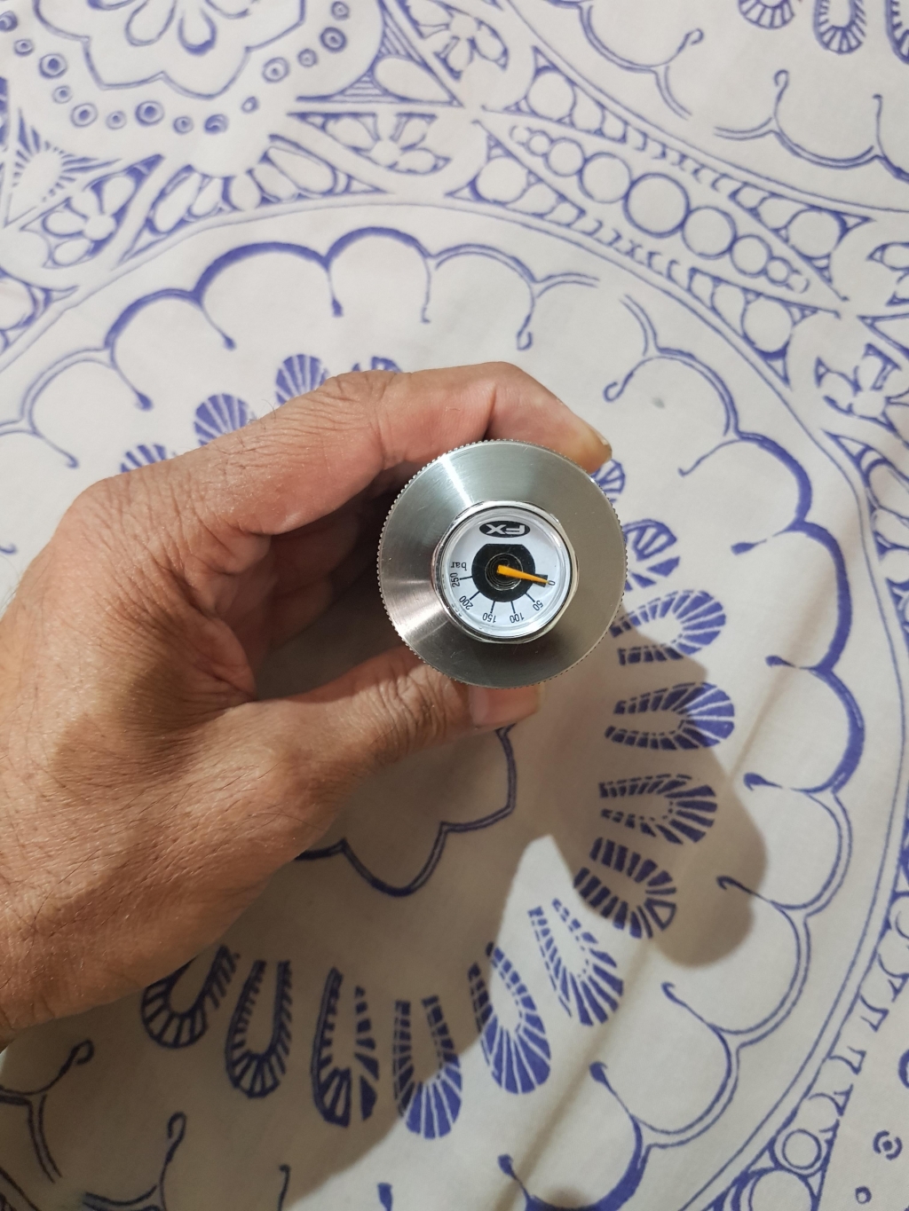

That is why I make plenums out of solid rod of high grade stainless steel only.
https://www.facebook.com/groups/fxairguns/permalink/1792425960930224/
This is very serious accident.

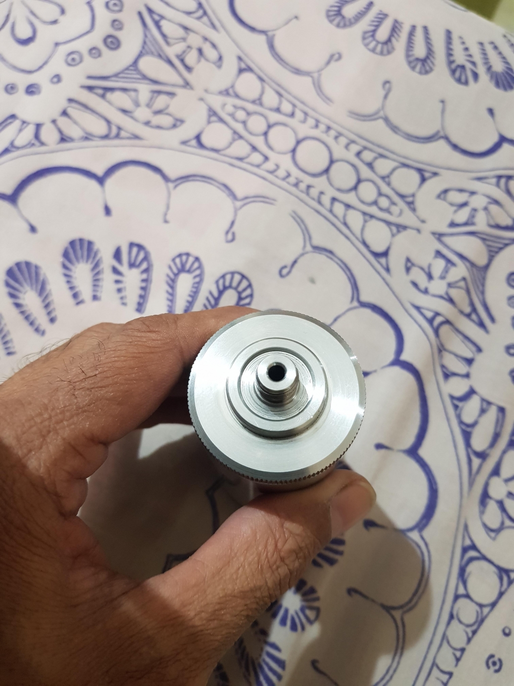

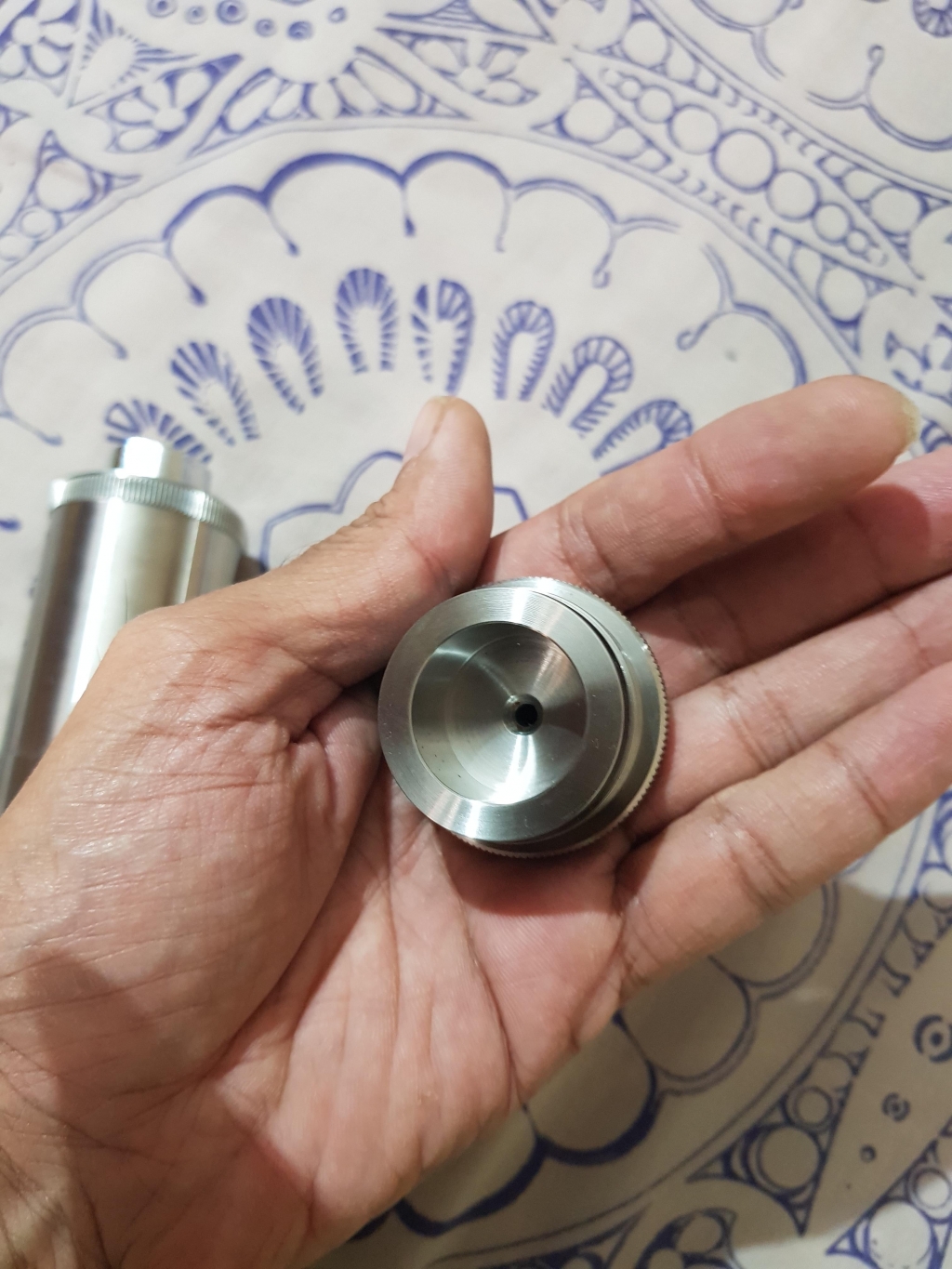

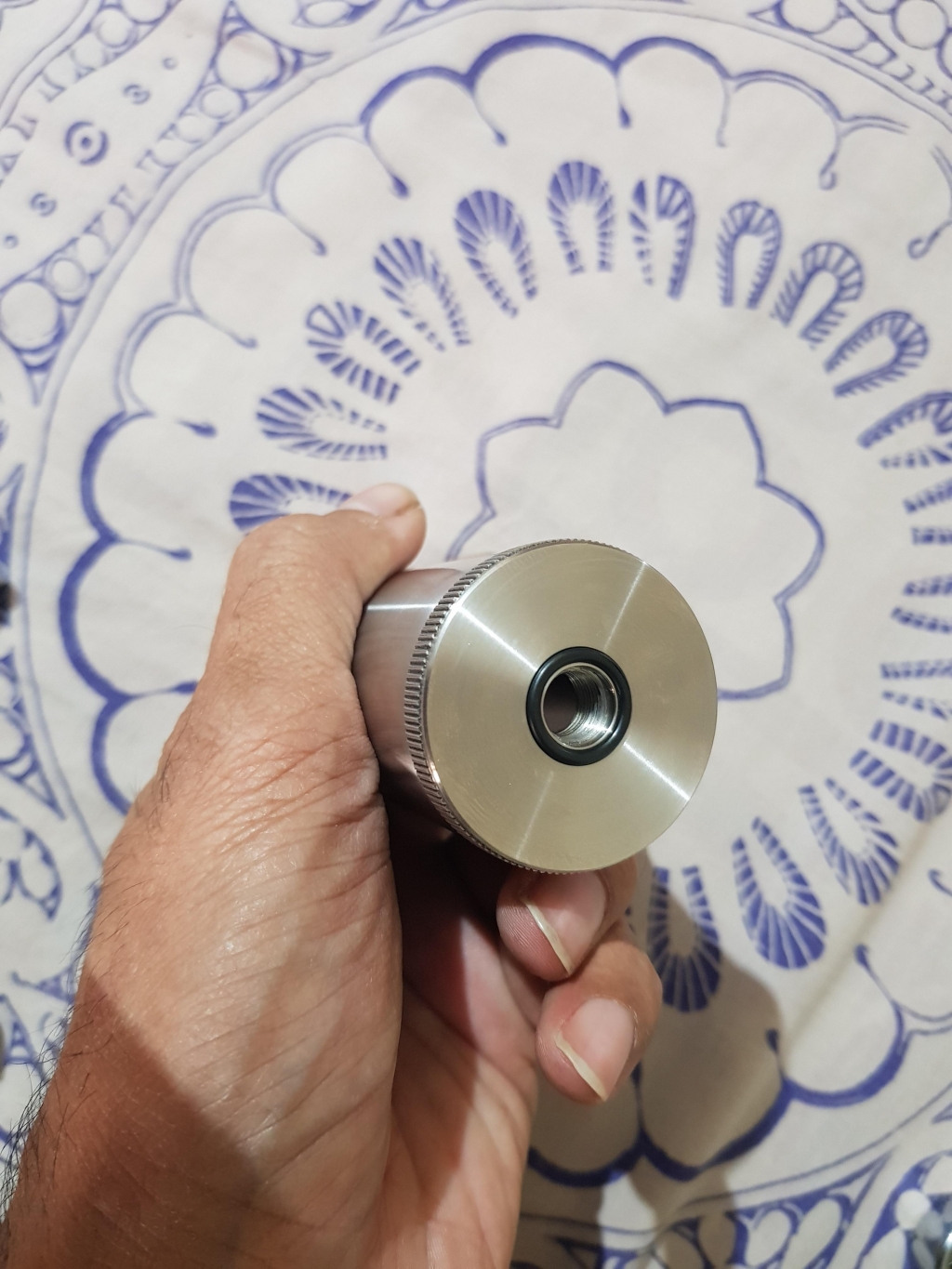

The difference in my plenum and the blasted plenum.

One thing at I see that having been a part of the industry that uses very high pressure cylinders, is seeing that many, if not most all of the "machined" aluminum cylinders in our PCP guns...have been machined with hard square corners. This is a BAD thing. Makes me cringe every time I...don't quite "fill" one of mine..!
If you look closely at the steel stamped numbers/letters on heavy steel cylinders, you'll notice that the stamps are much different than standard steel stamps. High pressure steel stamps have "rounded" edges, no sharp edges like a normal steel stamp..! Check that for yourself..!

The real point is not the material chosen, rather its the calculation that how much pressure the plenum can bear. This can be made of any good material and for the ability to withstand the pressure is the design and wall thickness of such cylinders keeping in mind the material used.
I keep the calculated pressure at 200% in order to make such things overbuilt. I prefer overbuilt items for such uses.
I hope I make clear my point.
Further it must be tested at the 200% pressure.

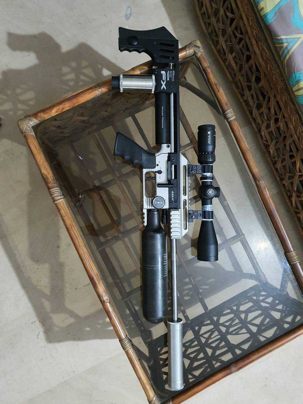

This looks like a commercial for your external plenum wich also can blow up in some cases. I think that Vlad sold big number of his plenums without of such accident luckily . Accidents can happen and it was big luck that nobody was seriously injured. With Impact M3 I don't see big need for external plenums.

Like a totally amateur I would like to see some round inner edges in plenums of that kind...
