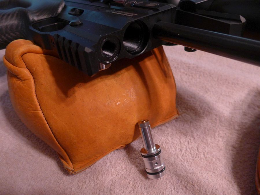

At any rate, yesterday was the one day we had that was fair and not blizzard like so I started to test the ZANs. I can't say for sure what the velocity was with the slugs at the factory reg. setting as I adjusted the reg. past the factory setting. Based on the guesses you folks shared with me, I decided to go +1/8-turn past the factory setting.
First shot showed velocity at about 545FPS!!! I fired a couple more to confirm that velocity and then assumed the rifle was in 'valve lock'. I turned the hammer in 2-turns and tested again. Velocity went up to an average of 1005FPS over 10-shots! 1005FPS was higher than what I was 'aiming' for but decided to fire a few groups to see how the Zans grouped. The slugs were grouping with no crazy flyers but overall group size not quite acceptable (for me anyway).
I'm looking for about 950FPS so another reg. adjustment is coming. I ran out of time yesterday so no conclusion out of this just yet. The Zan 38gr (.253") look like they have a chance of grouping well with the right velocity but still too early to say for sure.
