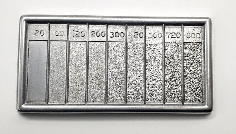

Most all projectiles I use have a relatively smooth surface. How rough does the surface need to be in order to see benefits?
Educated guess would say between 120-200 would be ideal. For larger objects like an intake runner on an engine I'd lean toward 300-420. Honestly, it's a hard concept to put into words. But look at some real world experiments on this, and you'll see the affect for sure. Almost like air or fluid sticks more to a smooth surface than it does to a bit rougher one. Not sure if this relates to a buffer zone created by the pockets or as @Ballisticboy said, that smooth airflow is easier disrupted and more prone to turbulence. Maybe its just just 2 sides of the same coin. Either way, the affect is real and is there.
