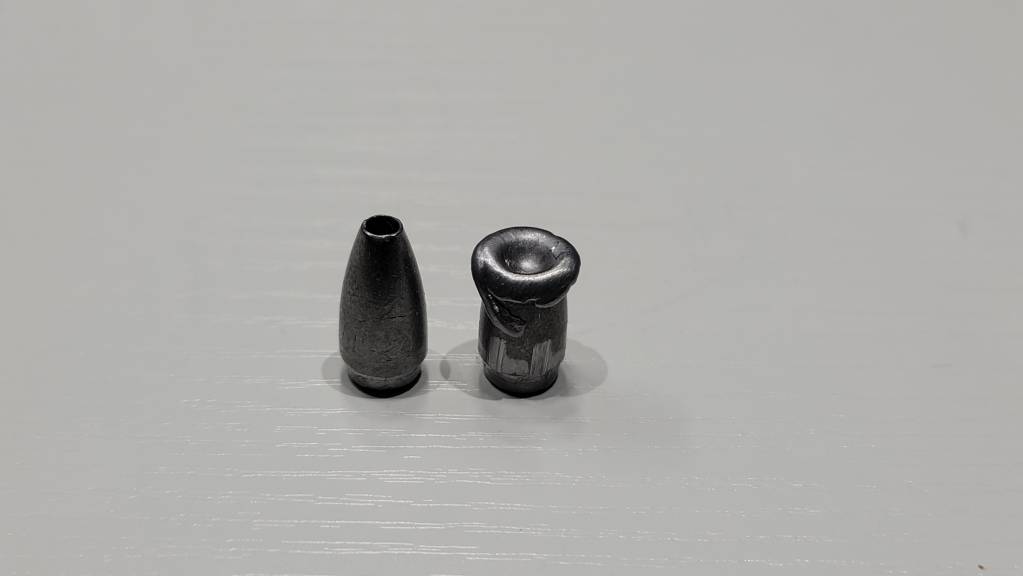

An experiment to get .22 cal NSA's to pop open easier. It works !!

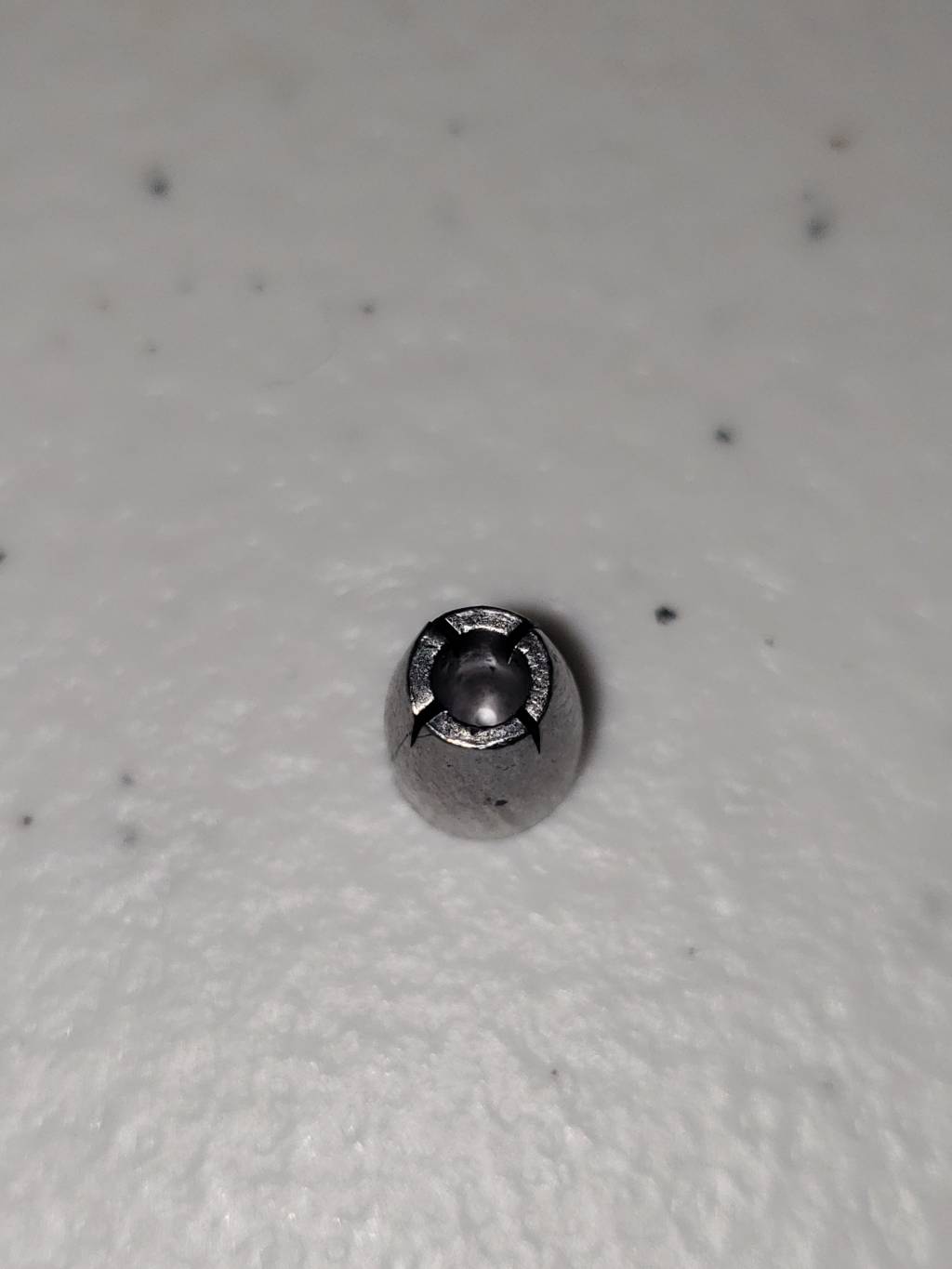

Using the "0" size jewelers phillips it has thinner edges already and far more symmetrical than a reground #2 tip and self centers far better as well.
Same Tap tap tap with the light hammer has the X being IMO very consistent with some practice.

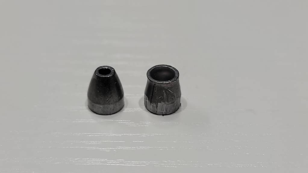

Todays test was using the .22 cal NSA in the 24.8 grain weight which has a known deeper HP pocket. still keeping the X inside the meplat.
Test again into a water jug @ 20 yards shot at @ 940fps. Unmodified slug passed right threw the jug. Modified opened up to .460" being over DOUBLE the caliber diameter ... Wowzer

Whoa!?!?!? That is pretty awesome. Have you tried 12.5 slug at low speed? I’m going to try that myself later. If works then it would knock the socks off of critters.
Not tried slower ... being this whole experiment was based around getting the small caliber NSA's to open up at all. Both my dedicated sluggers in .177 & .22 are very hard shooters as i use them.
I don't think the 12.5 has a deep enough HP cavity to really mushroom at velocities 800 or lower ? tho just a WAG .... try it and report back please.

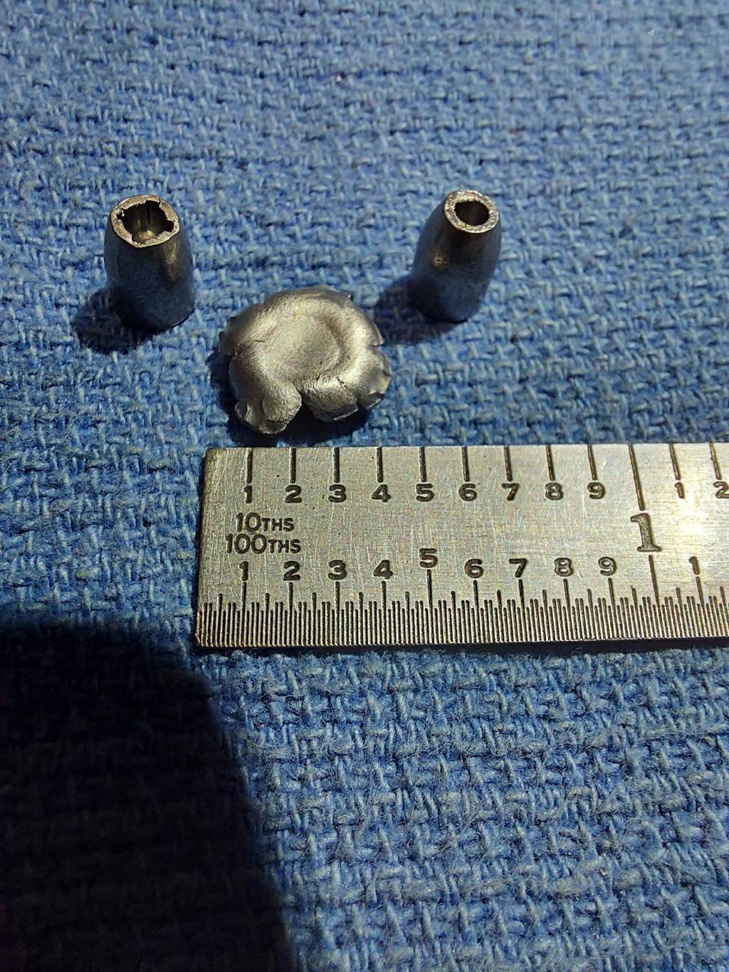

Follow up on this idea applied just yesterday for a pesting issue .... SKUNK !!!
Taking a 15 grain NSA in .177 cal did a heavy X with a OO phillips tip on 3 slugs. G dam skunk caught in the hava-a-hart and need to end it !
Generally I'll do heart / lung shots and let em ball up & expire and they don't generally spritz ... generally.
We're in a dry spell around here and know it it spritz's the stench is going to be here for weeks !! ... so I'm going to try a VERY PRECISION SHOT to get at the brain stem and see if A 100% Lights out / Switched off shot can be made ?
Distance @ 20 yards, take a shot into target box at same range, note POA / POI correction required and make note. On target ... make a few squeaks to get it looking right at me ... Place the shot above right facing eye and slug exits dead center back of neck at skull .... Dropped like a stone, only a few drips of red and not even a twitch and no stink !!!
That little .177 NSA HP-X at @ 1040 fps did a wicked job for sure !!
