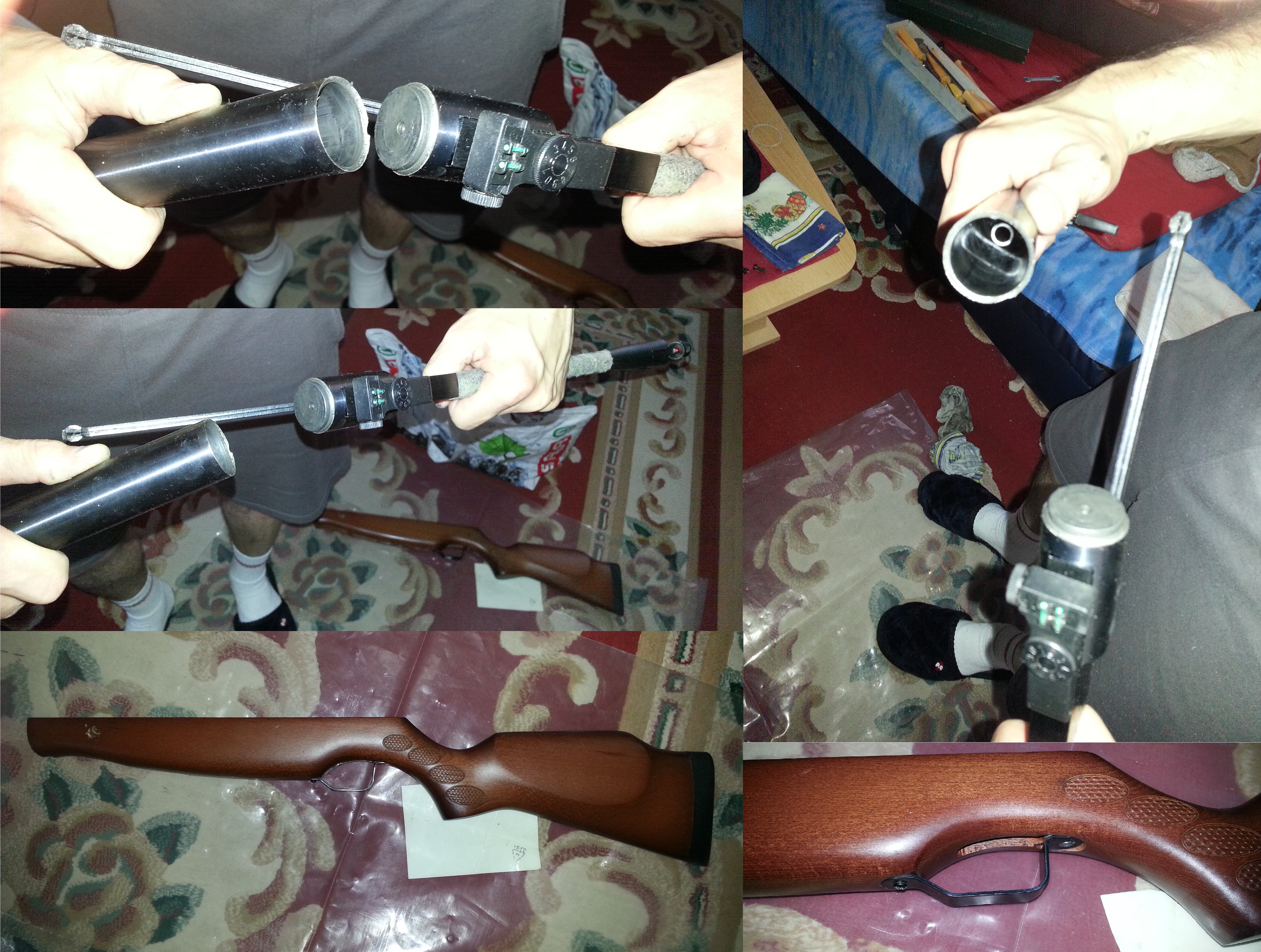

...And here are the photos of the ruined gun:
One interesting thing I was able to notice then, as I held the two pieces of the once whole receiver in my hands, is that the air-vent or port,
if you will, at the bottom of the compression chamber in the cylinder, was drilled sideways; As in from the bottom upwards,
into the line with the barrel. The reason airgun manufacturers do this, is because they don't want people to be able to convert break barrels
into .17/.22/8mm rimfire rifles. If you've got a hole sideways, then the converted piston (into bolt with a welded firing pin on it),
won't be able to push said firing pin through the hole in order to hit the primer of a cartridge, because the hole for
venting air is positioned sideways and is not straight, in line with the barrel - chamber in that case.
...And there you have it folks, the proof, that even break barrels can explode, just like real firearms. Now, if someone wants to send these images over to
the Cometa company, they are free to do so. I've already tried to sent images to them, but for some reason I couldn't get their mail to load properly and Google's mail seemingly also didn't deliver the mail, or perhaps they got the images, but were too chickenish to reply to me, because they somehow
knew they screwed up badly and that perhaps their products were defective.
