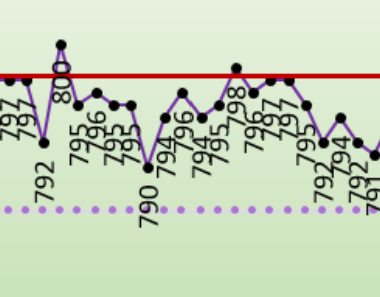

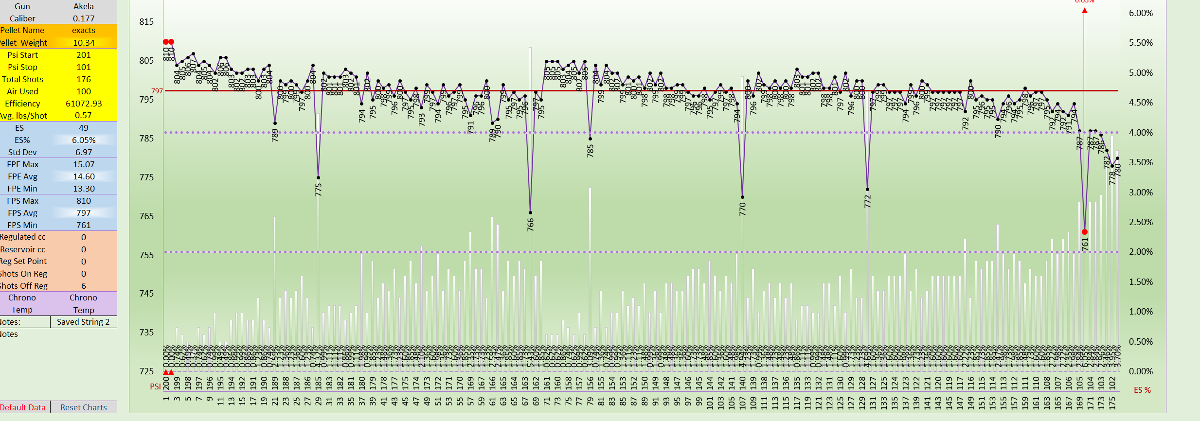

Here is the first shot string from my Lane reg. equipped .177 Akela. The hammer spring is cut down and the Lane is set to 95 bar. My original target fpe was 15. I really did not have a shot count in mind, but just wanted something more than 60. Using a cheap Amazon chrono but it does seem to work well. I shot maybe 60 shots, and adjusted the hammer spring to 1.25 turns in. I then shot the attached 175 shot string. I am happy with the results, but it can't be optimized unless I really lucked out.
Like an idiot, I tore the Akela apart to work on it before I fired a shot, so I have nothing to compare.
Any thoughts about the string would be appreciated, as this is my first time.
Also, I am not sure what caused the 5 or 6 low, single shot fps dips. Maybe deformed pellets, maybe a cheap chrono, maybe me resetting the chrono because it only holds about 35 shots?????
Is there a next step from a tuning perspective, or just go and shoot it? I did have fun using Sub12's video as a guide!
